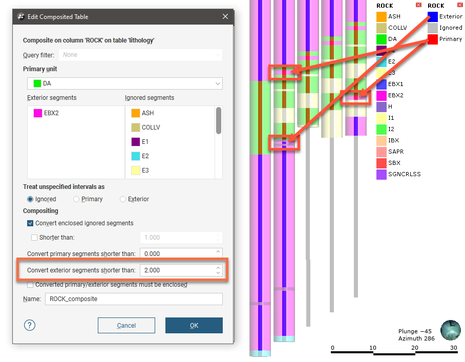

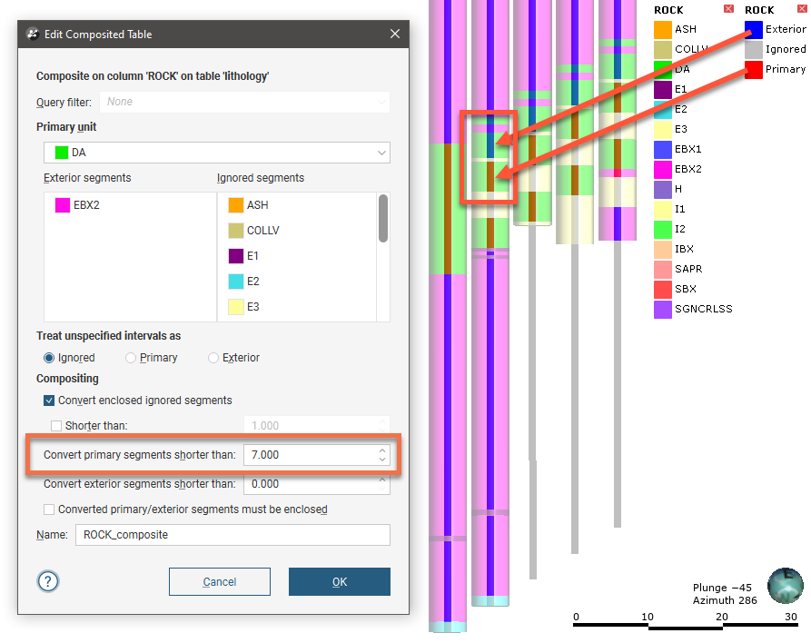

When Convert primary segments shorter than is set to a value, short primary segments adjacent to at least one exterior segment will be converted to an exterior segment.
When Convert exterior segments shorter than is set to a value, short exterior segments adjacent to at least one primary segment will be converted to an exterior segment. If the exterior segment does not have at least one adjacent primary segment, because it is enclosed by ignored segments, then it will not be converted to an exterior segment, even if the length of the segment is shorter than the specified length.

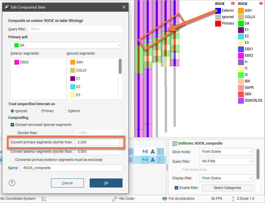

To see how these parameters can smooth the shape of a unit of interest, let’s look at a series of wells where we wish to create an intrusion boundary based on the red segments. Short segments are highlighted in the intervals that have not been composited:
