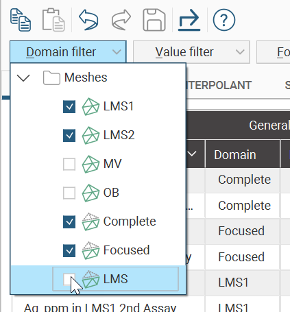

Use the Domain filter to filter the table to only the required set of domains. Each of the domains used in the domained estimations can be selected or deselected to create any combination that is needed.

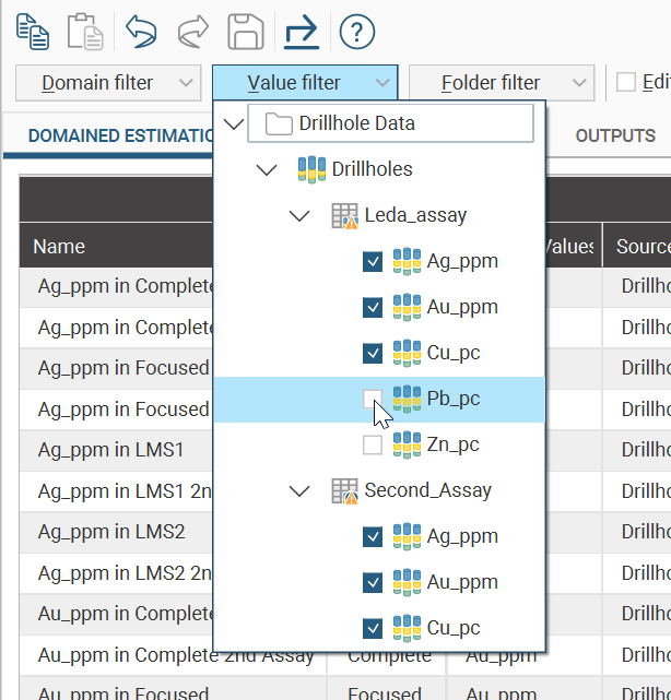

Use the Value filter to filter the table to only the desired variable values. Each of the variable values used in the domained estimations can be selected or deselected to create any combination that is needed. The variables are organised by table, so it is easy to distinguish between identical variable names in different tables.

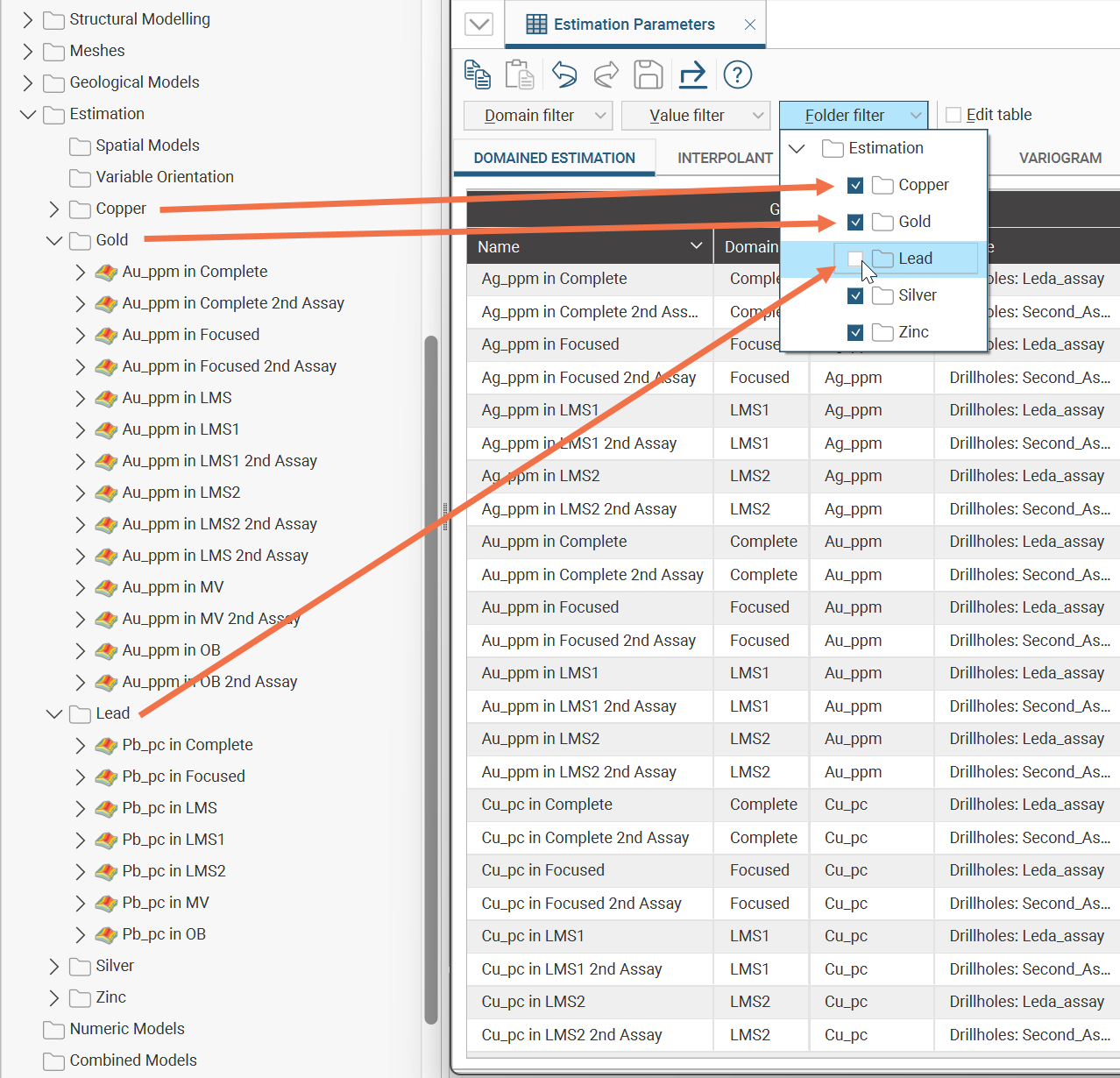

Use the Folder filter to select only the estimators within selected subfolders. You can create arbitrary subfolders under the Estimation folder in the project tree to organise estimators in a logical or strategic manner. Each subfolder will appear in the Folder filter list.

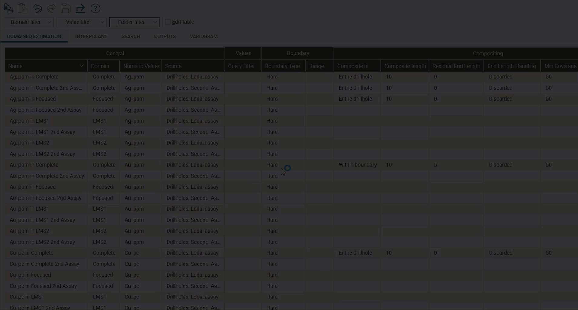

Click any of the column headers to sort the current table by that column. The column that is currently being used as the sort column is marked with a chevron that also indicates the sort order. Clicking this chevron will invert the sort order. If the chevron looks like a caret the current sort order is descending and clicking the chevron will change the order to ascending. If the chevron looks like a v, the current sort order is ascending and a click will change it to descending.

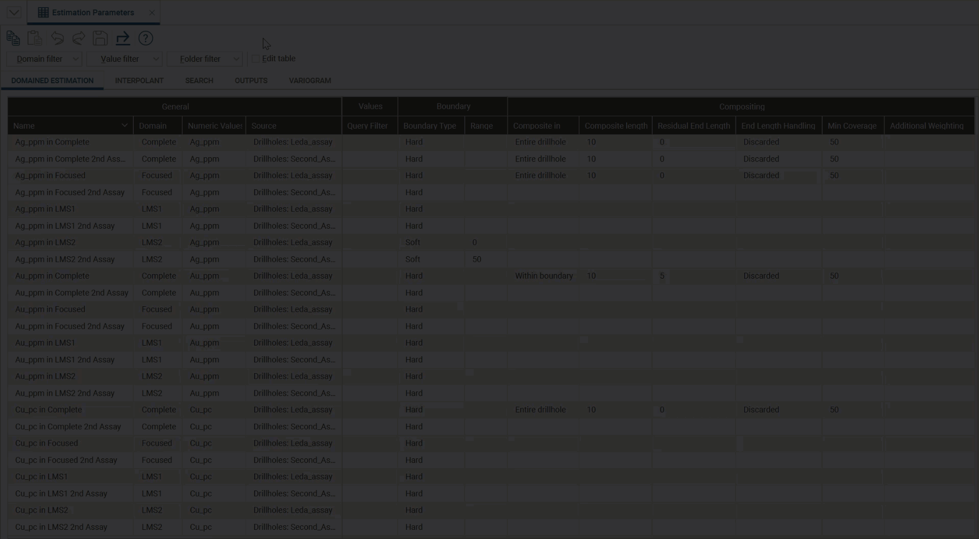

The Parameters Report also makes it easy to modify values by creating a shortcut to the window where the value can be adjusted. Double-click on any cell in the table and the associated dialog window will open.
If Edit table is ticked, some parameters can also be edited in place directly in the table. Cells that can be edited will have a thin black box border around them when the mouse pointer is moved over the cell.
To make changes to an editable cell:
- If the field has discrete options to select between, click once in the cell and the options will be presented for selection
- If the field is textual or numeric, double-click in the cell to enter editing mode
Cells that have been edited will be highlighted in yellow until the save button is clicked or changes are discarded.
If processing is causing any cells to be updated, they will appear in grey text in the table. If an error is causing values to be invalid, the cell contents will be red.
