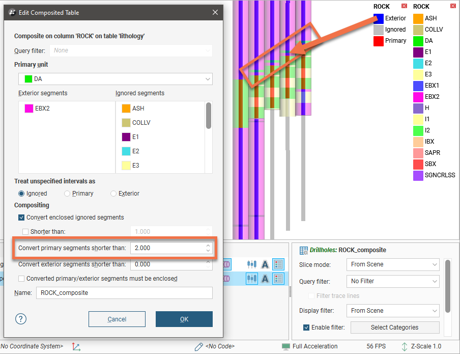

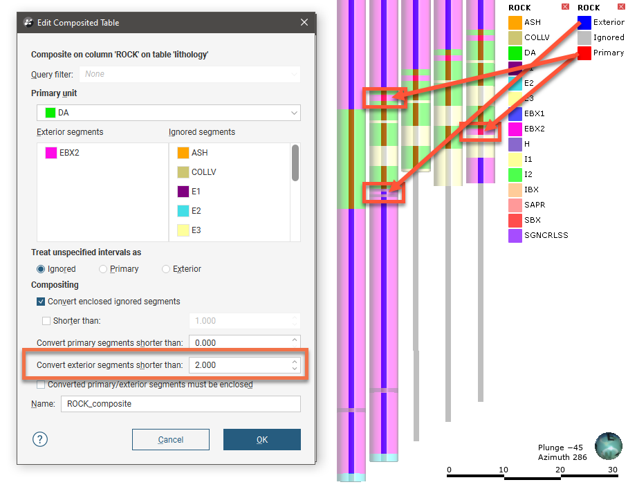

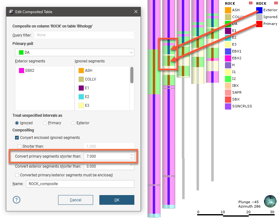

When Convert primary segments shorter than is set to a value, short primary segments adjacent to at least one exterior segment will be converted to a primary segment.
The Converted primary/exterior segments must be enclosed setting is useful for situations where a primary or exterior segment is bounded on only one side by another segment type. For example, here we have original drilling (in blue, green and red) shown inside composited drillholes. There are eight composited drillholes (highlighted) where exterior segments have been converted into primary segments, despite only being bounded by the primary lithology on from above:
To see how these parameters can smooth the shape of a unit of interest, let’s look at a series of wells where we wish to create an intrusion boundary based on the red segments. Short segments are highlighted in the intervals that have not been composited:
