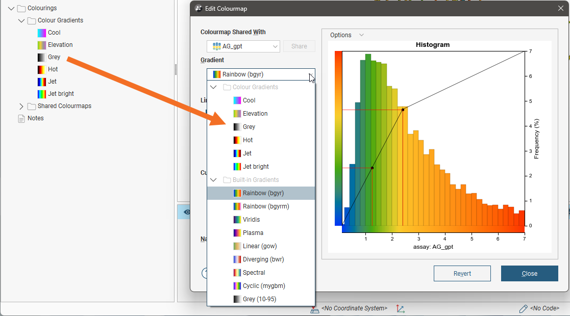

In the project tree, imported colour gradients are stored in the Colouring > Colour Gradients folder. Built-in colour gradients are not listed in the project tree.

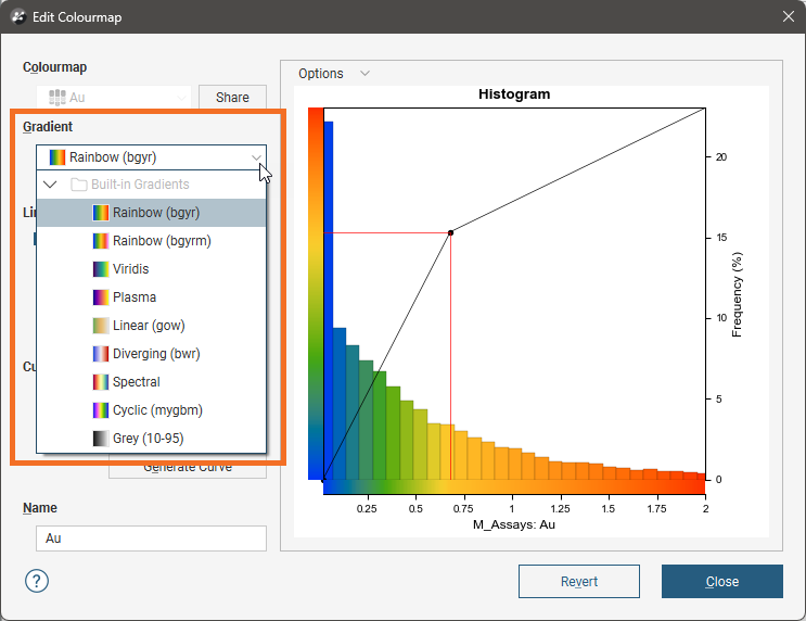

Leapfrog Energy contains a number of built-in colour gradients that are used in displaying both continuous and discrete numeric colourmaps. Here in the Edit Colourmap window, you can see the list of Built-in Gradients available:
These colour gradients are:
  • Rainbow (bgyr). This is a perceptually uniform rainbow.
  • Rainbow (bgyrm). This is similar to Rainbow (bgyr), but follows red with magenta, which is common in geophysics software and RQD (geotech).
  • Viridis. This is a good linear gradient.
  • Plasma. This is the default colourmap for face dip.
  • Linear (gow). This gradient is useful for elevation data.
  • Diverging (bwr). This colourmap can be used when you are interested in data at either end of the spectrum.
  • Spectral. With this colourmap, the middle is not white, and white is reserved for bins that have no data.
  • Cyclic (mygbm). This is a good colourmap for azimuth data. Northern directions are displayed in blue and southern in yellow.
  • Grey (10-95). This grey colourmap works well on white and black backgrounds as it doesn’t start or end in white or black.

To import a colour gradient right-click on the Colourings > Colour Gradients folder and select Import Gradient. In the window that appears, navigate to the folder containing the gradient file and click Open. The gradient will be added to the Colour Gradients folder and you can then select it from the Gradient list when editing a colourmap:

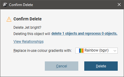

If you delete a colour gradient from the Colour Gradients folder and it is in use in the project, you will need to select a replacement gradient for all colourmaps that use that gradient. Select the replacement colour gradient from those available in the project:
