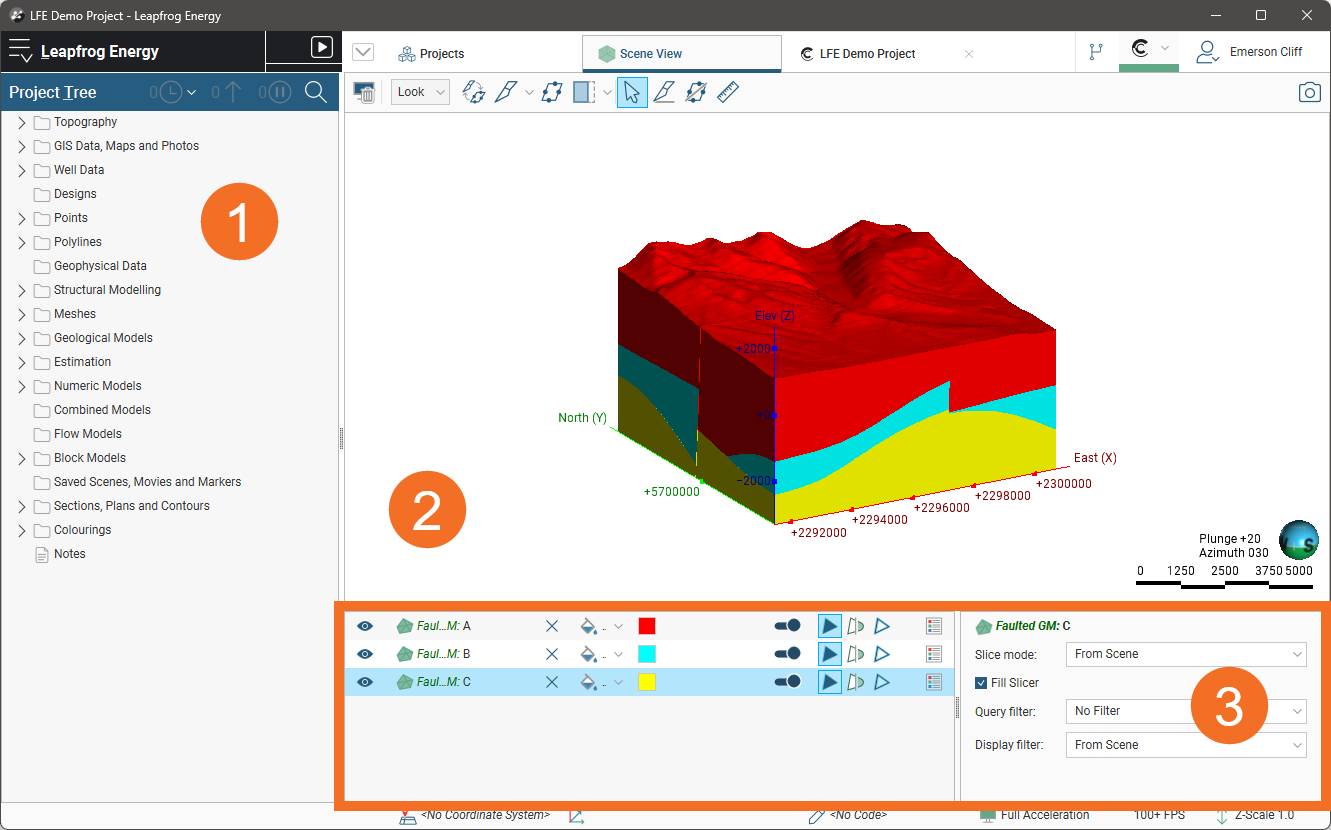

This topic provides an overview of the different parts of the Leapfrog Energy window, which is divided into three main parts:
The Project Tree contains all the data in the project and tools for working with that data. When you want to change how this data is used in the project, work with the objects in the project tree. See The Project Tree. |
The Scene View tab displays a 3D representation of selected objects from the project tree. Changing how you view objects in the scene window does not change those objects in the project tree. See The 3D Scene. |
Tools for changing the appearance of data in the scene window are available in the shape list and the shape properties panel. The shape list shows all objects that are currently in the scene; clicking on an object in the shape list shows more information about it in the properties panel. Changing the appearance of these objects does not change those objects in the project tree. See the Visualising Data topic. |
You can add objects to the scene window by dragging them from the project tree. You can temporarily hide them in the scene or remove them altogether using the controls in the shape list.
