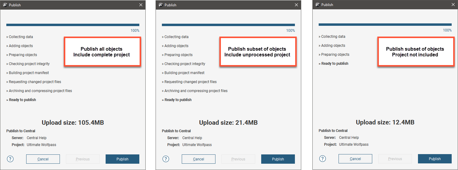

Another consideration in choosing when to publish is how large the publishing upload will be, as publishing many objects and/or including the Leapfrog Energy project can result in a large upload that takes some time. Here, for example, are three upload summaries for the same project. The first upload includes all objects, plus the full project, the second includes a limited set of objects and an unprocessed version of the project, and the third upload is only a limited a set of objects:

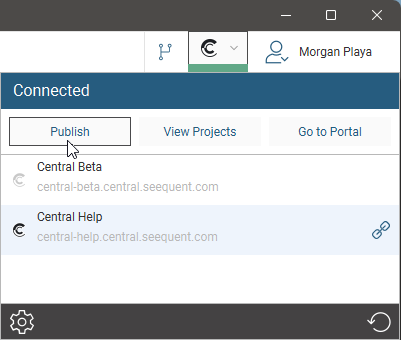

Initiating a Publish Event
When you are ready to publish your revision to Central, you can start the publishing process by clicking on the Central button in the top right-hand corner of the screen and selecting Publish:

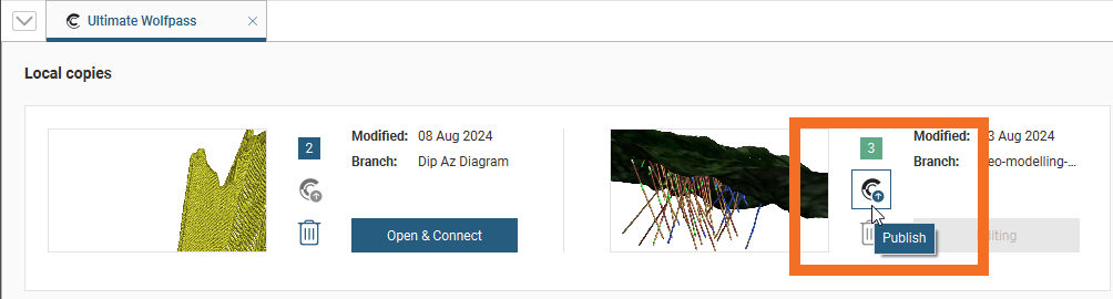

You can also use the Publish button (
) in the Local copies panel:
Leapfrog Energy will then step you through the different options, which are described in the sections that follow.

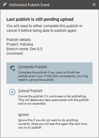

When you click Publish, you may receive a message saying there is an unfinished publish event:
This occurs when a previous publish event was interrupted. Choose from the options presented.
If the publish event was abandoned, it can be removed via the Central Portal.

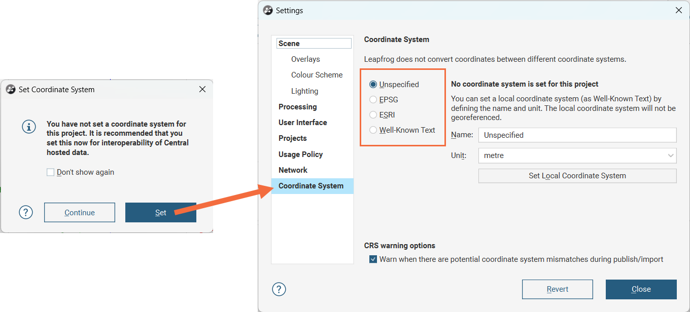

Setting a Coordinate System
If a coordinate system has not been set for the project, you will be prompted to set one when you initiate a publish event. Click the Set button to open the Settings window where you can set a coordinate system:
See Coordinate System Settings for more information.

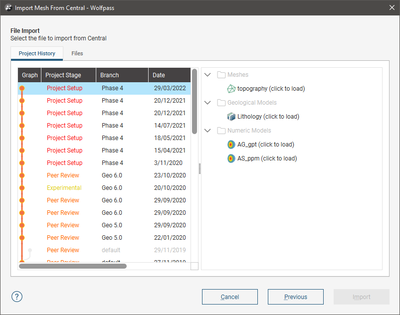

In the Central Portal, it will be possible to visualise the Topography mesh, the surfaces in the Lithology geological model and the surfaces in the AG_gpt and AS_ppm numeric models from the Wolfpass project:
Unticked objects such as the Distance to collar mesh, the topography inside Distance to collar mesh, the Lithology on 9/10/2020 geological model and the AU_gpt numeric model will not be available.

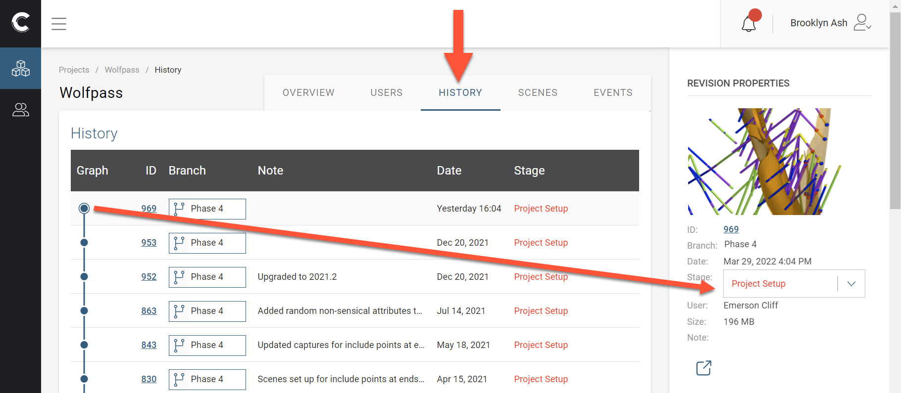

If you set the wrong project stage, you can change it later in the Central Portal, once the publish is complete. To do this, click on the project’s History tab, then click on the node for the revision you need to update:

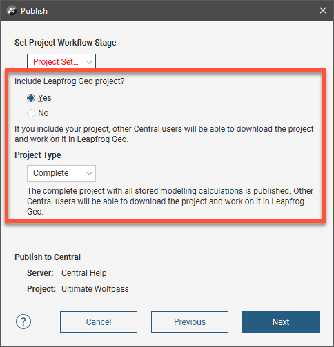

Including the Project
Whether or not you include the Leapfrog Energy project along with the publish event depends on many factors, including whether it’s time to back up your work and whether or not other members of your team will need to work on the project in Leapfrog Energy.
First choose whether or not to include the project. If you choose not to, the Leapfrog Energy project will not be published and other Central users will not be able to download the project and work on it in Leapfrog Energy. They will, however, be able to visualise and review the published objects and their history in the Central Portal.
If you are including the project, there are two options:
- Complete.This option publishes the complete Leapfrog Energy project, including stored modelling calculations. Other Central users will be able to download the project and work on it in Leapfrog Energy without reprocessing the project.
- Unprocessed. An unprocessed project has a smaller upload/download size because stored modelling calculations are removed. When an unprocessed project is downloaded again, all of the modelling calculations will need to be reprocessed from the underlying data. Other Central users will be able to download the project and work on it in Leapfrog Energy. Depending on the size of the project, reprocessing may take some time.

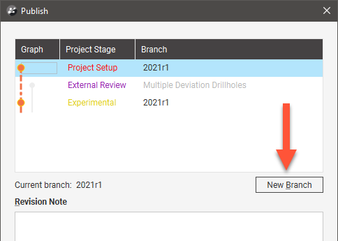

Branching
With branching, you can split your Leapfrog Energy modelling tasks into multiple timelines that co-exist in the same Central project. Branching is useful for:
- Splitting a large modelling project into smaller subsets based on domain or area
- Separating modelling tasks by specialisation, e.g. lithology, resource, structure
- Separating branches for modelling at differing scales
Once you branch from a timeline, you cannot merge back into it. There’s no reason, however, that you can’t keep working in a branch and start considering that the main branch, if that’s the conclusion you and your team reach.
Branches are created in Leapfrog Energy as part of the publishing process:
Branches cannot be created in the Central Portal, although they can be renamed.

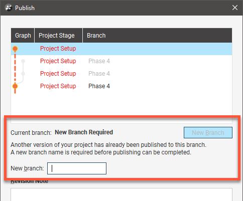

If the revision you have been working in is the most recent on that branch, you can publish to that branch. However, you cannot publish to a different branch, even if your revision is more recent than the revisions on that other branch.
If, however, there is a more recent revision on the current branch, you will receive a message saying you need to publish to a new branch:
Most likely, this has occurred because another team member has download a copy of the project and published a revision to Central. If you wish to prevent other Leapfrog Energy users from publishing to that branch while you work on it, you can lock the branch, as described in Locking Branches in the Central Projects topic.

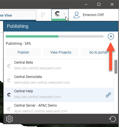

Preparing and Uploading the Package
Once you set the various options for the publish event, Leapfrog Energy will prepare the package. Disable the Auto upload option if you wish to review the summary before starting the upload. This gives you the option of cancelling the upload before it starts. Otherwise, the upload will begin automatically once all the information has been packaged.
If for some reason you need to stop the upload, click on the Central dropdown menu and click the cancel button (
You can resume the upload by clicking Publish in dropdown menu.
If the upload is interrupted because the connection to the server is lost, you will be prompted to finish the publish event the next time you log in to Central.
If you exit Leapfrog Energy while a publish event is in progress, you will be warned that a publish event is in progress. You can:
- Cancel exiting Leapfrog Energy, in which case the publish event will continue.
- Confirm that you wish to exit Leapfrog Energy. The next time you connect to this Central server or publish from this project or from another project on the same server, you will be prompted to the resume the interrupted publish event. You can complete the interrupted publish event, if you wish, or ignore it.
