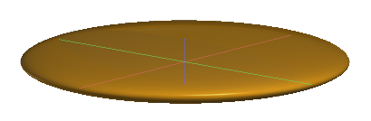

The global trend is expressed in the form of ratios in three orthogonal directions, described as the major (“maximum”), semi-major (“intermediate”) and minor (“minimum”) axes of an ellipsoid. When the same value is used for each axis, the ellipsoid is spherical and the global trend is isotropic. Reducing the ratio in the minor axis direction relative to the major and semi-major axes produces an oblate discus-shaped anisotropic trend that de-emphasises the minor axis direction.
This sort of global trend is typical for modelling structures that have undergone compression.

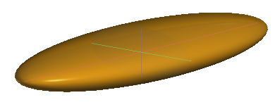

Increasing the ratio value in the major axis direction, while having a lower ratio for the semi-major axis and smaller still for the minor axis further emphasises the trend in the maximum direction.
This sort of global trend is typical for modelling structures formed from flows. When the geology is modelled, the maximum direction of the trend is favoured over the other directions, and the minimum direction is de-emphasised.

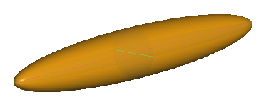

When the semi-major and minor axes have the same value and the major axis is larger, this emphasises the trend in only in the maximum direction. This results in a prolate cigar-shaped anisotropic trend.
