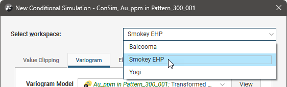

Right-click on the Estimators folder in the domained estimation and select New Conditional Simulation.
Choose a Seequent Evo workspace from the Select workspace dropdown list.
Conditional simulation is not supported by combined estimators.

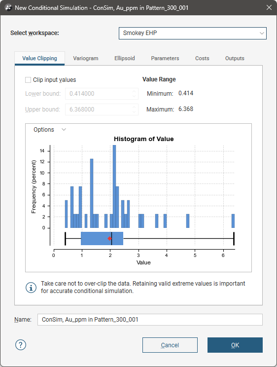

Value Clipping
Use the Value Clipping tab to constrain the data values used in the dataset, discarding outliers. In most cases it should not be necessary to clip values.
Not overclipping data is important for accurate conditional simulation as extreme valid values are relevant to the simulation. Correct statistical reproduction of high grade values is of critical importance. Instead of clipping off outliers, all the data should be retained unless there are sound reasons for clipping input values.

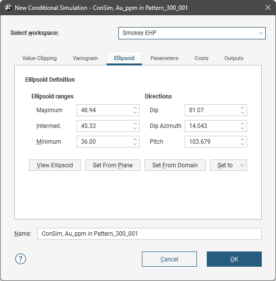

Ellipsoid
The Ellipsoid tab defines the primary anisotropic search volume size and orientation. Neighbourhood samples will be selected from within this search volume.

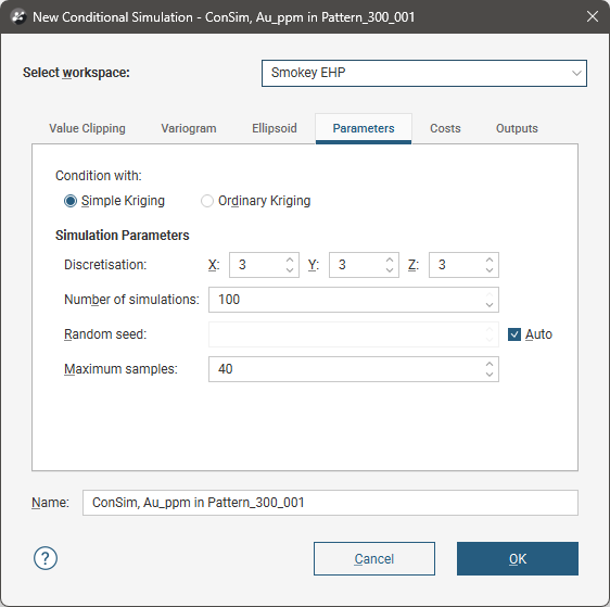

Parameters
The Parameters tab contains additional parameters relevant to the conditional simulation.
Two options are provided to Condition with: Simple Kriging and Ordinary Kriging.
Simple Kriging is the default option, and should be the preferred selection. Conditional simulation is a global method that makes a strong assumption of stationarity. Simple Kriging requires a similarly strong assumption. Simple Kriging calculates weights for local samples based on the variogram, and also includes a term for the weight given to the mean. As the relevance of local samples decreases and as the samples become less correlated to the target, the weight attached to the mean correspondingly increases. As a result, simulated grades revert towards the mean away from sampling. Beyond the range of influence of the variogram, simulations revert to non-conditional with an expected value that is the declustered mean of the dataset.
Ordinary Kriging is provided as an option in case locally precise results are preferred despite higher variability and the risk of potential bias. The mean reverting behaviour of simple Kriging may contradict the expected behaviour of grades in the real world, and the results can be visually jarring. When this is the case, it may be preferable to condition simulations with ordinary Kriging, which assumes that the neighbourhood samples inform the local mean adequately. However, the reproduction of the variogram may be distorted, as the simulated grades will incorporate trend, which can artificially inflate spatial variance. A simulation conditioned by ordinary Kriging will revert to non-conditional when no samples are found inside the search ellipsoid. When using ordinary Kriging, use a search that is large enough to ensure that peripheral blocks still find a sufficient number of neighbours.
Simple Kriging should be preferred over ordinary Kriging as ordinary Kriging can lead to higher variability and potential bias.
When assessing variogram reproduction, focus on the reproduction at ranges shorter than the variogram range.
Discretisation sets the number of discretisation points in the X, Y and Z directions. To take account of block support, each block is broken down (discretised) using a point grid for each block for simulation, before averaging point values back up to the block scale. When specifying a discretisation grid, there should be sufficient nodes per block to produce a reliable estimate of the average grade in the block per realisation.
The point grid is a transient data object and is not preserved. The simulated values for each point are not retained.
Set the X, Y and Z parameters to 1 for no discretisation, with a single centroid point per block.
Choose the Number of simulations to be generated. The maximum of 100 is also the default option.

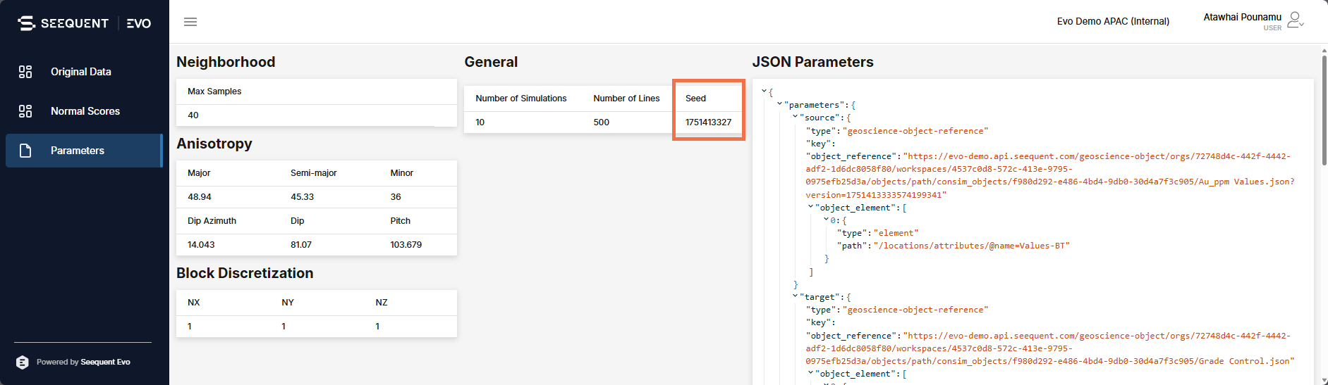

You can specify a Random seed value to be used by the pseudo-random number generator used in the simulation. If you leave the Auto box ticked, each time the simulation is run, different values will be created by the pseudo-random number generator and the simulations will exhibit effectively random variations between simulations. However, if you need reliably repeatable results across simulation executions, this can be forced by specifying a fixed Random seed value.
If you need to repeat a simulation that has already been run using an Auto random seed, look in the validation report to find the seed that was used and enter that seed value into Random seed for subsequent executions.
The Maximum samples threshold limits the number of samples used in a search neighbourhood. The maximum number of samples used in a neighbourhood is the sole parameter exposed for operational control that is associated with the Turning Bands algorithm. When compared with the Sequential Gaussian Simulation method, Turning Bands is less sensitive to the neighbourhood, i.e. to the number of initial samples included in the search relative to the number of previously simulated nodes. What is being estimated with Turning Bands during the conditioning step are the residuals between the actual data at sample locations and the simulated values at sample locations.
The default value has been selected to be a reasonable value to use in most cases. As a general principle, variogram models with low continuity can be conditioned with a larger neighbourhood, while models with high continuity will require fewer neighbours for conditioning. However, test alternative values before committing, as the results of changing the number of maximum samples can be counter-intuitive.

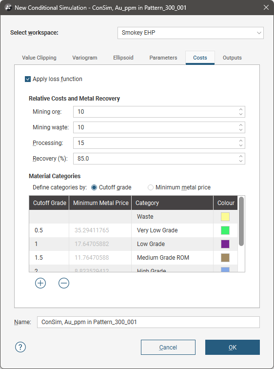

Costs
In an open pit mine, all material must be moved and therefore a choice must be made about the destination of all material: run of mine ore, stockpiles or waste. We cannot know in advance the actual grade of any block and must base decisions on an estimate. Those estimates are always imperfect, and so there is the inevitable risk of misclassification:
- Rock that is actually ore may be sent to the waste dump.
- Rock that is actually waste may be sent to the mill.
Both these types of misclassification result in loss, but the losses incurred are asymmetric: the economic loss resulting from sending ore to the waste dump is not the same as the loss from sending waste to the processing plant.
There is also uncertainty about the actual grade of the block, but the magnitude of loss incurred depends on actual grade.
An economic classification function is used to account for both this asymmetry in losses and also the underlying uncertainty in grade. This is achieved by applying a loss minimisation function to all realisations of a simulation ensemble.
In the Costs tab, enable Apply loss function to add profitability to the simulation.
Set the specific cost values for Mining ore, Mining waste, and ore Processing, using the currency and units of mass used in the project, e.g. USD$25/tonne. The expected Recovery percentage from processing is also needed.
There are two options for Material Categories:
- Cutoff grade. Category classifications are defined based on grades.
- Minimum metal price. Category classifications are defined based on minimum metal price. Prices used will depend on the units used in estimation, e.g. if commodity grades are estimated in g/t then the commodity price should be expressed in $/g; if commodity grades are estimated in %, then the commodity price should be expressed in $/t.
Click the Add button (
) for a new table row in which a Category can be identified along with the associated Cutoff Grade or Minimum Metal Price. Click the colour chips to change the associated colour for the category, if required.

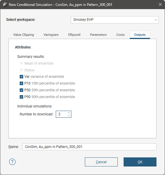

Outputs
Conditional simulation will always produce the Mean of ensemble and Status results per block; simulated blocks will have a Status of Normal. You can also generate additional results, although these are optional:
- Var (variance of ensemble). The statistical variance across the simulated result values.
- P10 (10th percentile of ensemble). The statistical 10th percentile point in the simulated result values.
- P50 (50th percentile of ensemble). The statistical 50th percentile point in the simulated result values.
- P90 (90th percentile of ensemble). The statistical 90th percentile point in the simulated result values.
If the dataset has a normal distribution, P50 is the same as the median value, but P50 is the preferred measure for central tendency when the distribution is not normal or not known.
Under Individual simulations, Number to download specifies how many simulations you want returned for inspection from the Evo processing service. You do not need to have any simulations returned, but obtaining a sample allows for inspection of the results for validation and verification. It is also not usually necessary to download all the simulations for inspection. The simulations returned will be randomly selected from the ensemble, although the name assigned will always be sequentially numbered to simplify the use of these realisations in user-defined calculations.

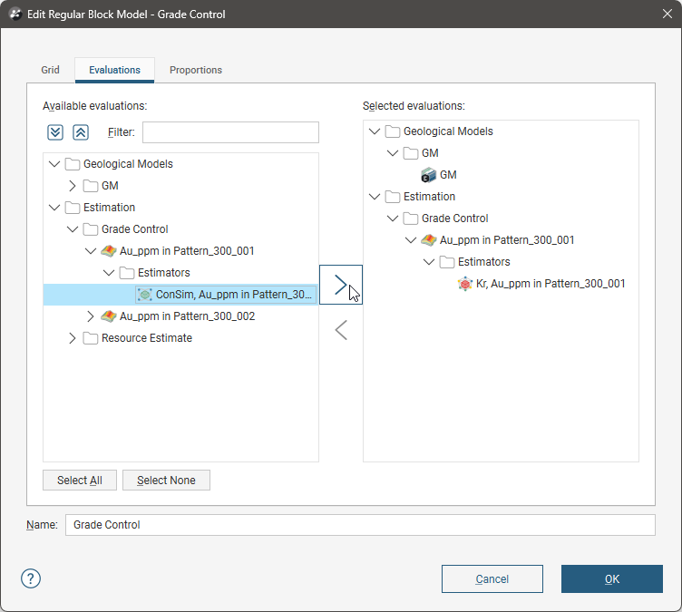

Running a Conditional Simulation
To run a conditional simulation, right-click on a regular block model in the project tree. Select Evaluations and add the conditional simulation estimator to the block model.
Conditional simulation is not supported for octree sub-blocked models, fully sub-blocked models, or variable-z block models.
When you click OK, Leapfrog Energy will connect to Seequent Evo computation services to access cloud resources and run the simulation computations. How long this process takes will depend on the number of points in the dataset. Progress will be shown in the Leapfrog Energy processing queue.

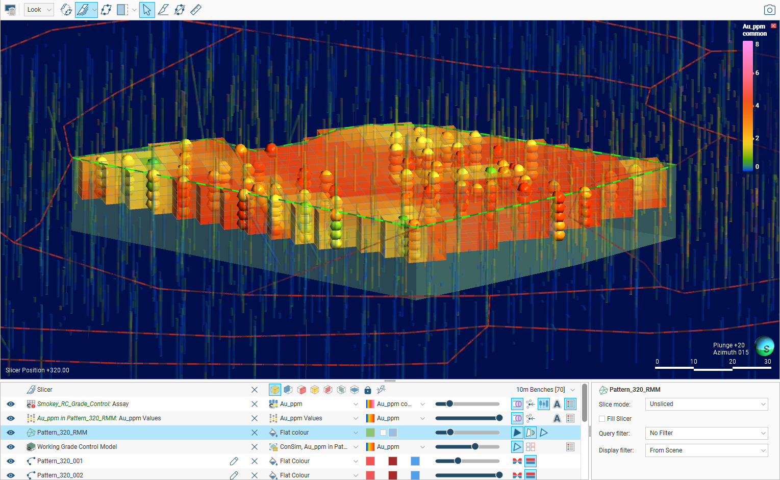

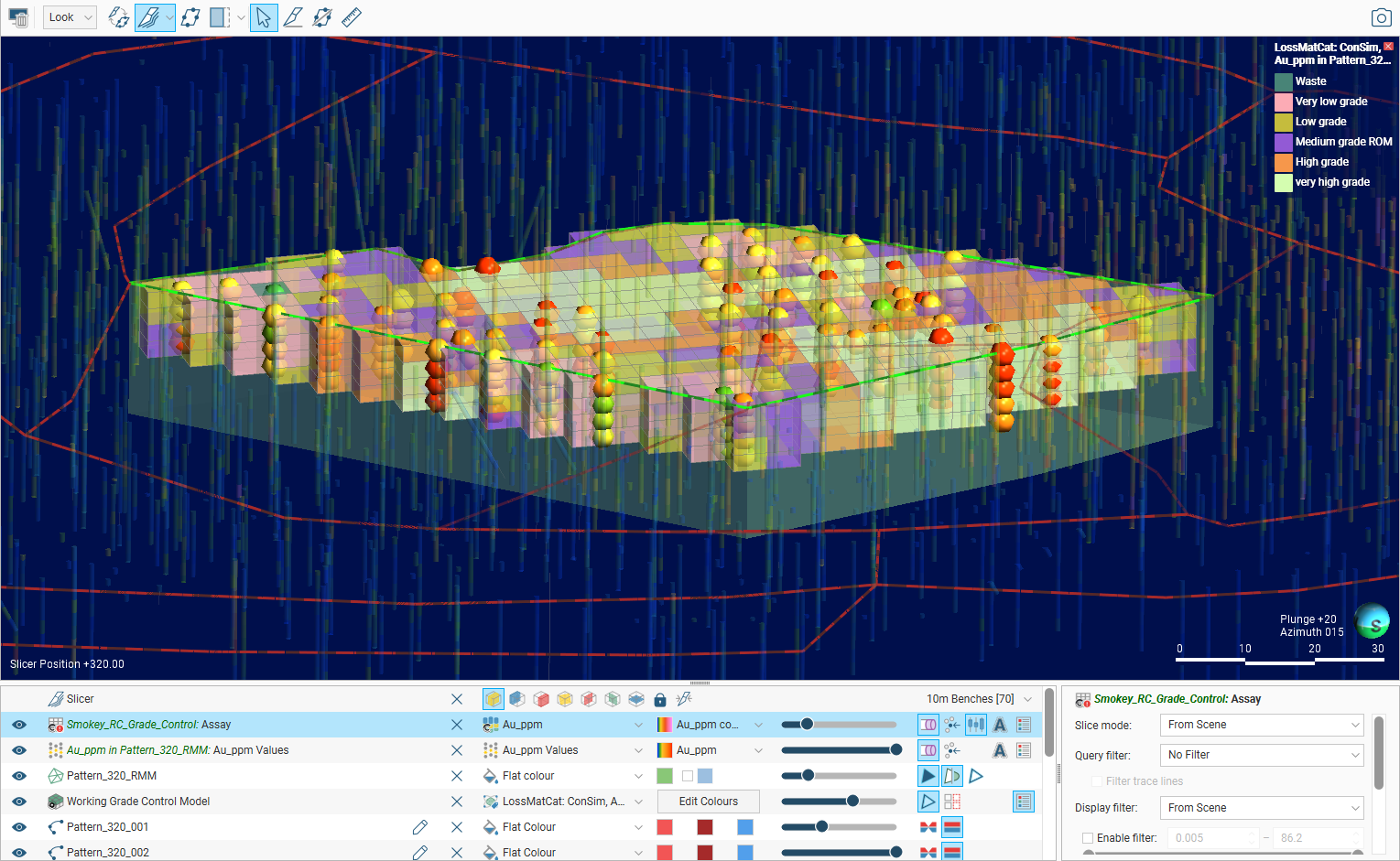

Reviewing Conditional Simulation Results
Review the resultant grade estimate in the scene alongside the input sample values:
If it was enabled, you can also review the calculated loss function value categories for optimum material classification based on the grade uncertainty:

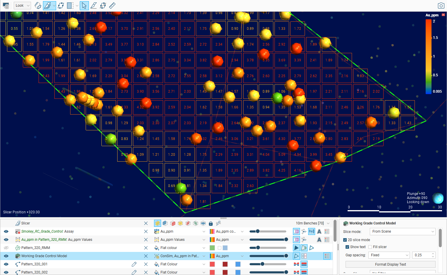

You may find it useful to view the block model in 2D with text labels:
We recommend using shared colourmaps for standardisation and clear communication. For more, see Colour Options in the Visualising Data topic.

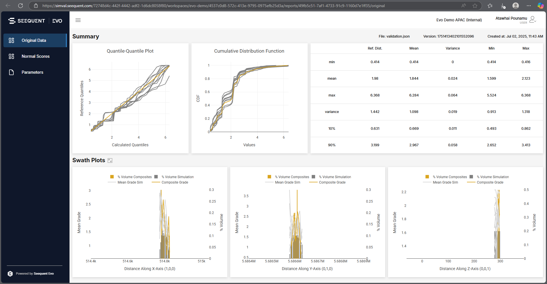

Viewing Validation Reports
Validation reports generated from a conditional simulation will be added to the block model in the project tree under the heading Consim Reports. Right-click on a report and select Open in Seequent Evo to open it in your browser:
Switch between the Original Data and the Normal Scores views using the sidebar.

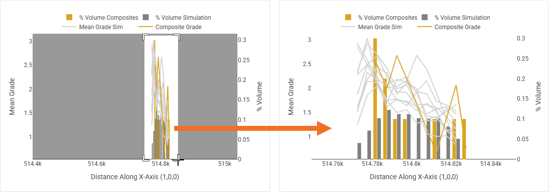

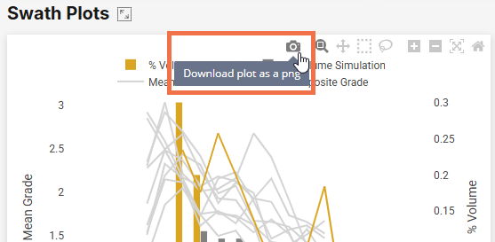

Hold your mouse cursor over a chart to reveal a toolbar.
From the toolbar, you can save each chart as a local PNG file by clicking the camera button:
To reframe a chart around a region of interest, click the magnify button, then click-and-drag a box around the region of interest:
There are also controls for panning and zooming in and out. Each of the axes can be dragged to be repositioned.
To reset the chart to the original appearance, there are Autoscale and Reset axes buttons.
Select Parameters in the sidebar to see a report of the parameters used to generate the conditional simulation, including the JSON parameters used by the Seequent Evo simulation service. One particularly useful detail in the report is the identification of the Seed used. See Parameters above to see how this number can be used in the Random seed input parameter field to get repeatability in results.

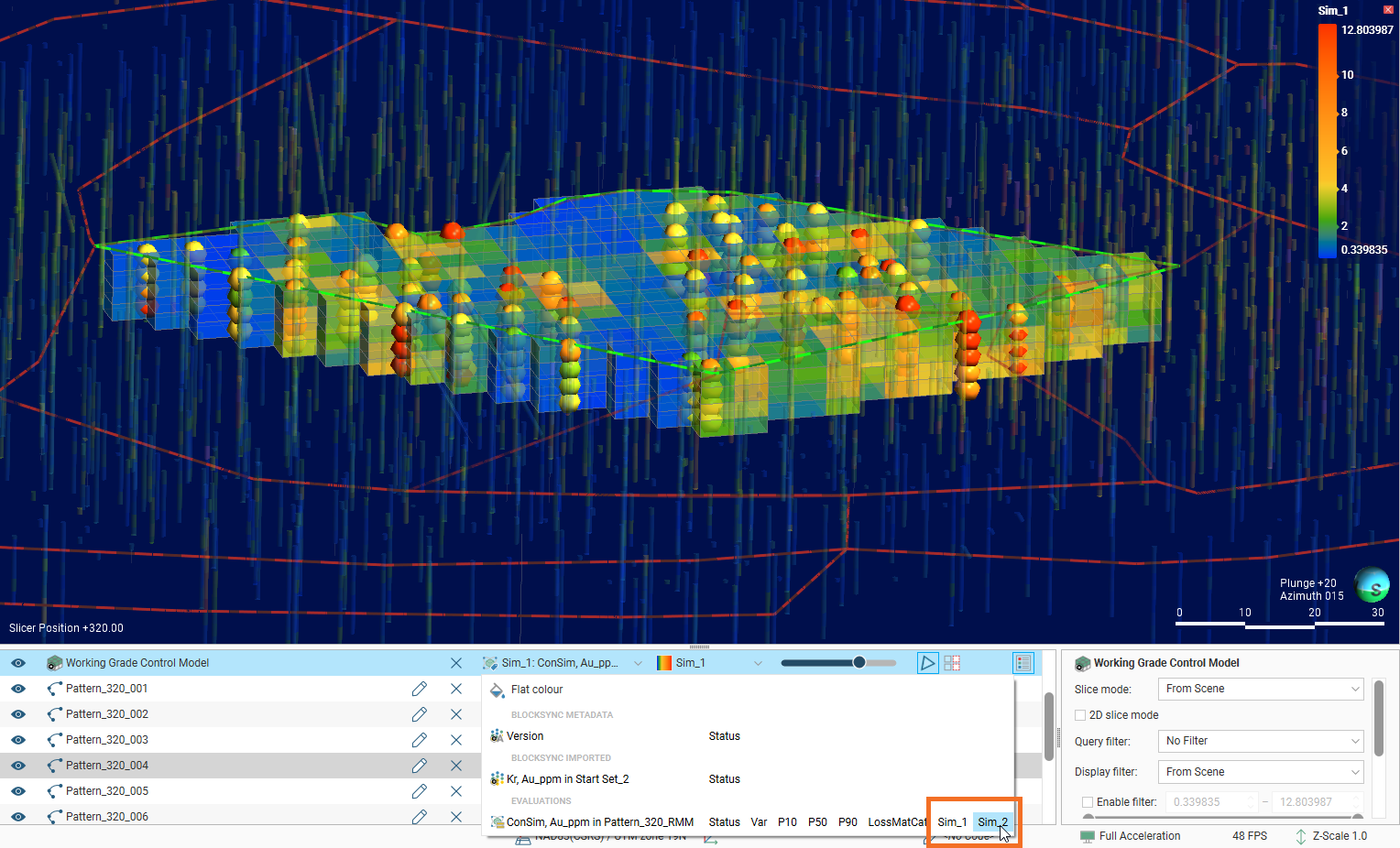

Comparing Individual Simulations
If you specified any number of individual simulations to download, each individual simulation can be selected as colouring options in the shape list for the conditional simulation:
Switch between individual simulations to obtain an impression of the similarities between simulation runs.
