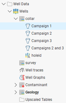

To create a query filter for a data table, right-click on the table in the project tree and select New Query Filter. The New Query Filter window will appear and you can choose which way you prefer to build your query. Assign the filter a name and click OK to save it. It will appear in the project tree under the table to which it applies:
Query filters defined for collar tables are available to all other drilling data tables.

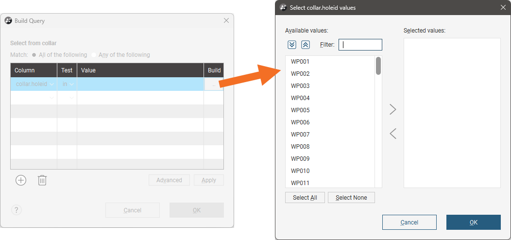

The second window, the Build Query window helps you build some common queries by selecting from the data columns in the table and defining different tests. Open this window by clicking the Build Query button in the New Query Filter window. See The Build Query Window for more information on building queries in this way.

To add a criteria, click Column to view a list of columns available in the table. Select a Test and enter a Value. What can be entered for the Value depends on the type of column and test selected.
Quotes are not required around text values entered in the value column as they are in SQL. Leapfrog Energy will add quotes and brackets to the value "MX, PM" to make a valid SQL list of strings "('MX', 'PM')" when the query is saved.
Once Column and Test have been entered, if the Column is an enumerated list of values, a button is enabled in the Build column to assist in selecting the Value. When clicked, the Select column values window opens, allowing the desired values to be selected from the list of available options.

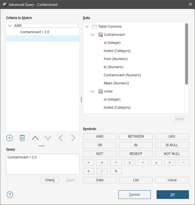

The Advanced Query window provides a powerful and flexible query building using the Leapfrog Energy query language.
Enter the query in the Criteria to Match area on the left. The query is displayed as a tree structure with AND and OR terms as the branch nodes and conditions as the leaves. Use the Delete button to delete a row from the query and the Add button to add a blank row. The Check button can be used at any time to check if the current query statement is valid. Below the buttons is a box showing the raw SQL form of the query.
Except for the arrow buttons, the buttons down the middle of the dialog are used for entering values into the query. The arrow buttons are used for moving the currently selected criteria to a different position in the query. The Date, List and Value buttons will open a builder dialog for the column selected in the current row. If there is no column found or the column is of the wrong type, an error message is displayed.
The tree on the right contains all the columns available to the query. Double-click on a column name to insert it into the query.
