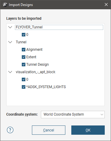

To import a design, right-click on the Designs folder and select Import Designs. In the window that appears, navigate to the folder where your design is stored and select the files you wish to import. You can use the Shift and Ctrl keys to select multiple files. Click Open.
All models and layers available in the selected files will be displayed. Here three files have been selected for import, FLYOVER_Tunnel, Tunnel and visualization_-_apt_block:
Select the layers you want to import. If the files contain information on more than one coordinate system, select the system you want to use from the Coordinate system list. Click OK to import the selected objects.

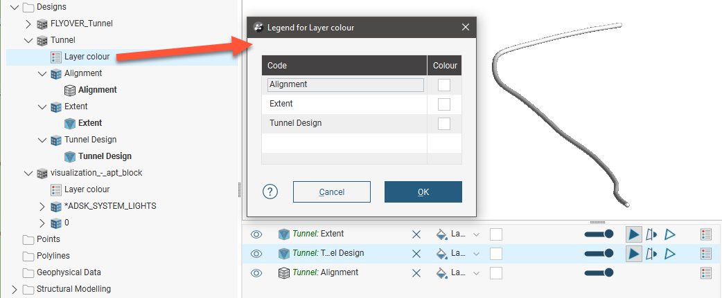

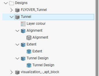

The model will be added to the project tree; expand it to see the different layers. For example, here a Tunnel file has been expanded in the project tree, showing the different layers:
The layer colours are saved in the Layer colour object (
), which you can double-click on to change the colours used.

Drag the different layers of the design into the scene to display them. Meshes can be displayed using a Flat colour, the Face dip or the Layer colour. Design lines can be displayed using the Layer colour. Double-click on the Layer colour object (
) in the project tree to change the colours used:

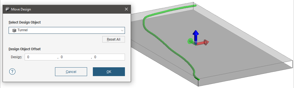

If all or part of the design are in the wrong location, you can move the entire design or part of it. Right-click on the object you want to move and select the Move option. The Move Design window will appear, together with tools in the scene for making changes. Select the part of the model you wish to move from the Select Design Object list. Here the whole model has been selected and there is one set of Offset values displayed in the Move Design:
Click on one of the arrows in the scene to move the design; you can only move in one plane at a time. Updated values will be displayed in the Move Design window.
To move just part of the model, select it from the dropdown list. The controls in the scene will adjust only the location of the selected layer and its contents:
Click the Reset All button to return all location values to 0,0,0.
Click OK to close the Move Design window and save the new values. All parts of the model that have been moved will be marked in the project tree with moved sign (
). For example, here only the extent has been moved:
You can edit the offset values by opening the Move Design window once again.

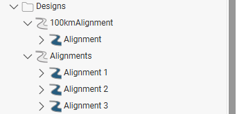

To import an alignment, right-click on the Designs folder and select Import Alignments. In the window that appears, navigate to the folder where the alignments file is stored, select the file you wish to import and click Open to start importing the file. If there is more than one alignment in the file, you will be prompted to select which ones to import. Otherwise, the alignment will be imported and added to the Designs folder.
Alignments are organised in the project tree by the imported file. For example, here two files have been imported into Leapfrog Energy. The first, 100kmAlignment.xml, contains a single alignment, whereas the file Alignments.xml contains three separate alignments:

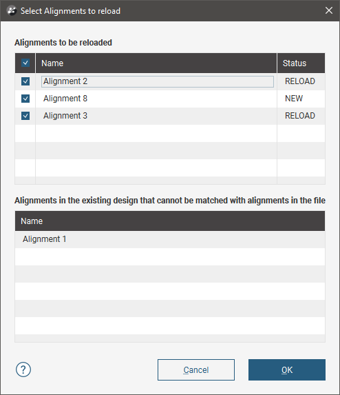

Reloading Alignments
To reload an alignment, right-click on it in the project tree and select Reload:
Navigate to the folder containing the alignment file and select the file. Click Open. You will be prompted to select which alignments to reload:
Click OK to reload the data. The original data will be overwritten and dependent objects will be updated to reflect the new data. If there are new alignments in the file, they will be added to the existing parent alignment.

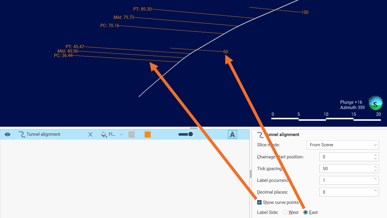

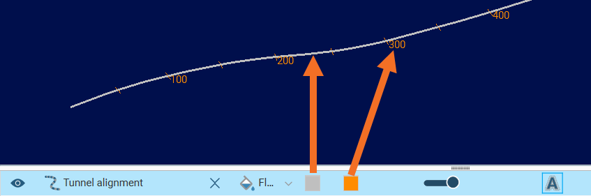

When an alignment is displayed, you can change how the chainage values are displayed using the Chainage start position and Tick spacing controls in the properties panel. The Label occurrence number determines how often the label appears on the ticks. For example, a value of 2 places a label on every second tick. Decimal places changes the resolution of the label value. To hide the chainage values in the scene, disable the text control (
) in the shape list.
The colour options in the shape list control the alignment colour and the tick mark and chainage values colour:
When the chainage values are displayed, there is also a Label Side option in the properties panel; choose whether to have the labels appear on the West or East side of the alignment line. There is also an option in the properties panel to Show curve points. When enabled, curve points will always appear on the opposite side of the alignment line from the Label Side setting.
