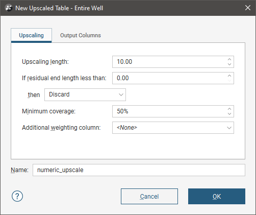

Compositing in the Entire Well
When compositing is carried out using the Entire Well option, the wells are divided into intervals wherever numeric data occurs and the parameters set in the Compositing tab are applied to all values down the length of wells.
The order of the operations in numeric compositing is as follows:
- A compositing length is selected. This may or may not end up being the exact length of composited intervals, which will depend on subsequent parameters and the actual data.
- Determine how to handle short sections at the end of wells that are shorter than the compositing length.
- If Distribute equally throughout well is selected, all the composited intervals will grow longer than the compositing length.
- If Add to previous interval is selected, the last interval will be longer than the compositing length.
- Compare the total length of data in each composited interval to the Minimum coverage parameter. If the available data does not meet the threshold for an interval, that interval will not get a composited value.
- Determine how to weight the input data, if required.
- Derive a value for each of the composited intervals that passes the minimum coverage test.

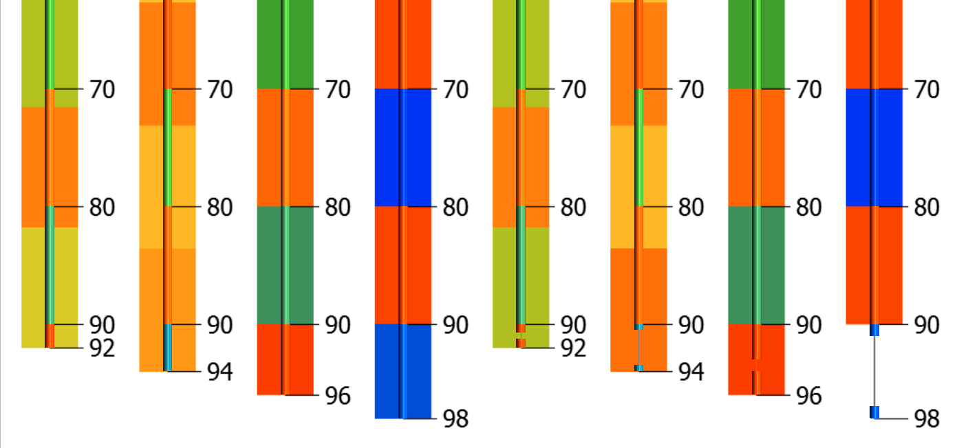

Residual End Length Handling
The full length of each well will seldom divide up exactly into a whole number of intervals of the specified Compositing length. For this reason, “residual segments” will occur at the end of each well and where there is data missing down the length of the well. In the Compositing tab, you can set a residual end length value, which is the threshold at which all short residual segments will simply be treated as composited intervals. You can then specify how residual segments that are shorter than the residual end length are handled. Options are:
- Discard. If the residual segment is shorter than the Residual end length for a composited interval, it is discarded.
- Add to previous interval. If the residual segment is shorter than the Residual end length for a composited interval, it is added to the previous interval. Note that when this occurs, the actual length of that last composited interval will be longer than the Compositing length specified.
- Distribute equally throughout well. If the residual segment is shorter than the Residual end length for a composited interval, the extra length is divided up and distributed to each of the other intervals. Note that when this occurs, the actual length of each composited interval will be longer than the Compositing length specified.
When the residual segment is longer than the residual end length but the length of provided data within the residual segment also meets or exceeds the Minimum coverage for a composited interval, the residual segment will simply be treated as a composited interval, although it is shorter than the typical intervals. When the Minimum coverage proportion is not achieved, the data is discarded. See Minimum Coverage below for more information on this setting.
In the illustration below, a series of adjacent wells have varying lengths of small data intervals that will not make up a full composited interval. The Residual end length is 5, the option to Distribute equally throughout well has been selected and the Minimum coverage is 32%. The well data is shown in the centre, with the composited data shown around the wells.
The left four wells have extra residual segments of 2m, 4m, 6m and 8m. The two wells with short lengths less than 5m show the extra length has been distributed across the well intervals for compositing, as seen by the well interval transitions not lining up with the 10m depth markers. The wells with extra lengths of 6m and 8m have had the lengths added as short composite intervals, as they exceeded the residual end length.
The right four wells have missing data of varying lengths. Again, the two wells on the left have had the residual segment length distributed across the well intervals for compositing, as seen by the interval transitions not lining up with the 10m depth markers. Even though the 4m residual end segment has only 25% data coverage, the selected action is applied because the residual segment is shorter than the residual end length. The 6m residual end segment has 83% data coverage, so the additional segment is added as a short composited interval. The 8m residual end segment on the very right has only 25% data coverage, so the data is discarded.

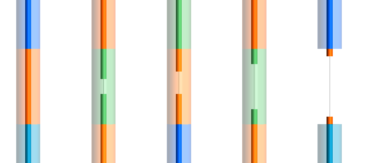

Minimum Coverage
The Minimum coverage parameter determines whether or not a value will be calculated for a composite interval, based on the data available in the input data table. The Minimum coverage is a threshold the input intervals must meet in order for a composited value to be calculated. If, for example, the Minimum coverage is 50%, a value will be calculated for a composite interval only when there is data in at least 50% of the well that informs the composited interval.
- Setting Minimum coverage to 100% will result in composite intervals being assigned values only when there is data for all well intervals that inform the composite interval.
- Setting Minimum coverage to 0% will result in all composite intervals being assigned values, even where input intervals have no data.
In the image below, several adjacent wells have various sized gaps in the drilling data, shown using the inner solid line. The outer translucent line represents the composited intervals, and as the Minimum coverage value was set at 32%, only the largest data gap resulted in a missing composited interval.
Intervals that have no data can have a significant effect when compositing data as they are ignored by the compositing algorithm. The effect of these missing intervals can be managed using the Minimum coverage parameter, but it’s best to assign special values where intervals have no data. For example, intervals that are missing data can be assigned a value of 0 or that of the background mineralisation. See Handling Special Values for more information.

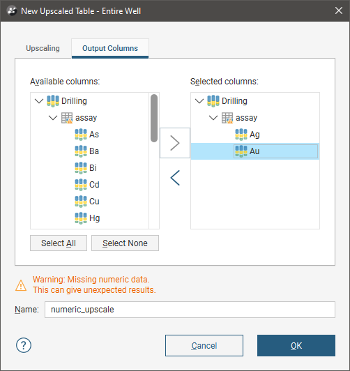

Output Columns
In the Output Columns tab, select the columns to be added to the numeric composite table. Move selected items from the Available columns list to the Selected columns list by clicking an item then clicking the
button. You can select multiple items by holding down Ctrl while clicking.

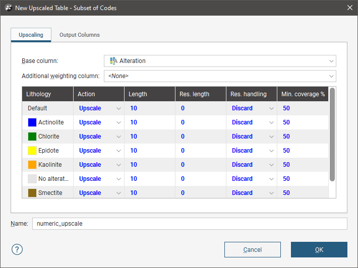

Compositing in a Subset of Codes
When compositing is carried out using the Subset of Codes option, some codes can be excluded from the composited table or the raw data from the Base column can be used. When compositing is applied to a code, the same parameters apply as for the Entire Well option, but different codes can use different Compositing length and Minimum coverage parameters.
For the Action column, select from:
- Composite. Numeric data that falls within the selected code will be composited according to the parameters set.
- No compositing. Numeric data is not composited within the selected code. The raw data will be used in creating the new data table.
- Filter out. Numeric data within the selected code will excluded from the new data table.
See Compositing in the Entire Well above for an explanation of the Length, Min. coverage, Res. length, Res. handling and Additional weighting column parameters.
Once you have set the compositing parameters, click on the Output Columns tab to select from the available columns of numeric data. See Output Columns above for more detail.

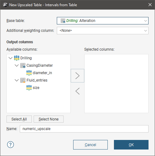

Using Intervals From Another Table
When compositing is carried out using the Intervals from other Table option, first select the Base table. This is the table that will that will be used to determine the interval lengths in the composited table.
The value assigned to each interval will be the length-weighted average value, and you can use an Additional weighting column. This column must contain valid (positive) values for all of the composite’s output intervals. If this is not the case, you will receive a message saying the table cannot be created. If the column selected as the weighting column is also in the list of output columns, that output column will be composited using length-weighted averaging only.
There are no further compositing parameters to set. Click OK to create the table.

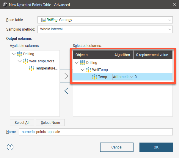

Using Intervals with Advanced Upscaling
When compositing is carried out using the Intervals from other Table with Advanced Upscaling option, first select the Base table and the Sampling method. You can also select an Additional weighting column, but note that this will only apply when the Arithmetic algorithm is selected.
There are two options for Sampling method:
- Whole interval. All data points in the upscaled interval are taken into account when calculating the upscaled value for that interval.
- Dominant category. A Category column is selected that determines whether or not data points in the upscaled interval are taken into account. Data points in the interval that do not occur in the dominant category are not used in calculating the upscaled value for that interval.
Then select which Output columns you wish to include. You can then set the Algorithm and 0 replacement value for each column:
Available algorithms are Arithmetic, Geometric, Harmonic, Max, Median and Min.

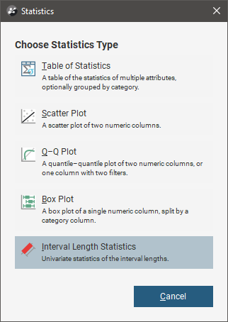

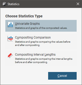

To view statistics for the table, right-click on it and select Statistics.
Right-click on the table columns and select Statistics to view information about the composited values.
The first option displays statistics on the composited values. The other two options display statistics comparing data before and after compositing.

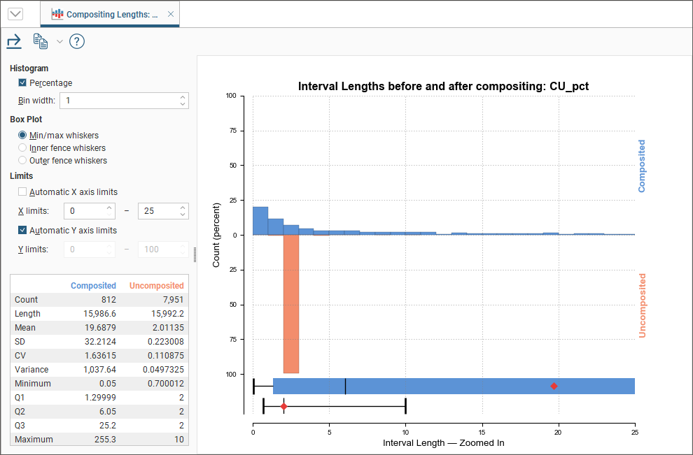

Compositing Interval Lengths
This graph shows a double histogram of distributions of the interval lengths before and after compositing.
In the Histogram settings, Bin width changes the size of the histogram bins used in the plot.Percentage is used to change the Y-axis scale from a length-weighted scale to a percentage scale.
