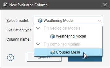

To add an evaluated column to a table, right-click on the table and select New Column > Evaluated Column. In the New Evaluated Column window, select the model you want evaluated onto the interval table. The Select model field organises the available models into the sections Geological Models and Combined Models.

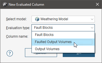

When the selected model is a faulted model, the Evaluation Type setting determines whether the model’s output volumes, faulted output volumes or fault blocks are evaluated.

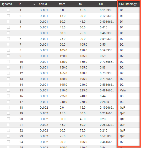

A column will be added to the interval table, with each existing interval receiving a category evaluation based on where the midpoint of the interval is located and the corresponding geological model or mesh volume.

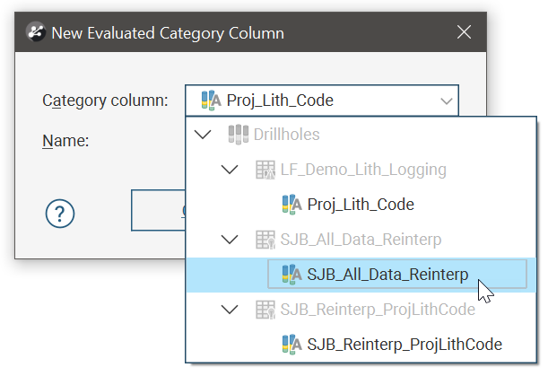

When adding a new category column from drilling data, right-click on the object in the project tree and select New Column > Evaluated Category Column. In the New Evaluated Category Column window, open the Category column dropdown list and select the column you want to add from those available.
Give the new evaluated column a Name, then click OK.

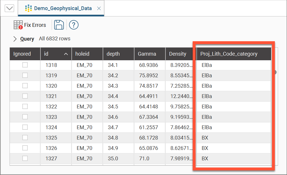

A column will be added to the table, with each existing entry receiving a category evaluation based on where the downhole location is relative to the interval category data. If the depth is greater than or equal to the category column’s interval ‘from’ depth, and less than the interval’s ‘to’ depth, the location will be assigned the code of that interval.

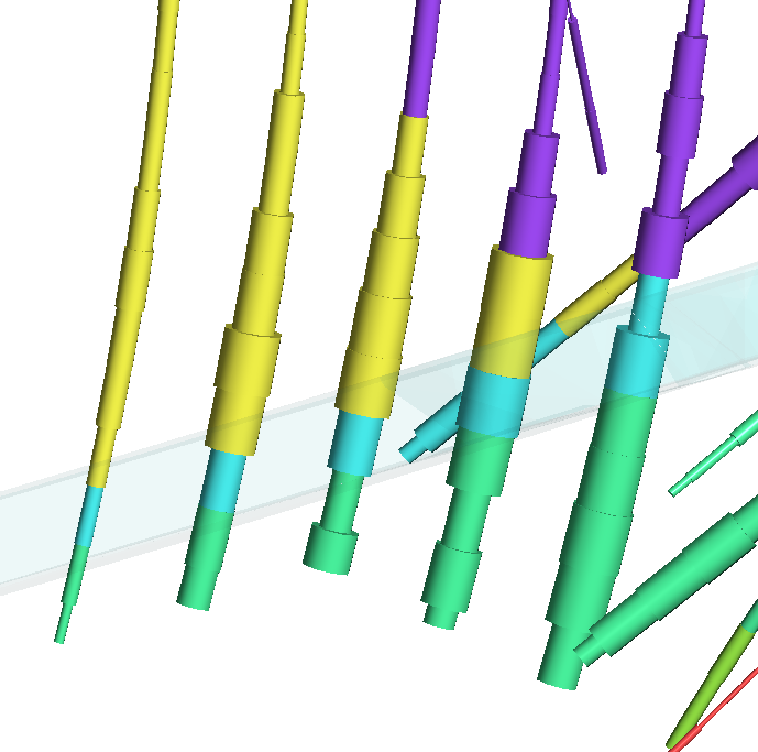

This scene view shows wells with the radius sized proportionally to the assay value, and coloured according to lithology, once the lithology information was added as an evaluated column to the assay table. A vein volume is shown in transparent blue to show the relationship between the geological model volume and the evaluation at the interval mid-points.
