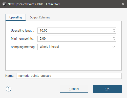

Upscaling in the Entire Well
For this option, all values down the length of wells are upscaled. Select Entire well, then set the Upscaling length. Upscale lengths are generated from the location down the well.
The Minimum points parameter determines how many points are required for a valid upscaled interval to be created. Points are assigned a value according to where they fall in the upscaled interval; points that lie exactly on the border of an interval are assigned a weight of 0.5, whereas other points are assigned a weight of 1.
There are two options for Sampling method:
- Whole interval. All data points in the upscaled interval are taken into account when calculating the upscaled value for that interval.
- Dominant category. A Category column is selected that determines whether or not data points in the upscaled interval are taken into account. Data points in the interval that do not occur in the dominant category are not used in calculating the upscaled value for that interval.
Click on the Output Columns tab to select from the available columns of data, then click OK to create the table.

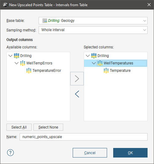

Upscaling in Intervals from Another Table
For the Intervals from other Table option, the interval lengths from the Base table are used to determine upscale lengths. The value assigned to each interval is the length-weighted average value, and there are no further upscaling parameters to set.

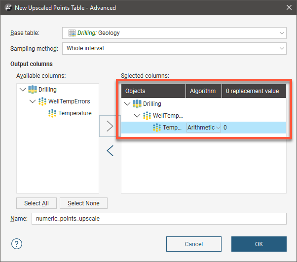

Using Advanced Upscaling
When upscaling is carried out using the Intervals from other Table with Advanced Upscaling option, first select the Base table and the Sampling method.
Then select which Output columns you wish to include. You can then set the Algorithm and 0 replacement value for each column:
Available algorithms are Arithmetic, Geometric, Harmonic, Max, Median and Min.
Click OK to create the table.
