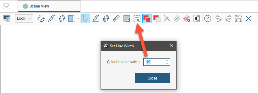

You can change the width of the line used by the Select Intervals tool by clicking on the second button in the toolbar:
The number shown as part of the Change line width button is the currently set line width.
You can keep this window open while selecting intervals so you can increase the line width to choose more intervals or reduce the line width to select fewer intervals.

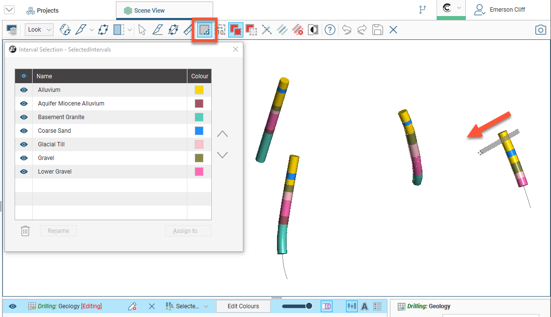

To select intervals, click on the Select Intervals button (
) and click the Add Intervals button (
). In the scene, draw a line across each interval you wish to select:
Selected intervals are highlighted in the scene. If you accidentally select the wrong interval, either:
- Hold the Ctrl key while drawing across the interval.
- Click the Remove intervals button (
) and draw across the interval once again.

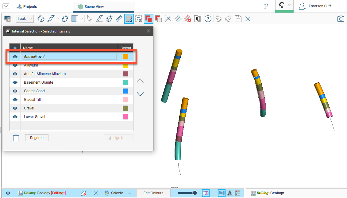

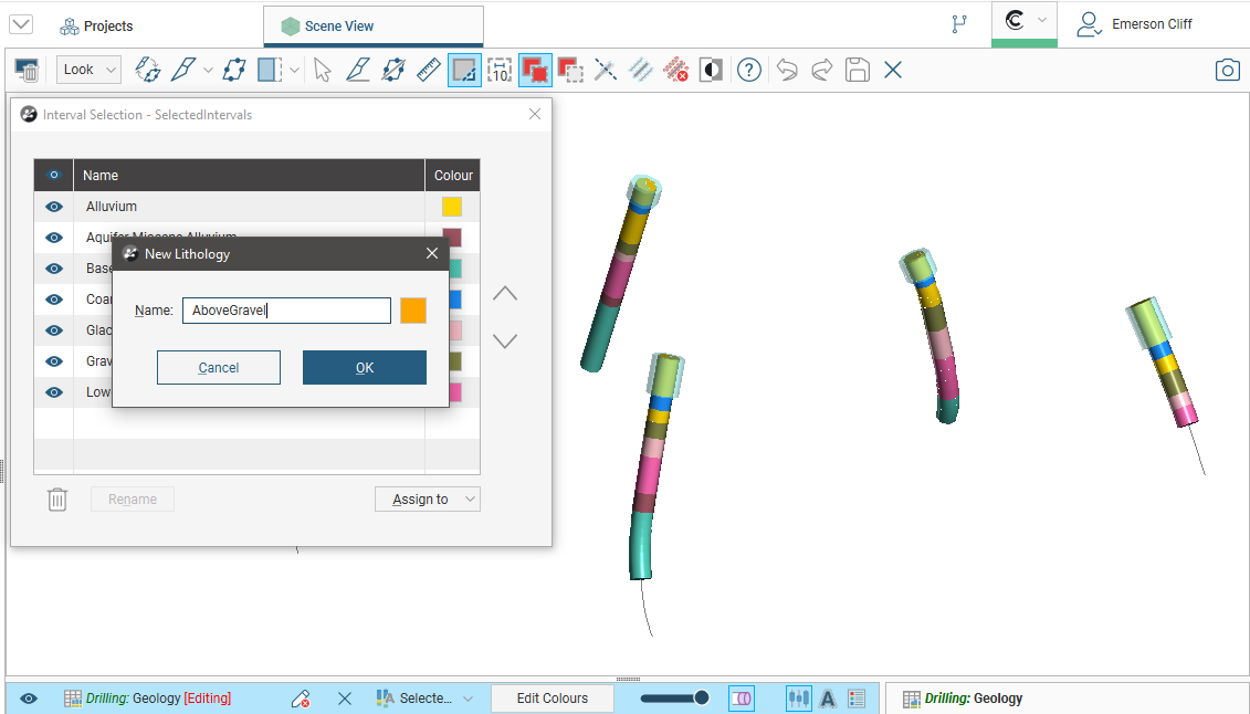

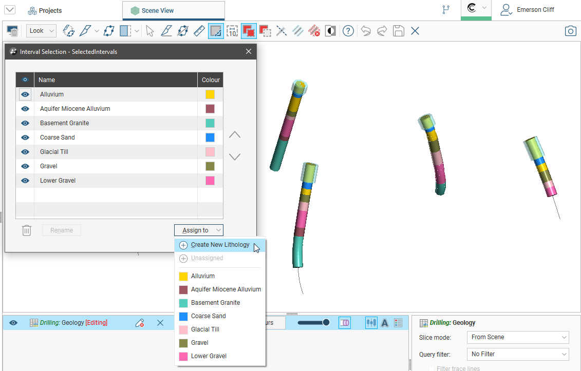

When you have selected at least one interval, click on the Assign to button, then either select an existing lithology or create a new lithology by selecting Create New Lithology:
Enter a Name for the new lithology, then click OK:
The new lithology will be created and the scene updated to reflect the changes:
Once you have created a new lithology, you can:
- Assign more intervals to the lithology. Select intervals in the scene, then select the lithology from the Assign to list.
- Rename the lithology. Click on the lithology in the list, then click the Rename button.
- Delete the lithology. Click on the lithology in the list, then click the delete button (
). When you delete a lithology from the list, all intervals that have been assigned to that lithology will revert to the lithology assigned in the Base Column.

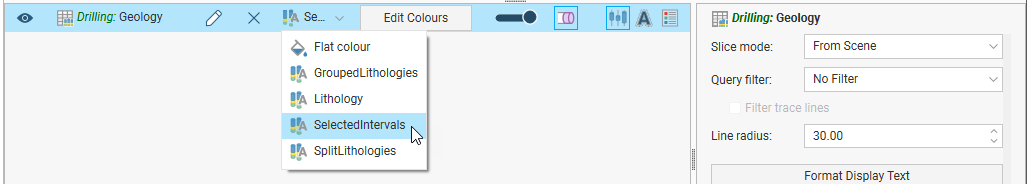

When you are finished, click the Save button (
The new lithology column will appear in the project tree as an additional lithology column in the interval table. Select the new column from the shape list to display it:

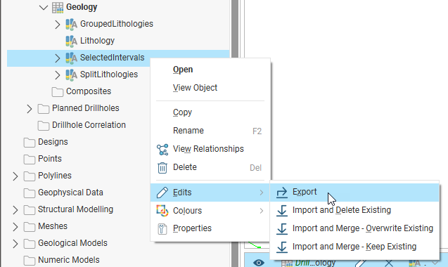

Exporting Interval Selection Edits
To export a list of interval selection edits, right-click on the interval selection in the project tree and select Edits > Export:
The file is exported in *.txt format.

If you have a list of interval selection edits you need to import into a project, right-click on the interval selection in the project tree and select Edit. Each of the Import options handles interval selections in the file and interval selections in the project in different ways.
- Import and Delete Existing. This option discards any edits made in the project and uses those in the file, even if the file does not contain edits that match those in the project. If you do not wish to keep any of your existing interval selection edits and will rely solely on those made in the file, choose this option.
- Import and Merge - Overwrite Existing. This option prioritises edits in the file over those in the project. Edits that are in the project but not in the file will be retained.
- Import and Merge - Keep Existing. This option prioritises edits in the project over those in the file. Edits that are in the file but not in the project will be added to the project.
