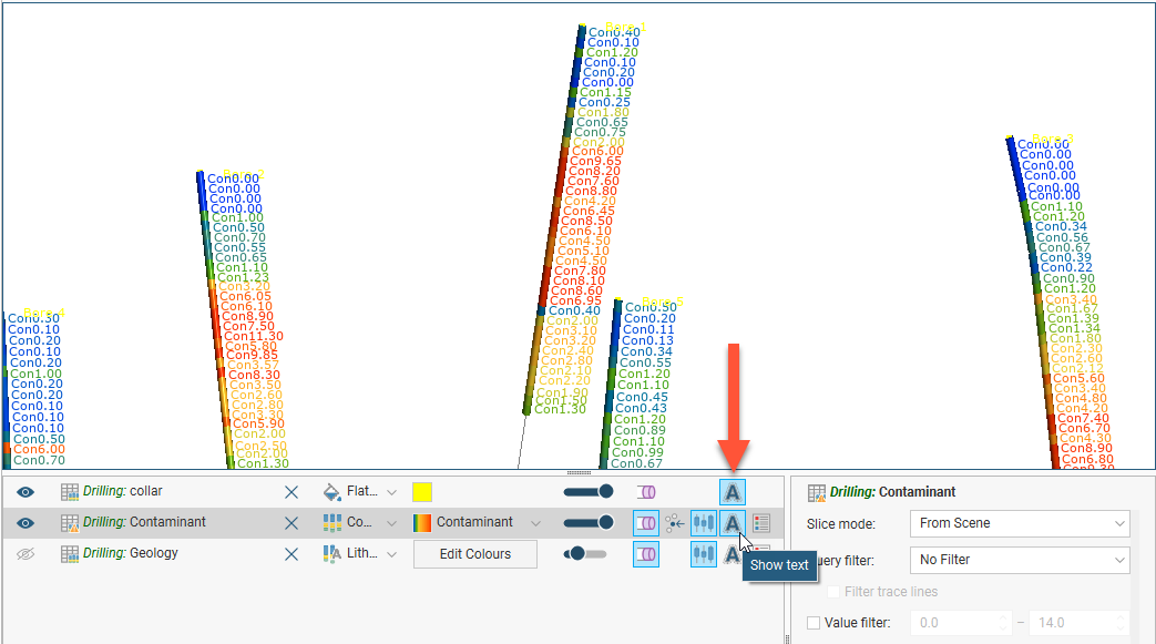

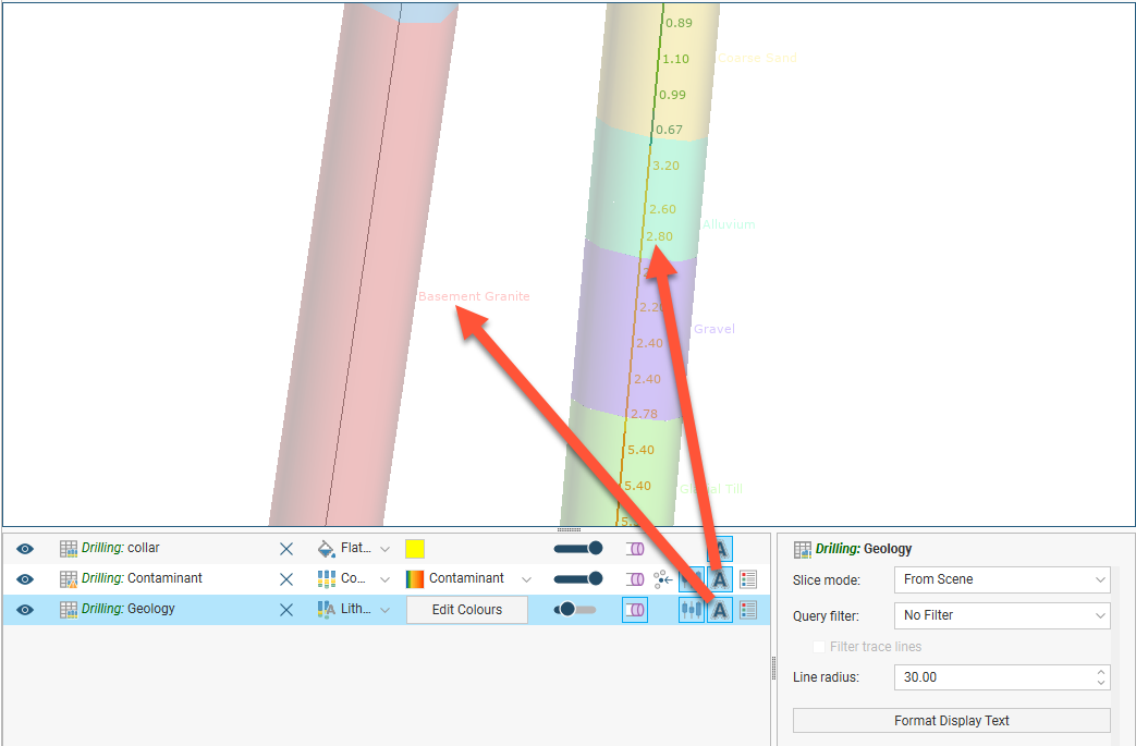

To display the data associated with each interval, click on the Show text button (
) in the shape list. Here, data display is enabled for two interval tables:

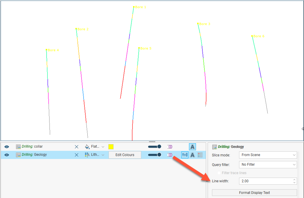

You can display wells as lines or cylinders. You can also display the data associated with each segment. Here, the wells are displayed as flat lines:

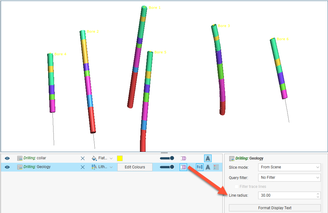

The width of the lines is set in the shape properties panel.
When the Make lines solid button (
) is enabled, the wells are displayed as cylinders and the property that can be controlled is the Line radius:

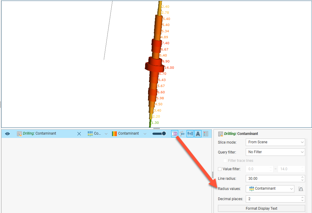

When numeric data is displayed, there is an additional option, to use a data column in the table for the cylinder radius:
When the log button (
) is enabled, the log of values is used for the radius.

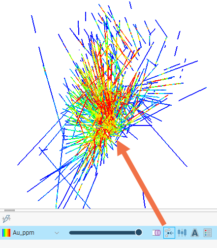

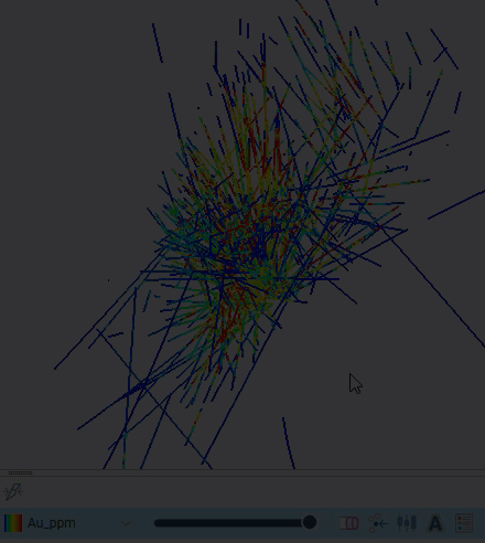

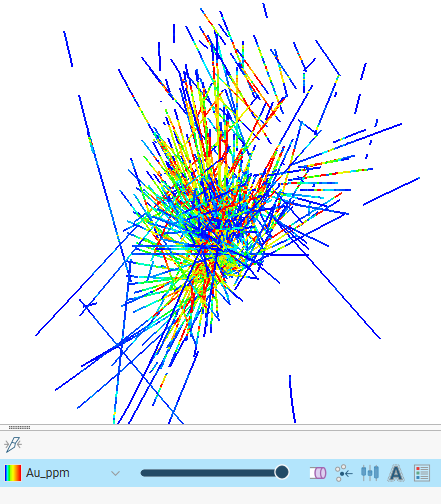

When viewing drilling data as lines with Make lines solid disabled, each data point is rendered in the scene as a square. When the scene is zoomed out to view the wider context, low value sample points can conceal high value sample points. This is because the sample points overlap when rendered in the scene, and when the square representing a low value is rendered, any high value point behind that low value point will be partly or completely hidden.
Enabling the Enhance high values option reveals those previously concealed points. Instead of the lower-value point concealing the higher-value point, the higher value point will be rendered on top in the scene.
This reveals the high value region of interest. A drawback of viewing with Enhance high values enabled is that individual wells may appear to weave oddly due to the way the points are rendered. However, visually following specific wells is usually not important at these view scales. When zooming in to see the detail of well paths, the reduction or lack of overlapping sample points will result in Enhance high values having little visual effect.
Enhance high values can be used to find trends of higher-grade material in a densely drilled region. It is best used while rotating the scene to visualise the location of the high values:
Enabling Enhance high values will disable Make lines solid as these are incompatible viewing options.

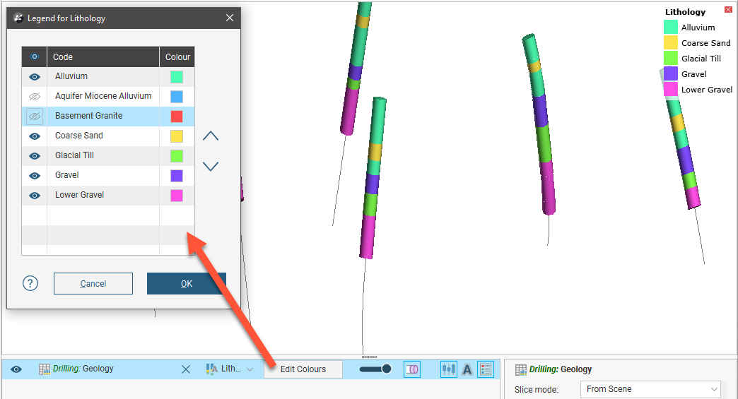

When lithology tables are displayed, you can hide some of the lithologies to help make better sense of the information in the scene. Click on the Edit Colours button in the shape list. In the window that appears, use the Show/Hide buttons (
) to determine what segments are displayed:
To select multiple lithologies, use the Shift or Ctrl keys while clicking. You can then change the visibility of all selected lithologies by clicking one of the visibility (
) buttons.

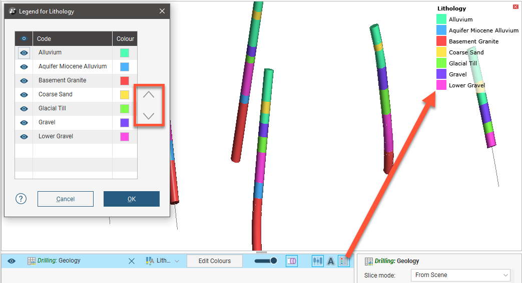

Displaying a Legend
To display a legend in the scene, click the Show legend button (
) for the table:
The legend in the scene will be updated to reflect lithologies that are hidden in the scene when you click Edit Colours and hide some lithologies.
Changing Colourmaps
To change the colours used to display lithologies, click on the Edit Colours button in the shape list. In the window that appears, click on the colour chip for each lithology and change it as described in Single Colour Display.
Use the Shift or Ctrl keys to select multiple codes. This is useful for moving multiple codes up and down in the list.

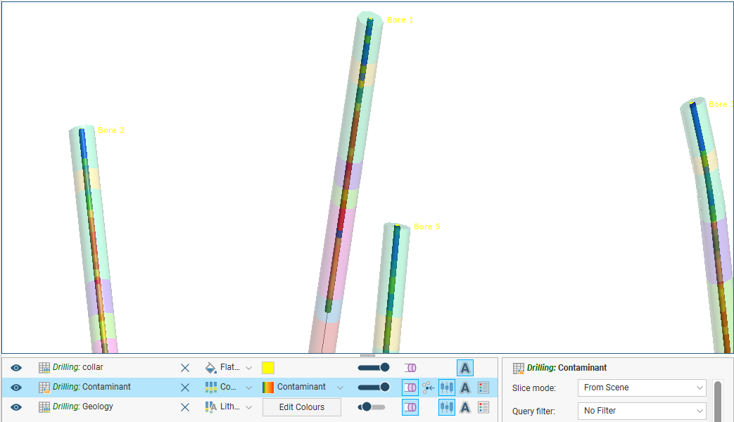

When viewing multiple interval tables, use the line and point size controls and the transparency settings to see all the data at once. For example, here, the geology table has been made transparent to show the contaminant intervals inside:

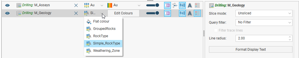

Selecting From Multiple Columns

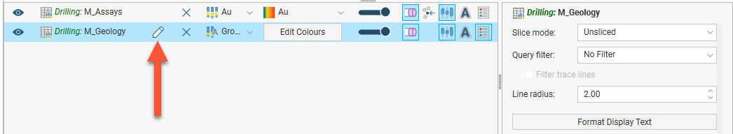

When an interval table has more than one column of data, select the column to view from the view list:
Some columns are editable, in which case you can click on the Edit button (
) to start editing the table:

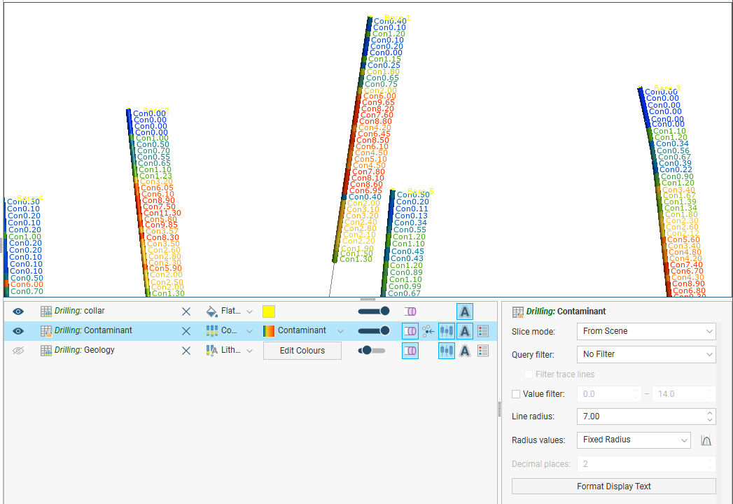

Displaying Interval Data in the Scene
Wells can be displayed with the data associated with each segment. For example, in the scene below, contaminant values are displayed along the well:

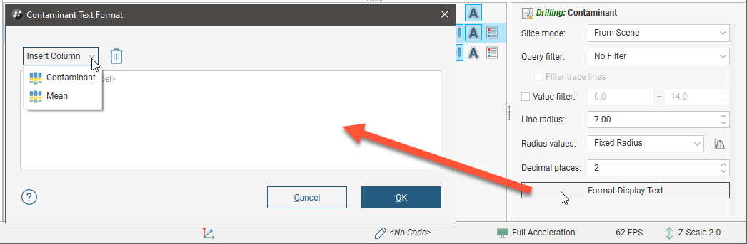

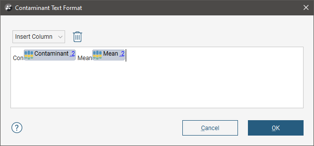

To view data in this way, select the table in the shape list, then click on the Format Display Text button. In the Text Format window, click Insert Column to choose from the columns available:
You can display multiple columns and add text:
Click OK to update the formatting in the scene. You can conceal the formatting in the scene by clicking on the Show text button (
) in the shape list:

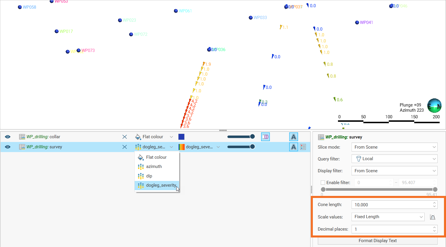

When you add the survey object (
) to the scene, each of the survey point measurements is shown using a tangent cone pointing in the surveyed point's downhole direction. The Show text button (
) will show or hide the associated value alongside the tangent cone. The cone can be assigned a colour using the view list.
When the survey object is selected in the shape list, the properties panel will show options to adjust:
- Cone length. The size of the tangent cone.
- Scale values options. These modify the size of the tangent cone using a selected factor or keeping the Fixed Length specified in Cone length. There is also the option to click the Use log of value for radius button (
) for value ranges that will benefit from the log scaling. - Decimal places. This specifies the precision of the label shown in the scene.

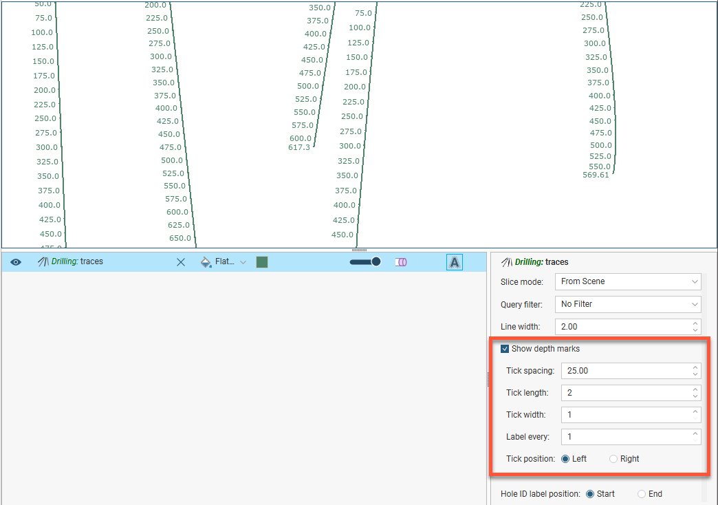

Displaying Well Traces
Adding the traces object (
) to the scene can be useful in visualising the extent of drilling. You can change the colour used to display the traces, and they can be displayed as lines or cylinders. You can also display depth markers in the scene. To do so, click on the traces in the shape list and enable the Show depth marks option:
Depth markers can be displayed with or without text. Enable the Show text option ((
)) to display the depth values. This option also displays the hole ID, which can be displayed at the start or the end of the well.

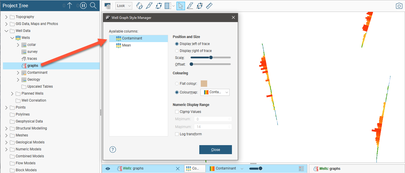

Displaying Well Graphs

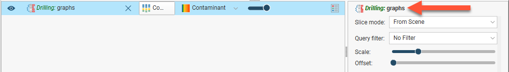

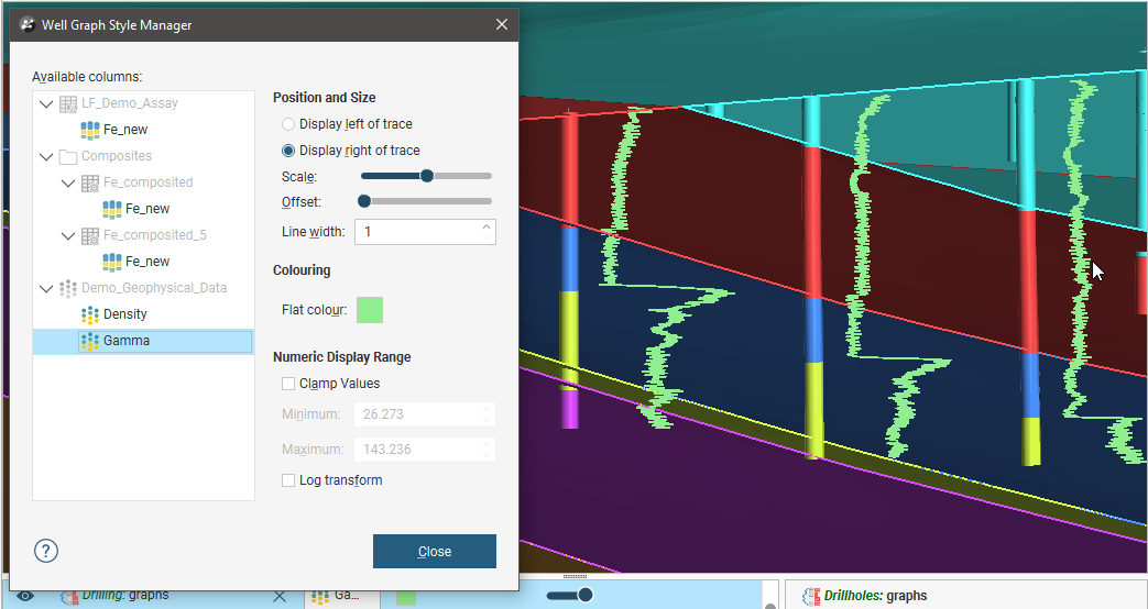

Downhole numeric data can be displayed in the scene as a bar graph and downhole points data can be displayed as a line graph. To display downhole data in this way, add the graphs object (
) to the scene. The Well Graph Style Manager will be displayed, showing the data columns available:
Data can be displayed to the right or the left of the well trace. Use the sliders to change the Scale and the Offset from the trace.
Data can be clamped, e.g. all values above the set maximum value will be set to the maximum value.
If there are negative values in the data, they will be displayed on the graph with a value of zero.
Downhole points can be displayed as a line, and you can change the Colouring, Scale and Offset of the line:
All changes made in the Well Graph Style Manager are automatically updated in the scene so you can experiment with the settings. Once you have closed the window, you can also change the Scale and Offset by clicking on the graphs object in the shape list:
To select a different column to display, open the style manager by double-clicking on the graphs object in the project tree or select a new column from the shape list.
If you are working in a new project into which you have just imported wells, the Well Graph Style Manager will open when you add it to the scene. If the Well Graph Style Manager does not open when you add the graphs object to the scene, it is because the styles have already been set, perhaps by another user. You can change them by double-clicking on the graphs object.
