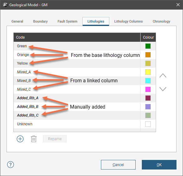

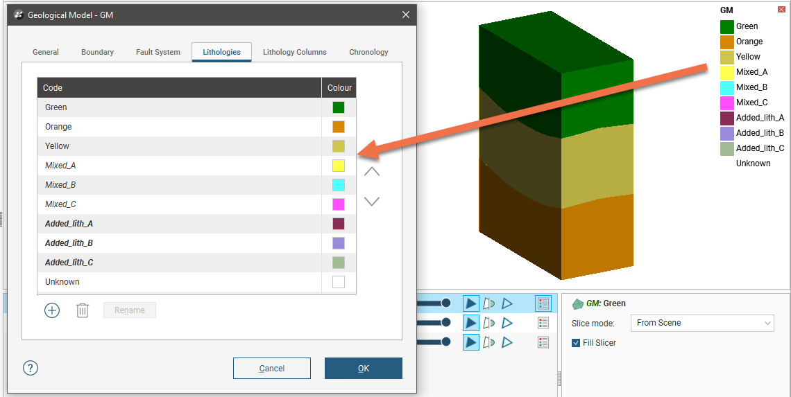

When you open the Geological Model window, how the lithology codes are displayed in the Lithologies tab tells you from what sources they were derived:
In the example above:
- The codes from the base lithology column are Green, Orange and Yellow, which are shown in plain text.
- The Unknown code is also shown in plain text. This is the code automatically defined for all geological models and is used to label lithologies that cannot be assigned to known lithologies. See Creating and Editing a Geological Model for more information.
- The codes Mixed_A, Mixed_B and Mixed_C come from another lithology column in the project, linked to the geological model via the Lithology Columns tab. These are shown in italic text.
- The codes Added_lith_A, Added_lith_B and Added_lith_C have been manually added to the model. These are shown in bold italic text.

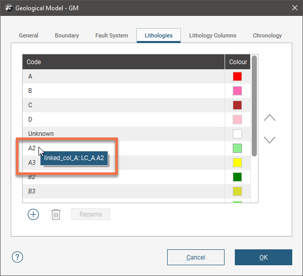

Codes from linked columns are shown in the Lithologies tab in italic text. Holding the mouse cursor over a code will show the name of the table and column the code is derived from:

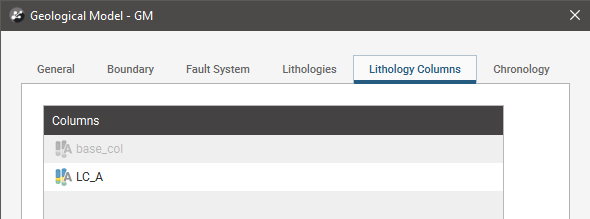

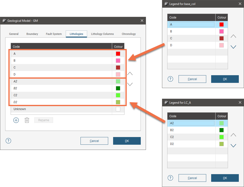

In this example, the geological model uses codes from the base lithology column (base_col) and a linked column (LC_A):
The lithology codes in both columns are unique, so when we look at the geological model’s lithology codes, we can see that the codes from both the base column (the red/pink codes) and the linked column (the green codes) appear in the model’s lithologies list:
When the base column is switched to an updated column that contains codes that are also in the linked column (codes A2 and B2), we can see how the base column’s lithology codes (red/pink) take priority over the linked column’s codes (green):

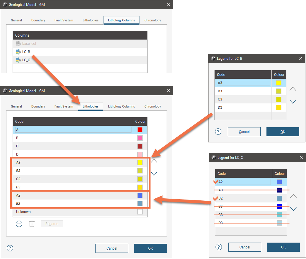

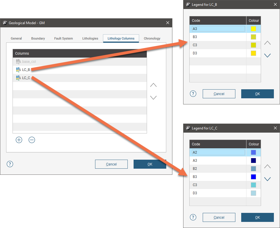

When you have more than one linked column, the order of the columns in the Lithology Columns tab is the priority each column has, with the first linked column having the highest priority.
In this example, there are two linked columns, LC_B (yellow codes) and LC_C (blue codes):
LC_C contains codes that are also in LC_B, codes A3, B3, C3 and D3. When LC_B has the higher priority, the model’s legend uses the codes from LC_B, ignoring the duplicate codes in LC_C:

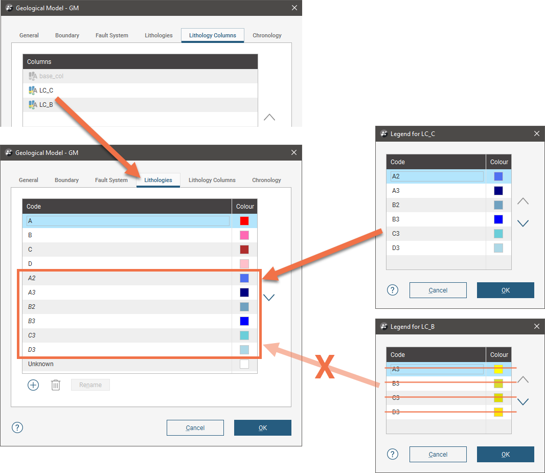

When LC_C has the higher priority, its codes are used in preference to those in LC_B. Because LC_B contains only codes that also exist in LC_C, none of LC_B’s codes are in the geological model’s lithology codes list:

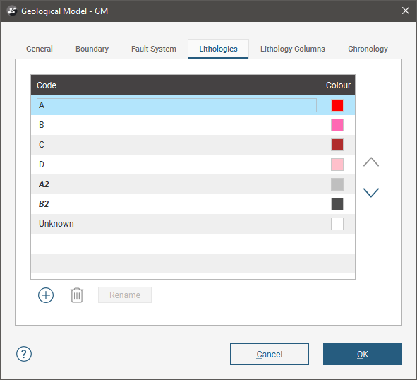

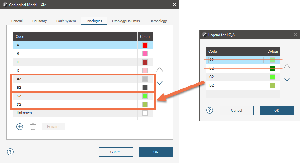

Manually defined codes are of lower priority than the codes from the base lithology column, but take precedence over codes from linked lithology columns. In this example, the geological model has the base lithology codes (A to D), plus two manually defined codes (A2 and B2):
When column LC_A is linked, two of its lithology codes (C2 and D2) are added to the geological model’s lithology codes, but A2 and B2 are not, because the manually-defined codes are of higher priority:

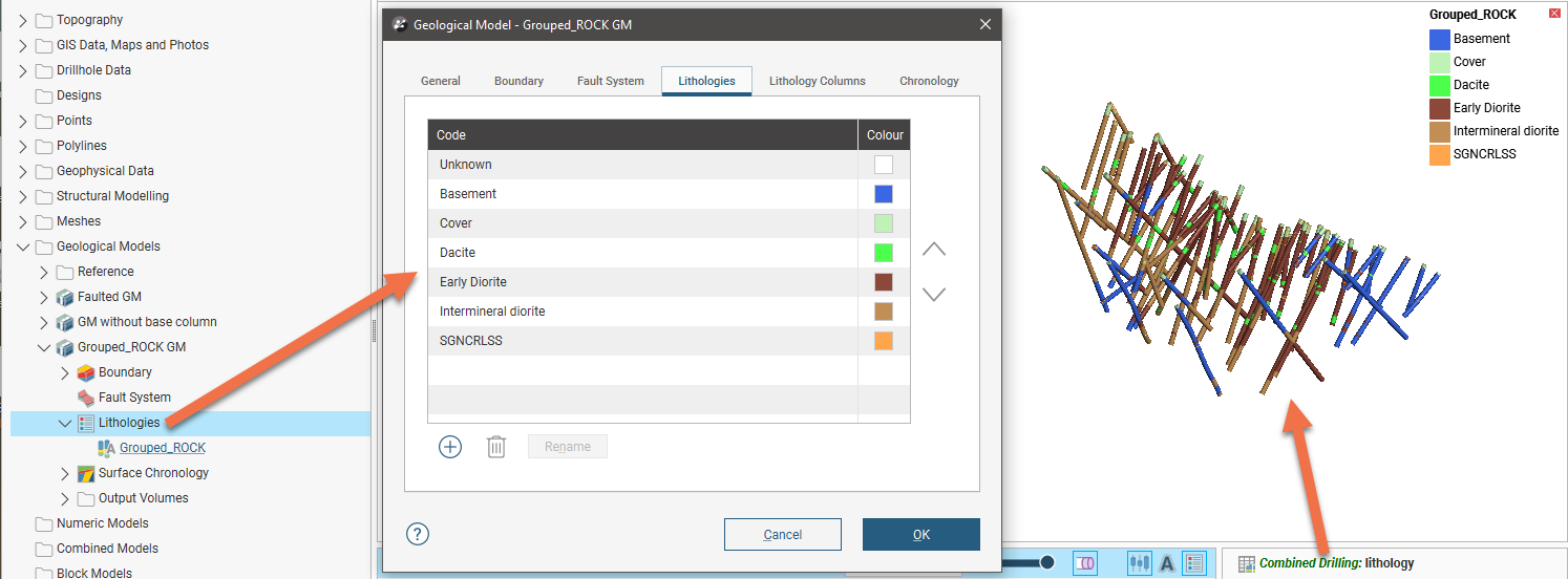

Lithology codes from the base lithology column and any linked lithology columns use the colours defined for the source data. For example, here we can see that the lithology codes and their colours match the Grouped_ROCK column’s lithologies, which are displayed in the scene:
The link goes both ways, and when you make changes to the colours used for geological model codes derived from lithology data, those changes will be made in the source data:
- If the colours used are changed in the geological model, the changes will also be made in the drilling data.
- If the colours used are changed in the source data, the changes will be reflected in the geological model.
Be careful in making changes to the colours used for codes that have been derived from drilling data, as you can inadvertently change colours that are used elsewhere in the project.

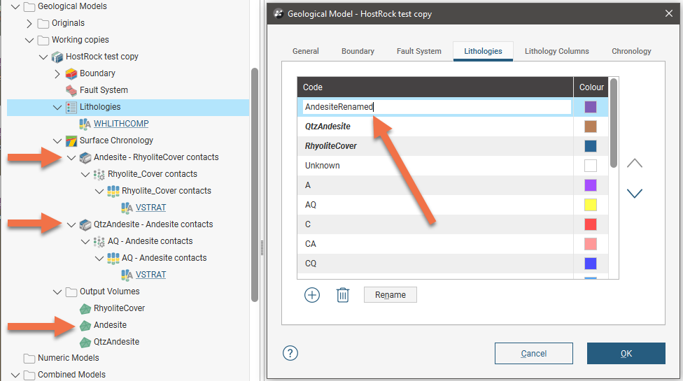

To rename a manually defined code, double-click on the code in the Lithologies tab or click on it, then on the Rename button. Enter the new name, then click the OK button to close the Geological Model window and process the change.

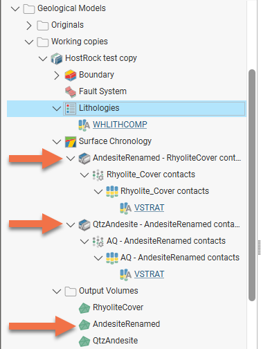

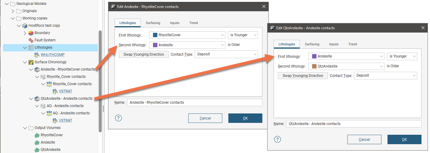

In this example, the manually defined code Andesite has been used in defining two contact surfaces and so is reflected in one of the output volumes:
Clicking OK updates the model, and the name change for the code results in the contact surfaces and the output volume also being updated:

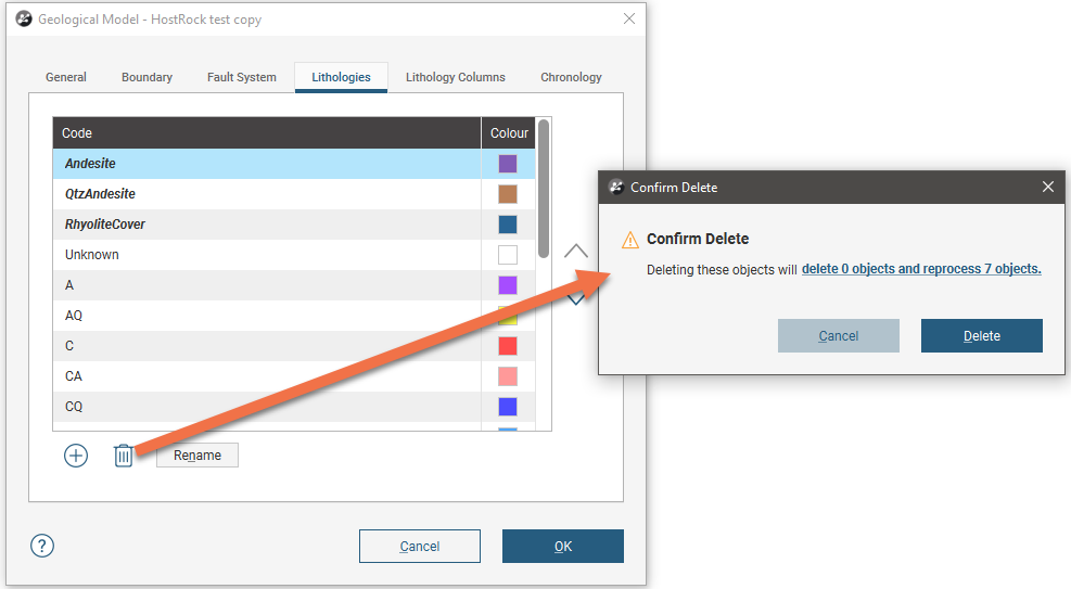

Deleting Manually Defined Codes
You cannot delete codes derived from the base lithology column or from linked lithology columns without removing those columns from the geological model, but you can delete manually defined codes.
To delete a manually defined code, click on it in the Lithologies tab, then click on the Delete button (
). If the code is not used in surfaces built for the geological model, the code will be deleted when you click on the Delete button; you will not be asked to confirm your choice.

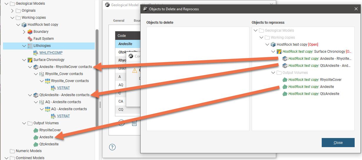

When you delete a code that is used in surfaces built for the geological model, a warning will be displayed:
Click on the link to see what objects are affected by the change and decide how to manage those changes before clicking Delete, then OK in the Geological Model window.
In this example, two contact surfaces use the Andesite code, which then flows through to the Andesite output volume:

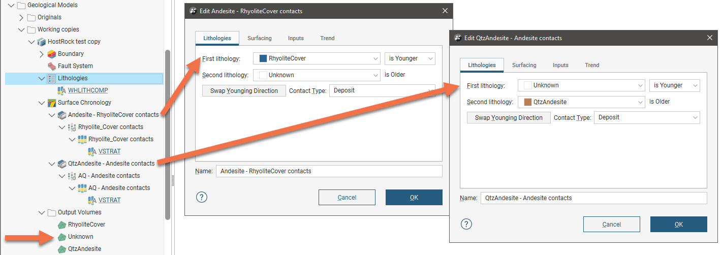

By double-clicking on each contact surface, we can see where the Andesite code is used:
Deleting the Andesite code from the Lithologies tab will result in the code being replaced by the code set as the Background lithology (in the Surface Chronology tab). In this case, the background lithology is Unknown, which is substituted for the deleted code in the contact surface windows:
Note also that there is now an Unknown volume in the Output Volumes folder.

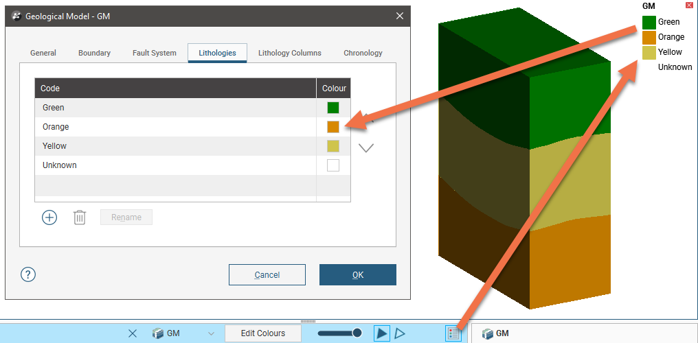

The order of the codes in the Lithologies tab is the order used for the model’s legend when the model is displayed in the scene:
