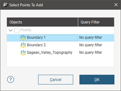

To create a new extent from points data, right-click on the Boundary object for the model you are working on and select New Lateral Extent > From Points or New Base > From Points. The Select Points To Add window will be displayed, showing points data available in the project:

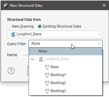

Planar structural data can be used to create a lateral extent or a base for a geological model. You can create a new structural data table or use a table that already exists in the project. If you want to use categories of structural data in creating the extent, use an existing table and create filters for those categories before creating the lateral extent.

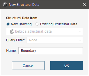

To start, right-click on the Boundary object for the model you are working on and select New Lateral Extent > From Structural Data or New Base > From Structural Data. The New Structural Data window will be displayed, showing structural data available in the project:
Click OK to generate the new extent. If you have chosen to create a New Drawing, the drawing controls will appear in the scene and you can begin drawing, as described in Structural Data. To share the new structural data table, right-click on it and select Share. The table will be saved to the Structural Modelling folder.

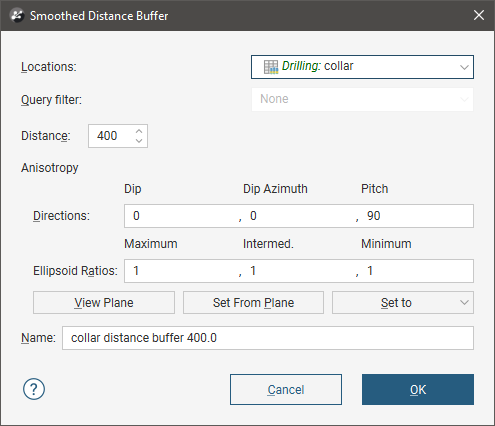

Leapfrog Energy can calculate the distance to set of points and use the resulting distance buffer as a lateral extent for a geological model. To create a new lateral extent from a distance buffer, right-click on the Boundary object for the model you are working on and select New Lateral Extent > From Distance To Points. The Smoothed Distance Buffer window will appear:
You can also use the Set to list to choose different options Leapfrog Energy has generated based on the data used to build the model. Isotropic is the default option used when the model is created.
To change the extent’s settings, expand the model’s Boundary object in the project tree and double-click on the extent. Adjust the Distance and Anisotropy, if required.
The resolution of extents is automatically inherited from the geological model. You can change the resolution for an extent if you want more or less detail than for the geological model as a whole. To do so, untick the box for Inherit resolution from GM and change the setting.

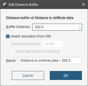

To change the extent’s settings, expand the model’s Boundary object in the project tree and double-click on the extent. The Edit Distance Buffer window will appear.

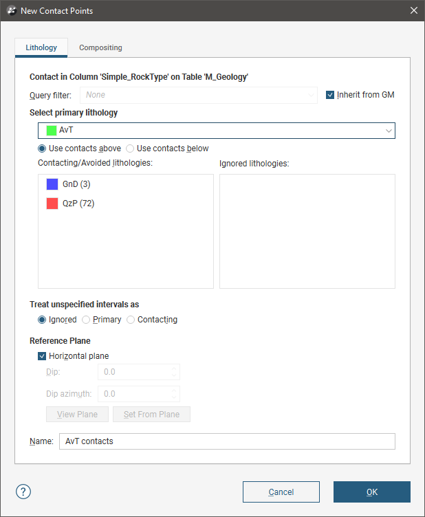

Base From Lithology Contacts
To create a base from lithlogy contacts, right-click on the Boundary object and select either New Base > From Base Lithology or New Base > From Other Contacts.
The only difference in the two methods is that when creating a base from other contacts, you must first select the lithology column from those available in the project.
When defining the base, select the primary lithology and the contacts to use:
For complex geologies, the up and down directions for the base may not be clear. If this is the case, untick the Horizontal Plane box. A reference plane will appear in the scene, with the up-facing surface labelled A and the downward-facing surface labelled B. Controlling the position of the reference plane is similar to controlling the position of the moving plane:
Click OK to create the base, which will appear under the Boundary object. The new base will automatically be added to the model.

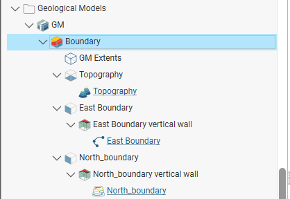

You can edit an extent using a polyline, which is described in Editing Surfaces With Polylines. A polyline used to edit an extent will be added to the project tree as part of the extent. To edit the polyline, right-click on it and select Edit Polyline or add it to the scene and click the Edit button (
) in the shape list. If you wish to remove the polyline from the extent, right-click on it in the project tree and select Delete or Remove.

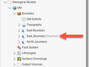

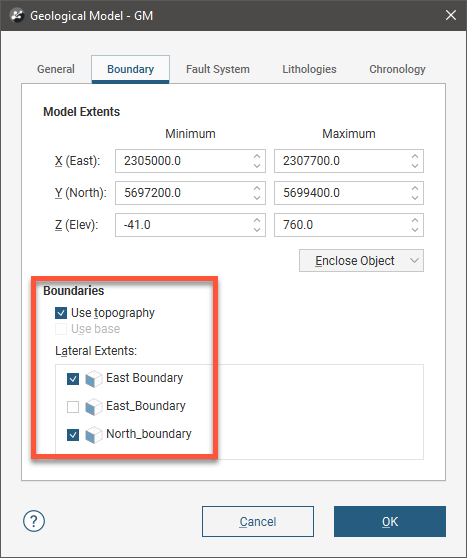

The second method is useful if you are making changes to the extent and do not want to recompute the model with each change. Double-click on the model’s Boundary object or double-click on the model and click on the Boundary tab. The Boundaries part of the window lists all objects used as extents for a geological model:
Untick the box for extents to temporarily disable them in the model. The model will be reprocessed, but you can then work on the extent without reprocessing the model. Disabled extents will be marked as inactive in the project tree:
