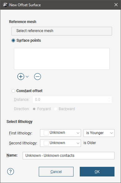

To start creating an offset surface, right-click on the Surface Chronology and select New Deposit/Erosion > From Offset Surface. The New Offset Surface window will appear:
In the window that appears, you need to select a reference mesh, then either select Surface points to offset to or set a Constant offset.
Click Select reference mesh to view the meshes available in the project.
If you wish to offset from the reference mesh using a fixed distance, click Constant offset and set the Distance. For Direction, selecting Forward offsets the surface on the younger side of the reference mesh, and selecting Backward offsets on the older side.
If you wish to offset to points, click Add. You can offset to:
- Base lithology contacts or other lithology contacts in the project.
- Other data in the project. GIS data, points data and polylines can be used.
If you offset to points, you will be able to set additional options such as distance limits once the surface has been created. See Changing Offset Limits below for more information.
Select the First Lithology and Second Lithology from the lithologies defined for the model. If you have added base lithology contacts or other contacts to the surface, these will be set automatically from the data used.
Click OK to create the surface, which will appear in the project tree as part of the Surface Chronology.

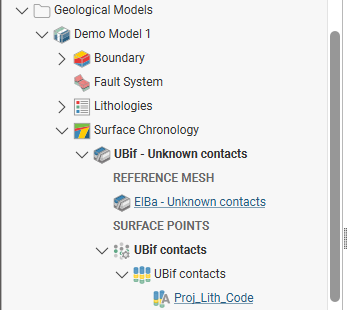

The Offset Surface in the Project Tree
The name Leapfrog Energy automatically assigns to an offset surface is the lithologies assigned to each side of the surface. In the project tree, expand the surface to see how it was made:
Double-click on the surface to edit it. Double-click on the contact points object (
) to edit the lithology and change compositing parameters.
As further refinements are made to the surface, that information will also be added to the project tree. See Refining an Offset Surface below for more information.

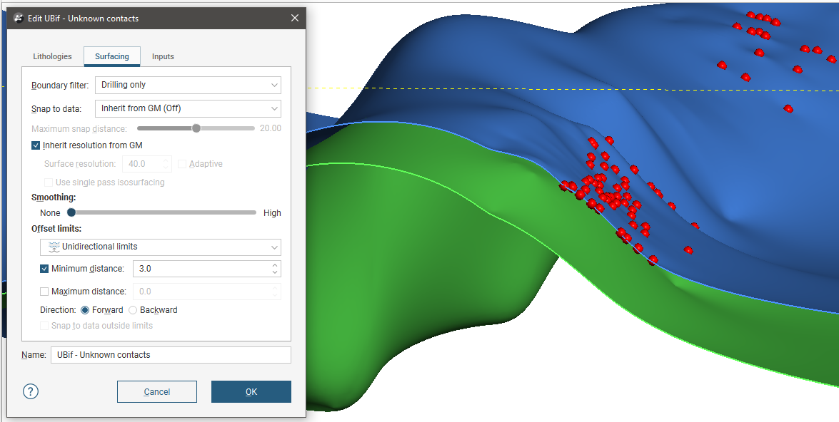

There are four options for Offset limits in the Surfacing tab. Three relate to offsetting to points and the fourth to offsetting to a fixed distance from the reference mesh.
- The None option is the default setting used when a surface is created as an offset to points. No distance limits are used in creating the offset surface, and it simply follows the points used.
- The Unidirectional limits option allows you to set distance limits in one direction. Points outside the limits will be disregarded.
- The Bidirectional limits option allows you to set distance limits in both directions, and points outside these limits are disregarded. This setting is useful for modelling folded surfaces such as veins.
- The Constant offset option offsets the surface to a fixed distance from the reference mesh.
The Forward direction is the younger side of the reference mesh.
If the Snap to data outside limits setting is enabled, the surface will honour data, even if it is outside the distance limits. This option will be greyed out if Snap to data is off.
