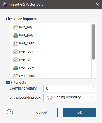

To import vector data, right-click on the GIS Data, Maps and Photos folder and select Import Vector Data. Navigate to the folder that contains the GIS data and select the file. You can select multiple files using the Shift and Ctrl keys.
Click Open to begin importing the data.

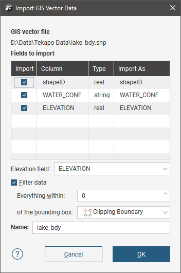

If you are importing a single file, the Import GIS Vector Data window will show a summary of the data in the selected file:
You can choose what field in the data to use for the Elevation Field from the list.
If you are importing multiple files, all files being imported are listed in the Import GIS Vector Data window and no summary of each file is displayed:
Click OK to add the data to the project.
If the file contains spatially coincident points, a warning will be displayed, along with the ID for each duplicate row.

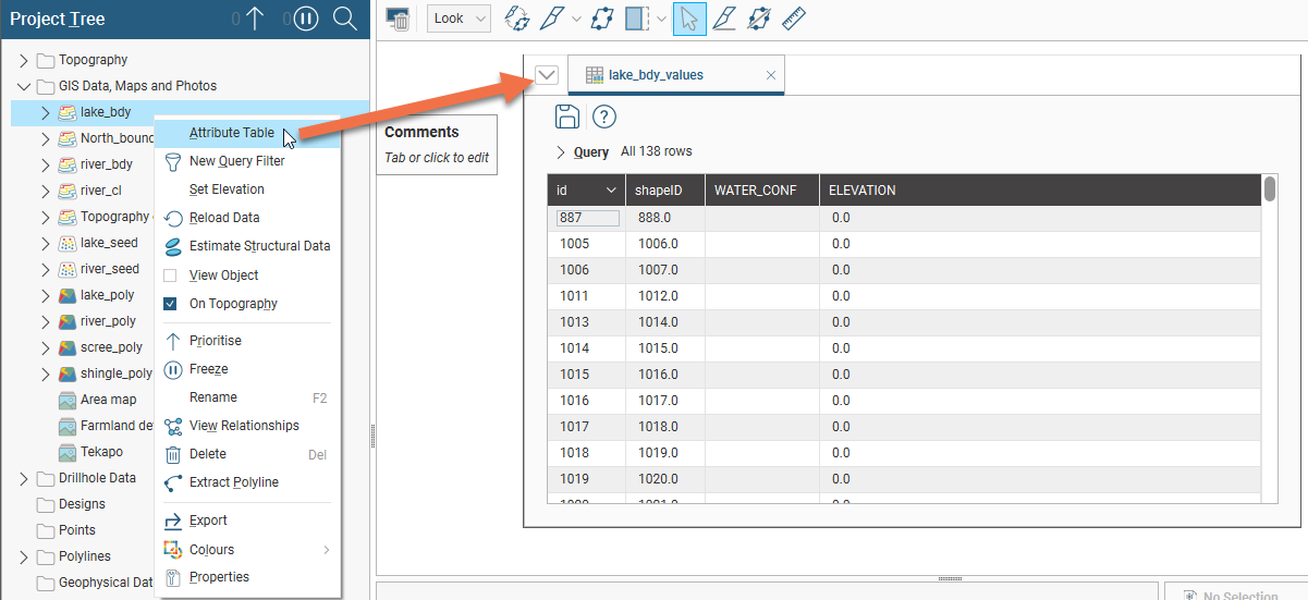

The object or objects will appear in the project tree under the GIS Data, Maps and Photos folder. You can then view an object’s attributes by right-clicking on it and selecting Attribute Table. If a topography has been defined for the project, you can drape imported GIS data on the topography, as described in Draping GIS Data on the Topography below.

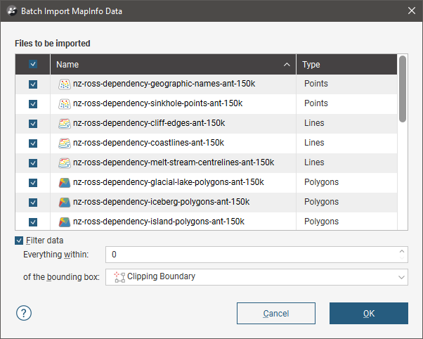

To import GIS data in this way, right-click on the GIS Data, Maps and Photos folder and select Batch Import > from MapInfo. In the window that appears, navigate to the folder that contains the MapInfo batch file, which is an XML file. Click Open.
Click OK to import the selected files, which will be added to the GIS Data, Maps and Photos folder as a group (

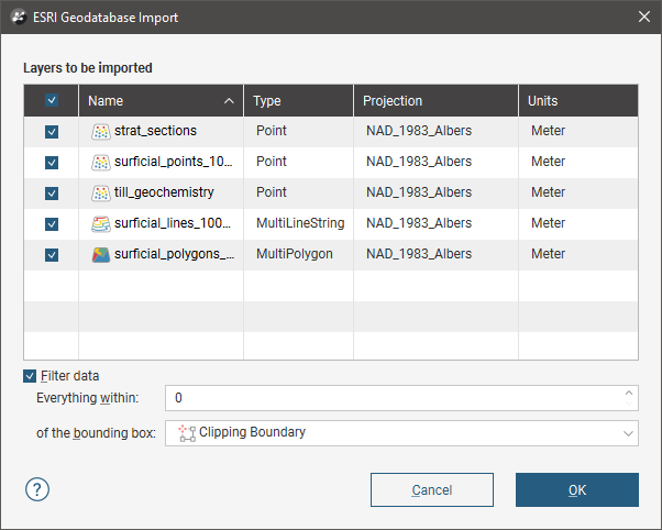

To import GIS points, lines and polygons in this way, right-click on the GIS Data, Maps and Photos folder and select Batch Import > from ESRI Geodatabase. In the window that appears, navigate to the folder that contains the database folder (*.gdb) and click Open.
Leapfrog Energy imports uncompressed ESRI geodatabases.
). Data in the group can be reloaded individually or as a group, which is described in Reloading GIS Data.

You can view the attribute table for most GIS data objects by right-clicking on the object and selecting Attribute Table.

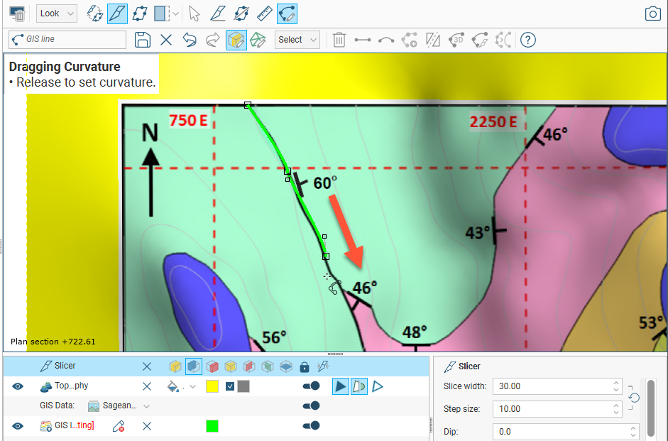

GIS lines can be drawn on the slicer or on a surface.
Right-click on the GIS Data, Maps and Photos folder and select New GIS Line > From New Drawing. In the window that appears, enter a name for the new object and click OK.
The object will be created in the project tree and added to the shape list. The scene view will change to view the objects in the scene from above and tools for drawing polylines will appear. Click on the Draw lines button (
) and start drawing in the scene, as described in Drawing in the Scene.
When you have finished drawing, click the Save button (
). The new line (
) will be saved in the project tree.
You can edit the GIS line by right-clicking on it in the project tree and selecting Edit. If it is in the shape list, you can edit it by clicking on the Edit button (

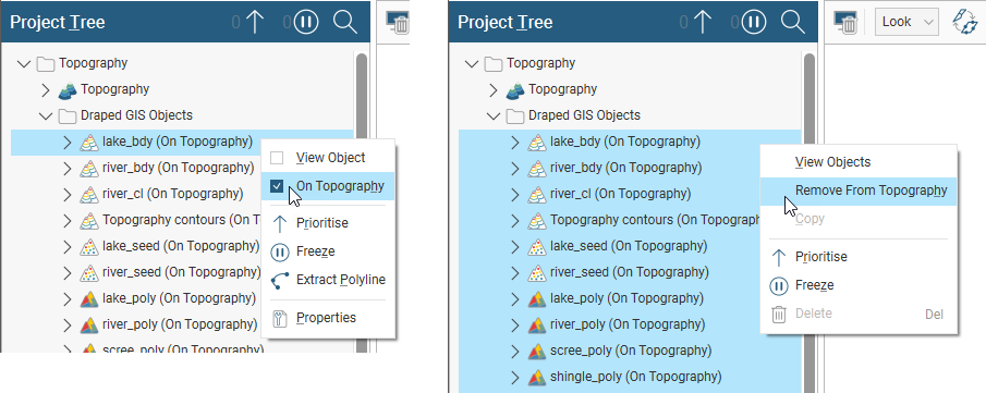

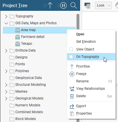

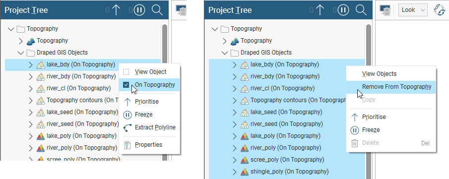

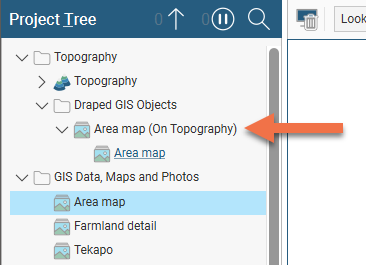

GIS data in the project can be draped on the topography. To do this, right-click on an object in the project tree and tick the On Topography box:
The draped version of the data object will be added to the Draped GIS Objects folder under the Topography folder:

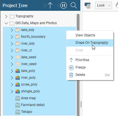

You can drape multiple GIS data objects and/or images on the topography in one action by using the Shift and Ctrl keys to select the objects you wish to drape, then right-clicking on them and selecting Drape On Topography:
To remove an object from the topography, right-click on either it or its draped copy in the Draped GIS Objects folder and untick the On Topography box. For multiple objects, select Remove From Topography.

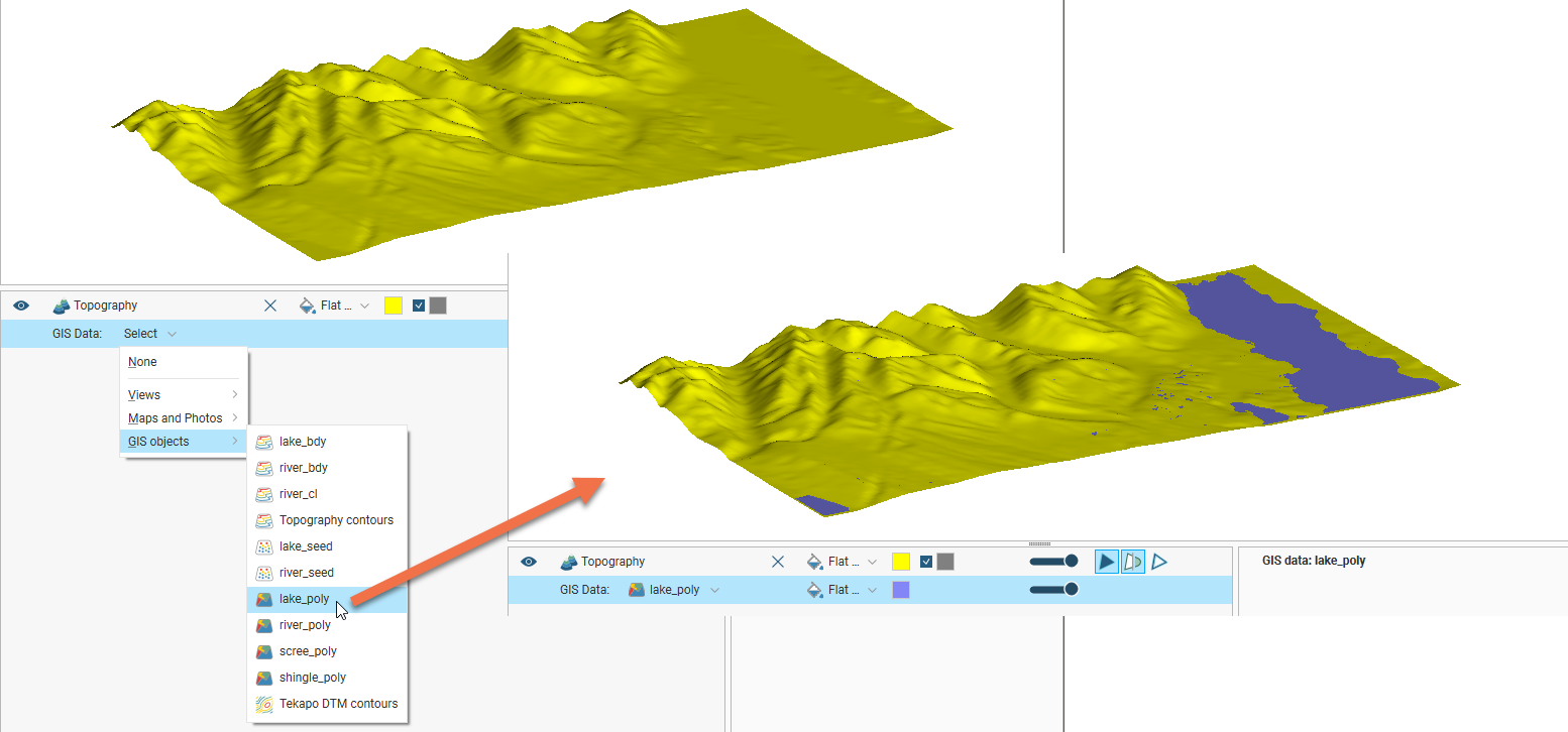

To display GIS using the topography’s elevation data, first drape the data object on the topography as described in Draping GIS Data on the Topography above.
Next, add the topography to the scene and in the shape list, click on the topography’s GIS Data list. Select the object you wish to view from the GIS objects submenu:

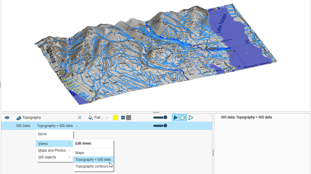

Displaying GIS Data in Custom Topography Views
With custom topography views, you can display multiple GIS data objects along with images and contours draped on the topography. For example, here GIS data is displayed with a map:

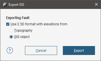

To export GIS data, right-click on the GIS data object in the GIS Data, Maps and Photos folder and select Export. The Export GIS window will be displayed:
Select whether elevation information will come from the topography or from the GIS object itself, or untick the Use 2.5D format with elevations from box to export the object without elevation information.
Click Export. You be prompted for a filename and location.
