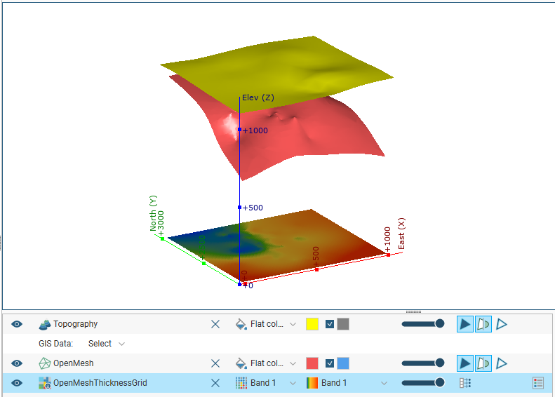

What is calculated for the thickness grid is not the true thickness but is the vertical thickness at each location. The process is as follows:
- Leapfrog Energy generates a regular grid of points directly above the selected surfaces.
- The points are projected down onto the top surface, then onto the lower surface.
- The distance is calculated between the pairs of points and used to produce a thickness grid that sits at zero elevation with values representing the distance between points.

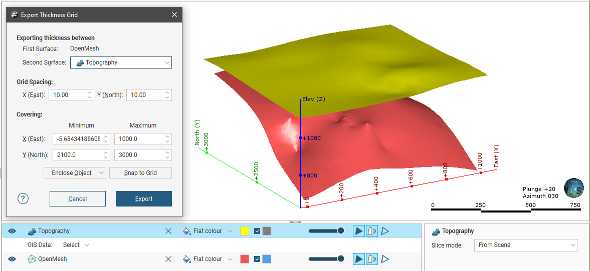

In this example, a thickness grid is exported for an open mesh and the topography:
When the exported grid is imported back into Leapfrog Energy, we can see that the values on the grid represent the vertical distance between the selected surfaces:

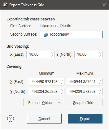

To export a thickness grid, right-click on the mesh and select Export Thickness Grid. The Export Thickness Grid window will appear:
Select a second surface and set the grid spacing and covering.
Click Export. You will be prompted to choose the file format and for a filename and location.
