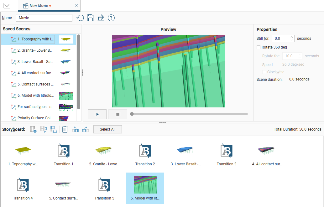

To create a new movie, right-click on the Saved Scenes, Movies and Markers folder and select New Movie. A tab will open in which you can create a storyboard and edit how each scene and transition is displayed. You can detach the tab from the main window and create scenes in the main window while working on scenes in the movie tab. Click the Refresh Scenes button to refresh the scenes in the movie tab when you have made changes.
Select the saved scenes you wish to add to the movie by clicking on them in the list, then click the Add To Storyboard button (
). When subsequent scenes are added, transitions will be added to separate the scenes:
Change properties for the selected scene or transition, then click the play button (
) to preview the settings. To preview the whole movie, click the Select All button then click play.
You can make changes to the included scenes without having to close and reopen the movie window. Simply update the scenes, then, in the movie editor, click the Refresh Scenes button.
Enter a name and description for the movie and click the Save button (
). The movie will be saved in the Saved Scenes, Movies and Markers folder.
