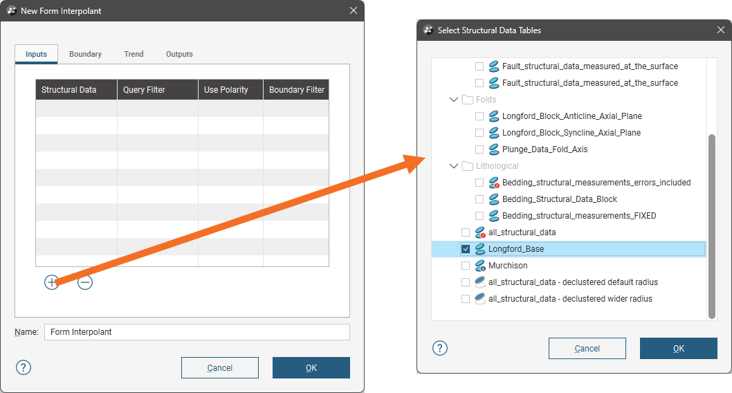

To create a form interpolant, right-click on the Form Interpolants folder (in the Structural Modelling folder) and select New Form Interpolant. In the window that appears, click the Add button (
) to add structural data tables to the interpolant:

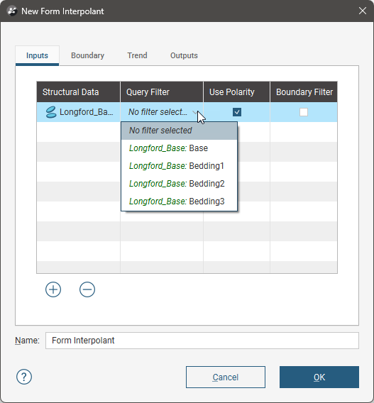

Data can be filtered using the query filters defined for the selected structural data tables:
Once you have created the interpolant, you can easily add and remove structural data tables and change the filtering.
When generating the form interpolant, you can use the tangents and polarity or only the tangents. To use both, leave the Use Polarity box ticked. To use only the tangents, untick the box.
The Boundary filter setting determines how data is handled when it lies outside the interpolant’s boundary:
- Boundary filter enabled. The interpolant is only influenced by the data that falls inside the boundary.
- Boundary filter disabled. The interpolant is influenced by the data both inside and outside the boundary.

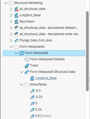

In the project tree, the form interpolant contains objects that represent different parts of the interpolant:
- The Extents object (
) represents the interpolant’s boundary settings, from the Boundary tab. - The Trend object (
) describes the trend applied in the interpolant. For more detailed information on setting a global trend, see the Setting a Global Trend topic. - The structural data object (
) contains a link to the data used in generating the interpolant. See Form Interpolant Statistics for more information. - The Isosurfaces folder contains the isosurfaces (
) defined in the Outputs tab.

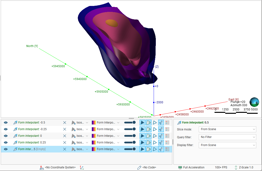

To display the form interpolant, you can:
- Drag the interpolant into the scene.
- Right-click on the interpolant and select View Isosurfaces.

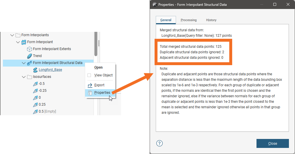

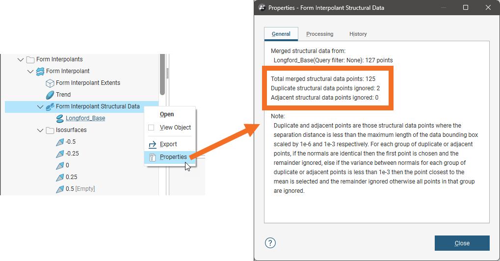

To view information about the data used for the form interpolant, right-click on the structural data object (
) under the interpolant and select Properties:
The General tab includes information about how the data has been declustered.
You cannot change how data is declustered in the form interpolant, but if you wish to have more control over this, create a declustered structural dataset and use it as the input for the form interpolant. See Declustering Planar Structural Data for more information.
