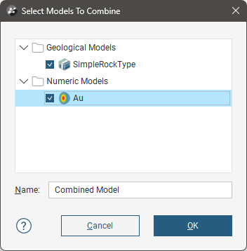

To create a combined model, right-click on the Combined Models folder in the project tree and select New Combined Model. In the window that appears, select the models you wish to combine, then click OK:
Once you have created a combined model, you cannot edit it to add new models or remove existing ones.

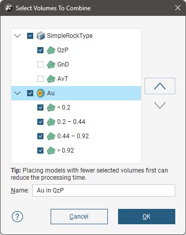

The next step is to select the output volumes to use in the combined model and arrange them in order of priority. For this combined model, the QzP volume from the selected geological model will be subdivided using information from the Au interpolant:
If you are using a distance buffer with concentric buffers, you will be able to select only one volume.
Click OK to generate the model, which will appear in the project tree in the Combined Models folder.

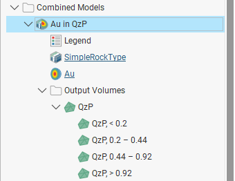

In the project tree, the combined model includes hyperlinks to the models used to create the combined model:
Changes made in the original models will be reflected in the combined model.

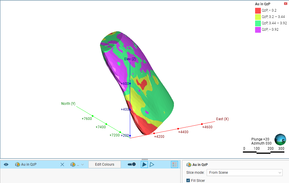

Add the model to the scene to view the results:
To change the colours used to display the model, double-click on the Legend object (
). In the window that appears, click on the colour chip for each category and change it as described in Single Colour Display Options.
To set multiple categories to a single colour, use the Shift and Ctrl keys to select the colour chips you wish to change, then click on one of the colour chips. The colour changes you make will be made to all selected categories.
