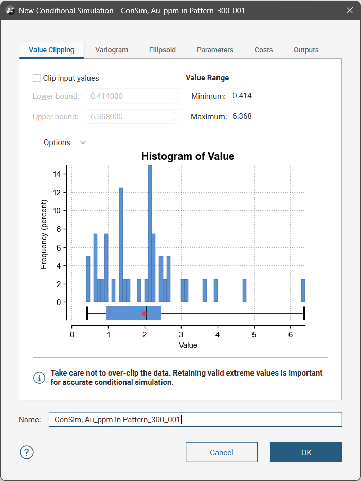

Value Clipping
Use the Value Clipping tab to constrain the data values used in the dataset, discarding outliers. In most cases it should not be necessary to clip values.
Not overclipping data is important for accurate conditional simulation as extreme valid values are relevant to the simulation. Correct statistical reproduction of high grade values is of critical importance. Instead of clipping off outliers, all the data should be retained unless there are sound reasons for clipping input values.

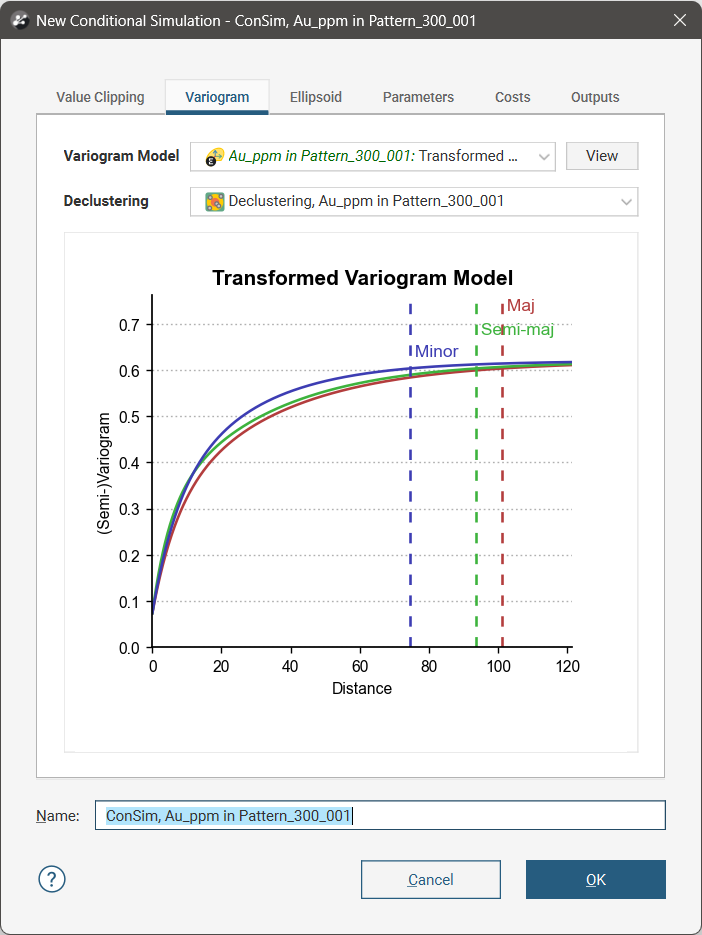

In the Variogram tab, select the transformed variogram model and the declustering object to use in the conditional simulation.
Leapfrog Energy does not enforce that normal score variograms have a sill of 1. In general, if a variogram stabilizes at a different value, it is an indication that the domain is not stationary.
If the selected transformed variogram has a total sill less than 1, conditional simulation will normalise the variogram, rescaling the transformed variogram so that the total sill is equal to 1. This is to guarantee accuracy of the conditional simulation result, as without the rescaled function there is a risk of high-grade values not being reproduced in the outputs.

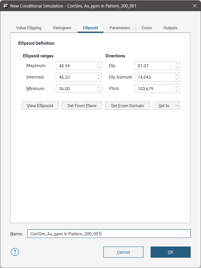

Ellipsoid
The Ellipsoid tab defines the primary anisotropic search volume size and orientation. Neighbourhood samples will be selected from within this search volume.

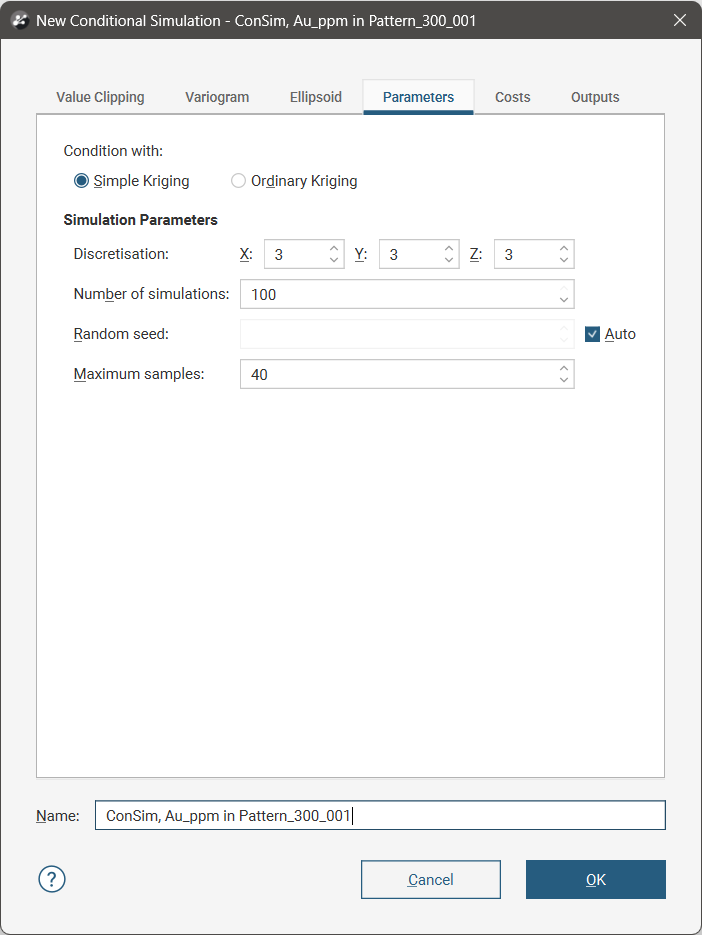

The Parameters tab contains additional parameters relevant to the conditional simulation.
Two options are provided to Condition with: Simple Kriging and Ordinary Kriging.
Simple Kriging is the default option, and should be the preferred selection. Conditional simulation is a global method that makes a strong assumption of stationarity. Simple Kriging requires a similarly strong assumption. Simple Kriging calculates weights for local samples based on the variogram, and also includes a term for the weight given to the mean. As the relevance of local samples decreases and as the samples become less correlated to the target, the weight attached to the mean correspondingly increases. As a result, simulated grades revert towards the mean away from sampling. Beyond the range of influence of the variogram, simulations revert to non-conditional with an expected value that is the declustered mean of the dataset.
Ordinary Kriging is provided as an option in case locally precise results are preferred despite higher variability and the risk of potential bias. The mean reverting behaviour of simple Kriging may contradict the expected behaviour of grades in the real world, and the results can be visually jarring. When this is the case, it may be preferable to condition simulations with ordinary Kriging, which assumes that the neighbourhood samples inform the local mean adequately. However, the reproduction of the variogram may be distorted, as the simulated grades will incorporate trend, which can artificially inflate spatial variance. A simulation conditioned by ordinary Kriging will revert to non-conditional when no samples are found inside the search ellipsoid. When using ordinary Kriging, use a search that is large enough to ensure that peripheral blocks still find a sufficient number of neighbours.
Simple Kriging should be preferred over ordinary Kriging as ordinary Kriging can lead to higher variability and potential bias.
When assessing variogram reproduction, focus on the reproduction at ranges shorter than the variogram range.
Discretisation sets the number of discretisation points in the X, Y and Z directions. To take account of block support, each block is broken down (discretised) using a point grid for each block for simulation, before averaging point values back up to the block scale. When specifying a discretisation grid, there should be sufficient nodes per block to produce a reliable estimate of the average grade in the block per realisation.
The point grid is a transient data object and is not preserved. The simulated values for each point are not retained.
Set the X, Y and Z parameters to 1 for no discretisation, with a single centroid point per block.

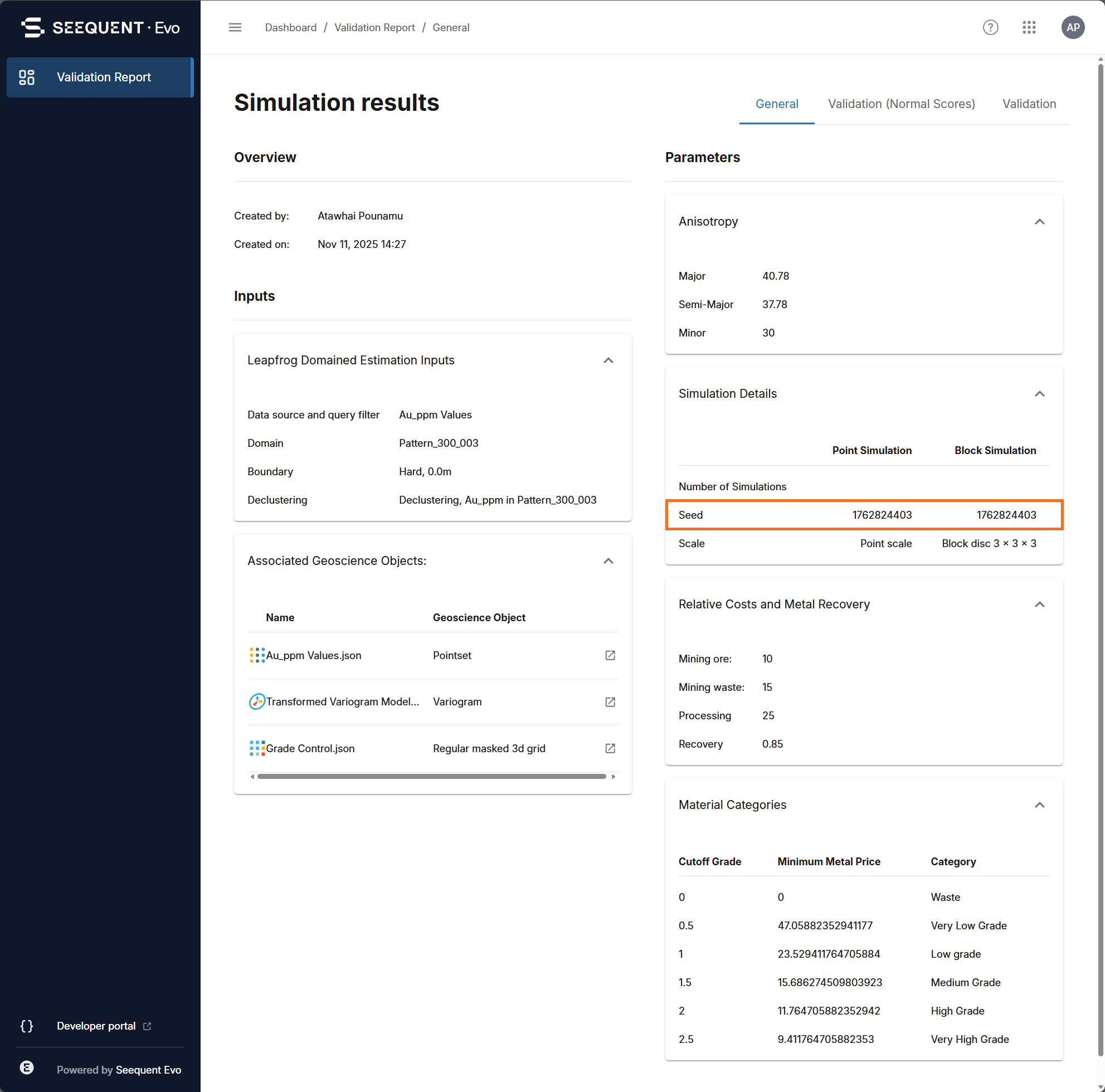

Choose the Number of simulations to be generated. The maximum of 100 is also the default option.
You can specify a Random seed value to be used by the pseudo-random number generator used in the simulation. If you leave the Auto box ticked, each time the simulation is run, different values will be created by the pseudo-random number generator and the simulations will exhibit effectively random variations between simulations. However, if you need reliably repeatable results across simulation executions, this can be forced by specifying a fixed Random seed value.
If you need to repeat a simulation that has already been run using an Auto random seed, look in the validation report to find the seed that was used and enter that seed value into Random seed for subsequent executions.
The Maximum samples threshold limits the number of samples used in a search neighbourhood. The maximum number of samples used in a neighbourhood is the sole parameter exposed for operational control that is associated with the Turning Bands algorithm. When compared with the Sequential Gaussian Simulation method, Turning Bands is less sensitive to the neighbourhood, i.e. to the number of initial samples included in the search relative to the number of previously simulated nodes. What is being estimated with Turning Bands during the conditioning step are the residuals between the actual data at sample locations and the simulated values at sample locations.
The default value has been selected to be a reasonable value to use in most cases. As a general principle, variogram models with low continuity can be conditioned with a larger neighbourhood, while models with high continuity will require fewer neighbours for conditioning. However, test alternative values before committing, as the results of changing the number of maximum samples can be counter-intuitive.

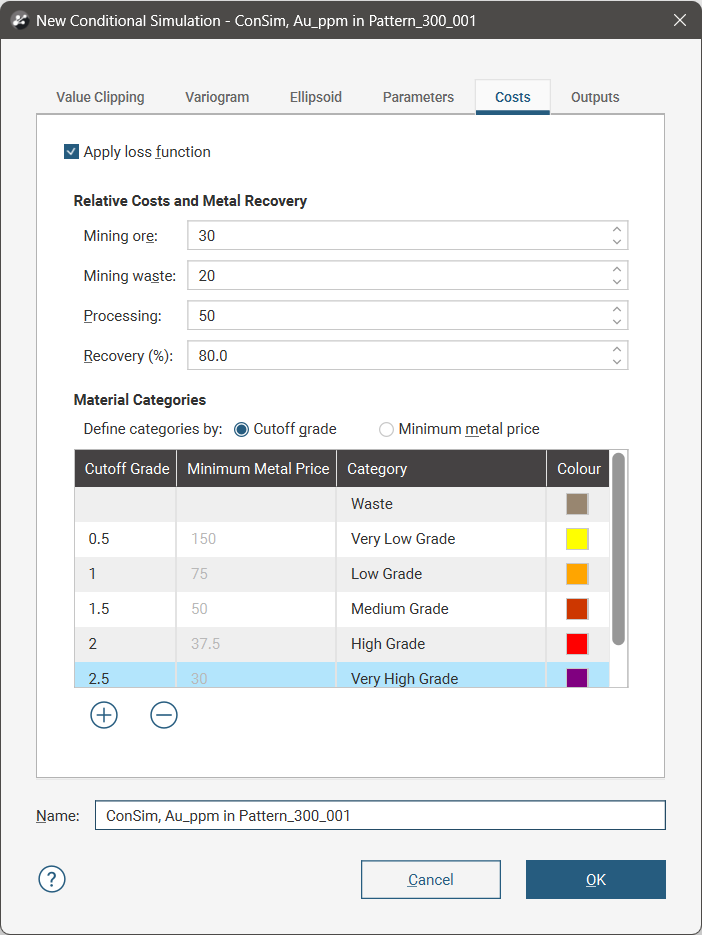

Costs
In an open pit mine, all material must be moved and therefore a choice must be made about the destination of all material: run of mine ore, stockpiles or waste. We cannot know in advance the actual grade of any block and must base decisions on an estimate. Those estimates are always imperfect, and so there is the inevitable risk of misclassification:
- Rock that is actually ore may be sent to the waste dump.
- Rock that is actually waste may be sent to the mill.
Both these types of misclassification result in loss, but the losses incurred are asymmetric: the economic loss resulting from sending ore to the waste dump is not the same as the loss from sending waste to the processing plant.
There is also uncertainty about the actual grade of the block, but the magnitude of loss incurred depends on actual grade.
An economic classification function is used to account for both this asymmetry in losses and also the underlying uncertainty in grade. This is achieved by applying a loss minimisation function to all realisations of a simulation ensemble.
In the Costs tab, enable Apply loss function to add profitability to the simulation.
Set the specific cost values for Mining ore, Mining waste, and ore Processing, using the currency and units of mass used in the project, e.g. USD$25/tonne. The expected Recovery percentage from processing is also needed.
There are two options for Material Categories:
- Cutoff grade. Category classifications are defined based on grades.
- Minimum metal price. Category classifications are defined based on minimum metal price. Prices used will depend on the units used in estimation, e.g. if commodity grades are estimated in g/t then the commodity price should be expressed in $/g; if commodity grades are estimated in %, then the commodity price should be expressed in $/t.
Click the Add button (
) for a new table row in which a Category can be identified along with the associated Cutoff Grade or Minimum Metal Price. Click the colour chips to change the associated colour for the category, if required.

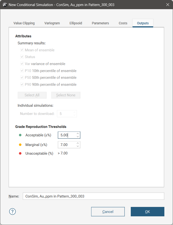

Outputs
Conditional simulation will always produce a collection of results per block:
- Mean of ensemble. The geometric mean across the simulated result values.
- Status. Simulated blocks will have a Status of Normal.
- Var (variance of ensemble). The statistical variance across the simulated result values.
- P10 (10th percentile of ensemble). The statistical 10th percentile point in the simulated result values.
- P50 (50th percentile of ensemble). The statistical 50th percentile point in the simulated result values.
- P90 (90th percentile of ensemble). The statistical 90th percentile point in the simulated result values.
If the dataset has a normal distribution, P50 is the same as the median value, but P50 is the preferred measure for central tendency when the distribution is not normal or not known.
Under Individual simulations, the Number to download identifies that 5 simulations will be returned for inspection from the Evo processing service. This value is not editable. The simulations returned will be randomly selected from the ensemble, although the name assigned will always be sequentially numbered to simplify the use of these realisations in user-defined calculations.
The Grade Reproduction Thresholds are used to assess the resulting simulations, based on acceptable, marginal and unacceptable ranges. You can change the thresholds that define these ranges to suit your organisation’s tolerance. The resulting grade will be indicated by a coloured dot on each conditional simulation report in the project tree.
- Green. The percentage difference is below the acceptable threshold.
- Orange. The percentage difference is between the acceptable threshold and the marginal threshold.
- Red. The percentage difference is beyond the marginal threshold.

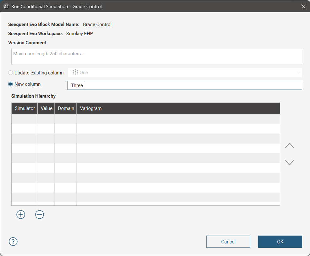

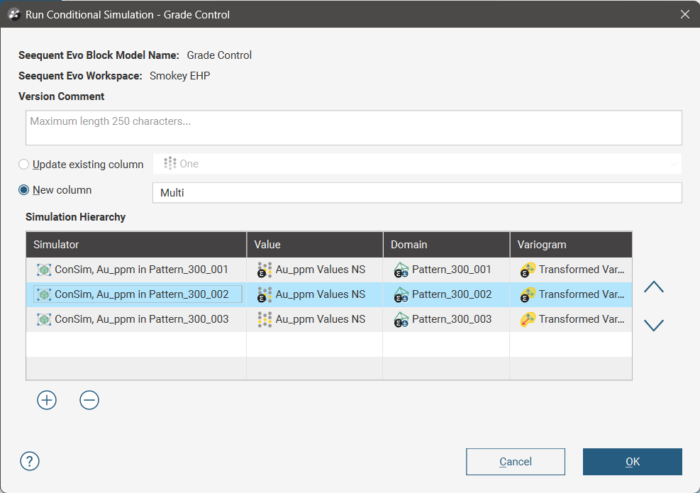

Running a Conditional Simulation
Creating a conditional simulation estimator does not run a conditional simulation; it is just the first step. The next step is to run that conditional simulation on a block model.
To run a conditional simulation, right-click on a regular block model in the project tree and select Run Conditional Simulation.
Conditional simulation is not supported for octree sub-blocked models, fully sub-blocked models, or variable-z block models.
If the block model has not already been published to Seequent Evo, an error message will appear. Otherwise, the Run Conditional Simulation window will appear.
You can supply a Version Comment that will be recorded against the BlockSync version of the block model that running the conditional simulation will produce.
If you choose Update existing column, the conditional simulation run will replace the data for the column you select. Alternatively, you can select New column and provide a name for the new column to be created by the run.

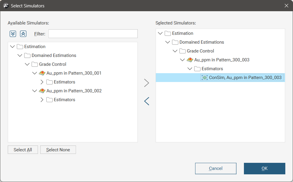

Click the Simulation Hierarchy list Add button (
) to open the Select Simulators window, where you can add predefined conditional simulation estimators to the Selected Simulators list:
Once added to the Simulation Hierarchy, you may reorder the simulations using the
and
arrows.
When you click OK, Leapfrog Energy will connect to Seequent Evo computation services to access cloud resources and run the simulation computations. How long this process takes will depend on the number of points in the dataset. Progress will be shown in the Leapfrog Energy processing queue.

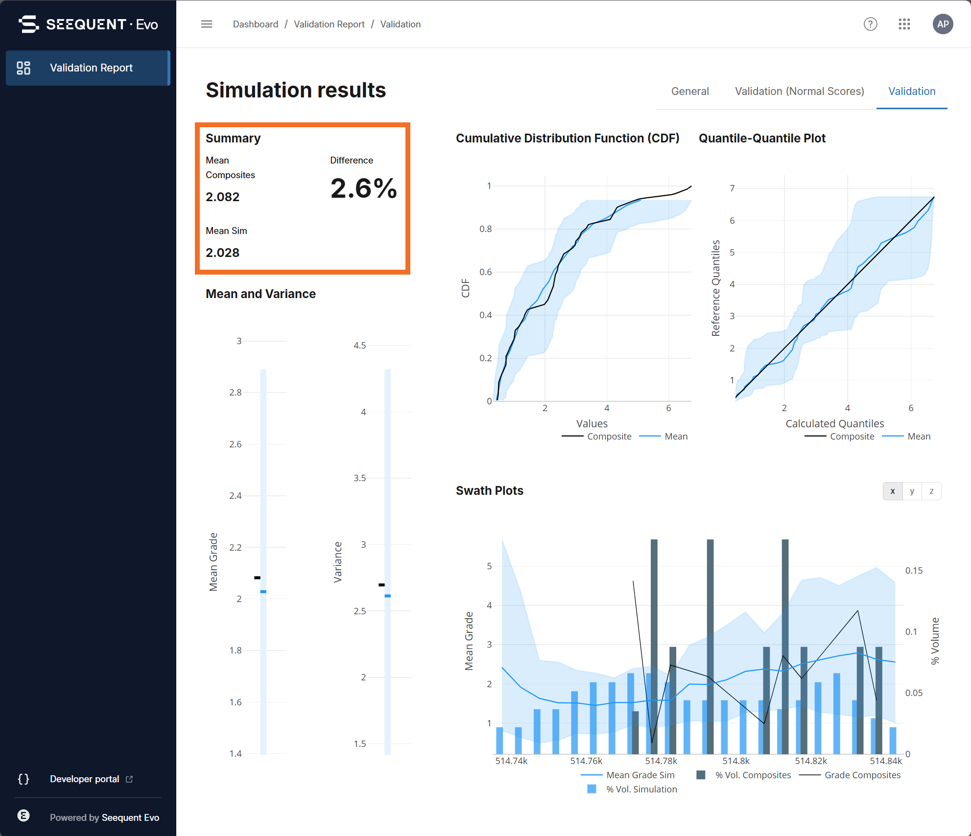

When the main Turning Bands block conditional simulation is being executed, there will also be a simultaneous execution of a sub-set of validation simulations.
In this validation task, a set of point scale simulations are created on the centroids of the target block model, and these are used to validate the reproduction of the input distribution (using summary statistics and continuous distribution function plots) and the variogram in normal score space.

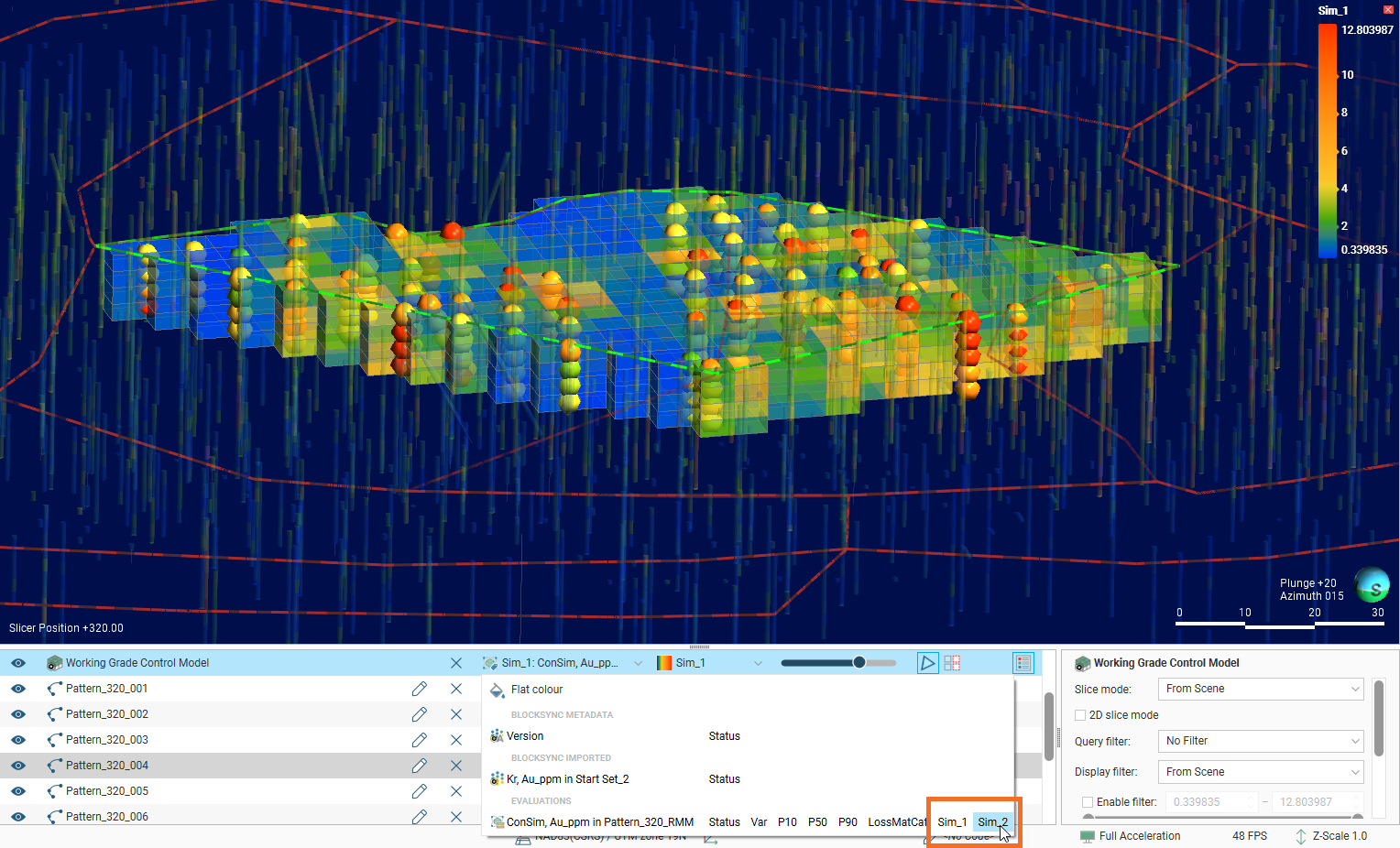

Return Simulation Outputs to Block Model
Once the simulation process is complete, simulation outputs are returned back into the Leapfrog Energy block model as a new set of columns.

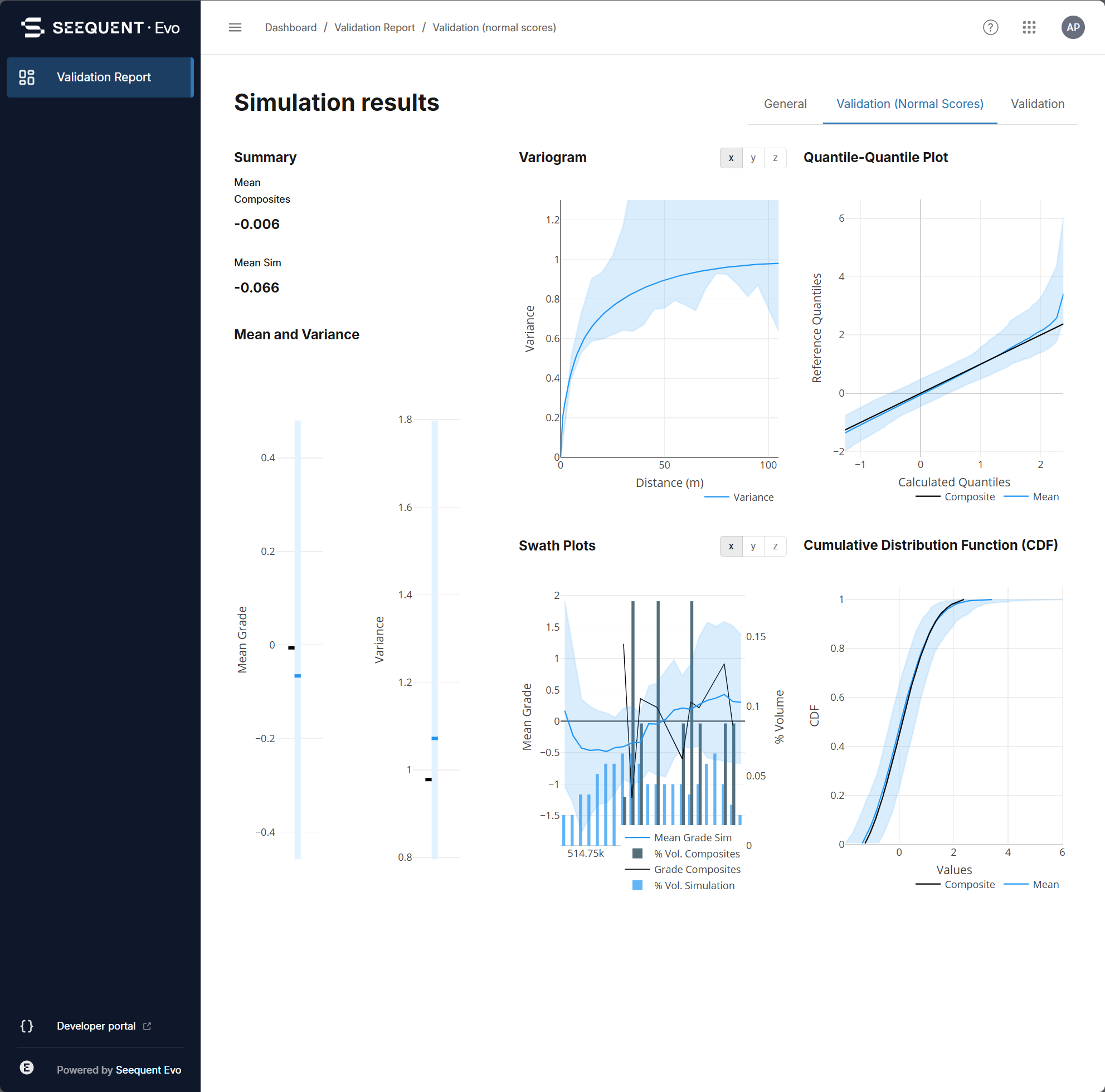

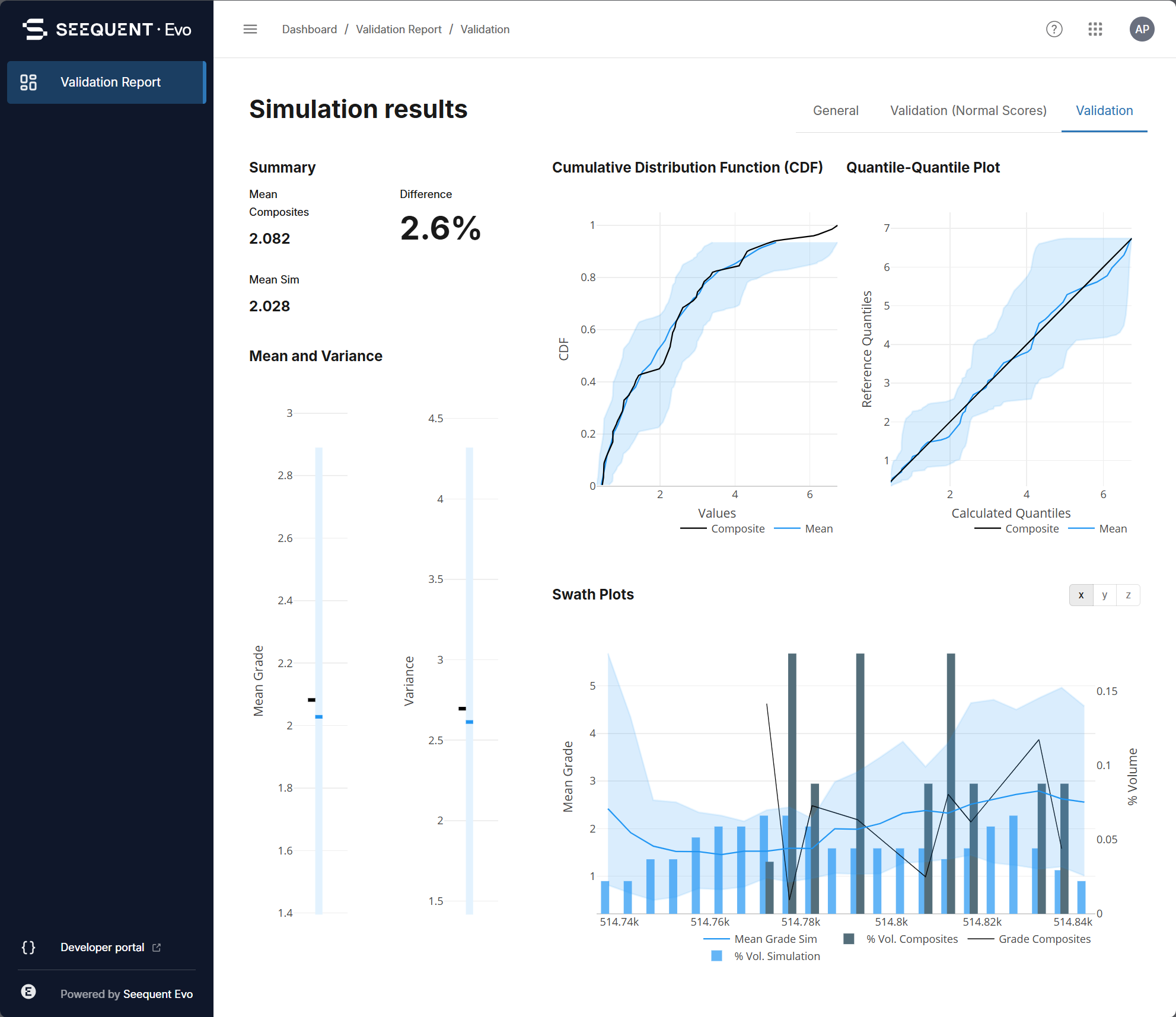

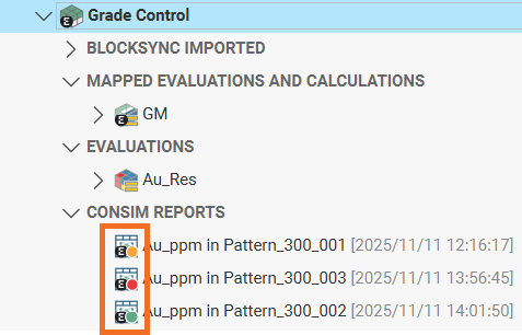

Present Validation Report
When the conditional simulation run is completed, each of the simulations in the Simulation Hierarchy will result in a report that will appear under the block model in the project tree, organised into the Consim Reports section.

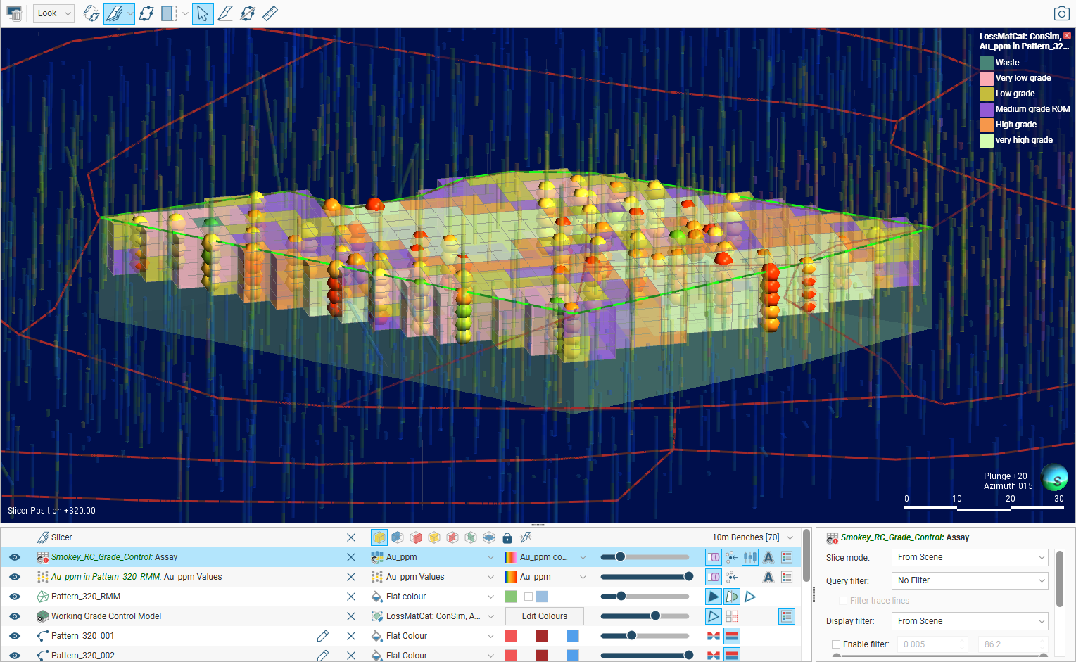

Reviewing Conditional Simulation Results

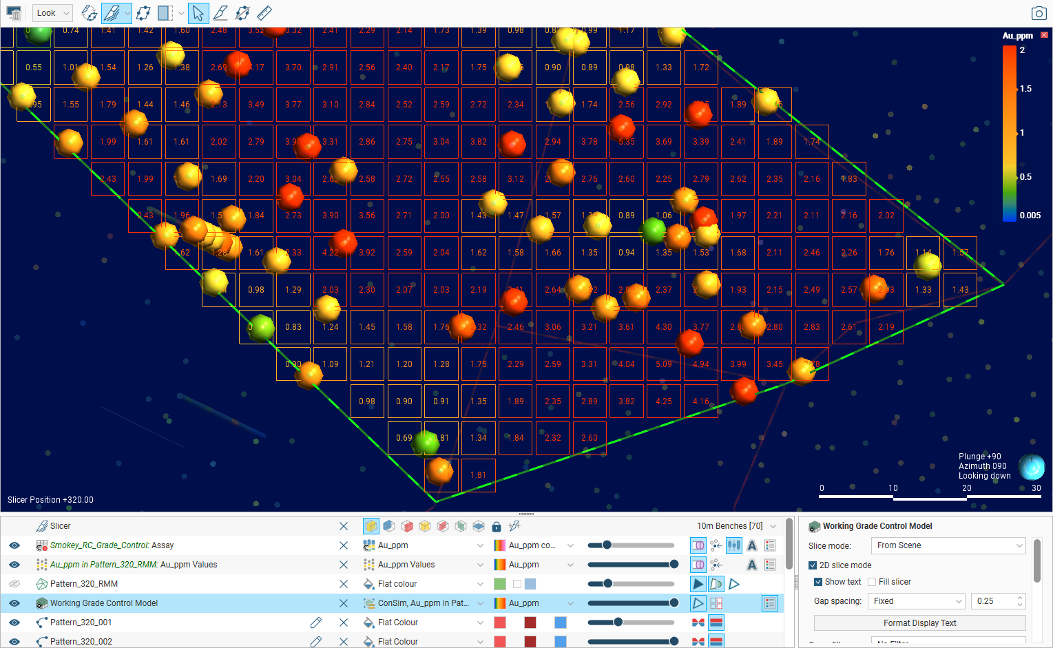

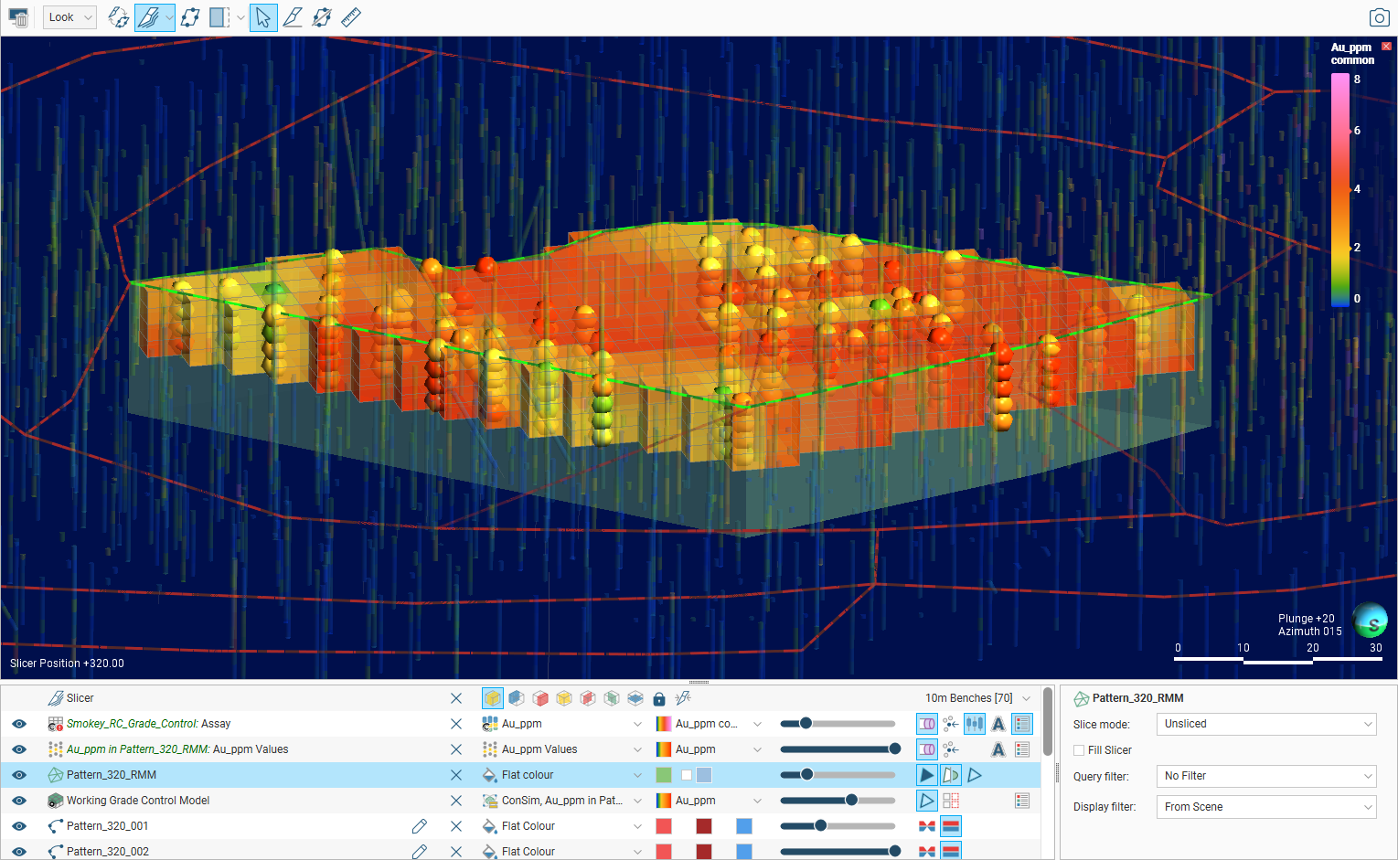

Review the resultant grade estimate in the scene alongside the input sample values:
You can also review the calculated loss function value categories for optimum material classification based on the grade uncertainty:
You may find it useful to view the block model in 2D with text labels:
We recommend using shared colourmaps for standardisation and clear communication. For more, see Colour Options in the Visualising Data topic.
Viewing Validation Reports
Validation reports generated from a conditional simulation will be added to the block model in the project tree under the heading Consim Reports. Right-click on a report and select Open in Seequent Evo to open it in your browser:
There are three tabs at the top right of the screen:
- General. This view displays the parameters used to generate the conditional simulation, including the JSON parameters used by the Seequent Evo simulation service. One particularly useful detail in the report is the identification of the Seed used, in the Simulation Details section. See Parameters above to see how this number can be used in the Random seed input parameter field to get repeatability in results.
- Validation (Normal Scores). This view shows the simulation summary results using normal scores scaling.
- Validation. This is the default view, and shows the simulation summary results using the original data scale. Note the Difference highlighted between the Mean Composites and the Mean Sim values.

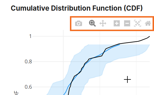

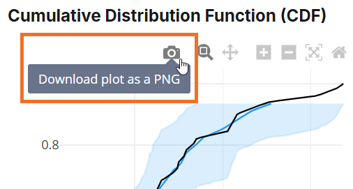

Hold your mouse cursor over a chart to reveal a toolbar.
From the toolbar, you can save each chart as a local PNG file by clicking the camera button:

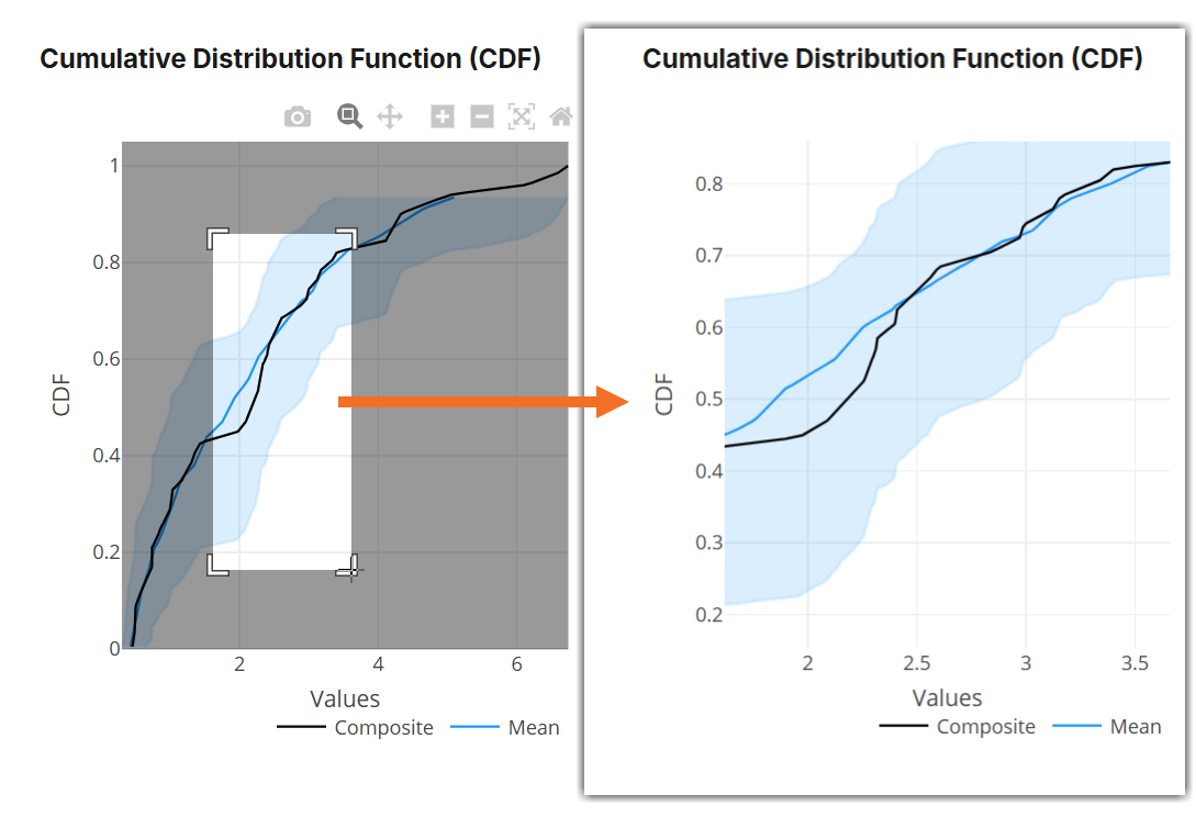

To reframe a chart around a region of interest, click the magnify button, then click-and-drag a box around the region of interest:
There are also controls for panning and zooming in and out. Each of the axes can be dragged to be repositioned.
To reset the chart to the original appearance, there are Autoscale and Reset axes buttons.
Comparing Individual Simulations
Downloaded individual simulations can be selected as colouring options in the shape list for the conditional simulation:
Switch between individual simulations to obtain an impression of the similarities between simulation runs.
