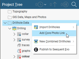

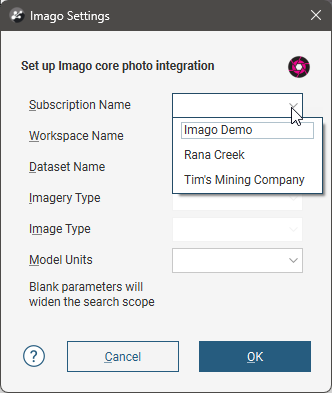

Before you can view core imagery, you must first set up the integration between Leapfrog Energy and the Imago database. To do this, right-click on the Well Data folder and select Add Core Photo Link:
In the window that appears, select Imago and click OK.
The Imago Settings window will appear.
Imago supports Seequent ID, and so the Subscription Name list displays all the subscriptions your Seequent ID has access to.
It is a good idea to be as specific as possible when configuring the Imago integration; set at least the subscription and workspace names.
Click OK to save the information.

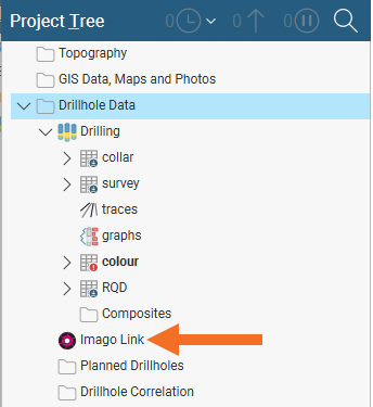

A link will appear in the project tree as part of the Well Data folder:
You can double-click on this link to edit the Imago integration settings.

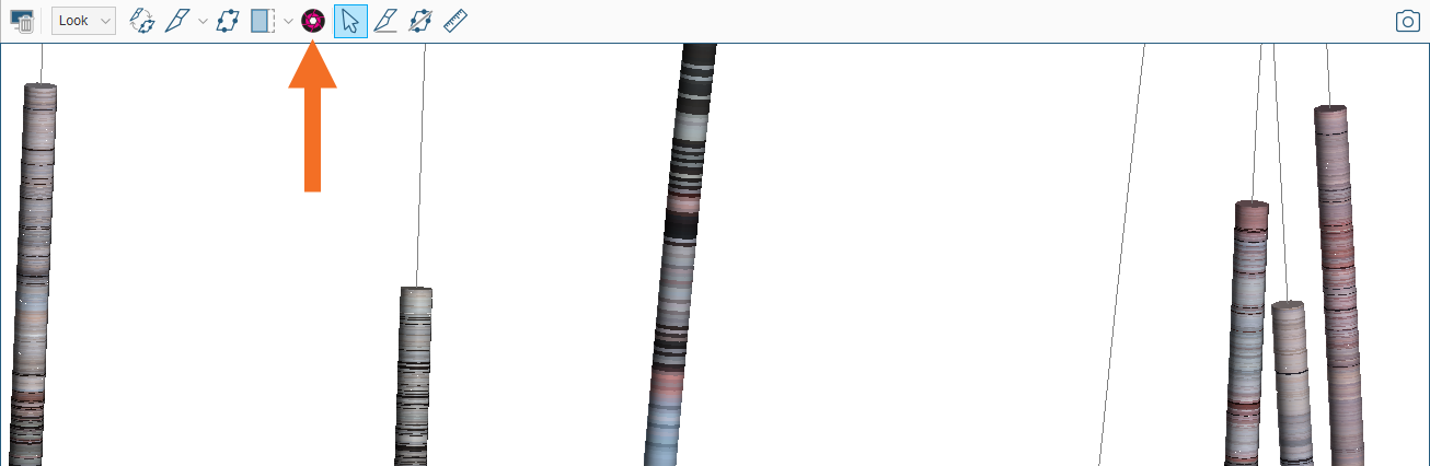

An Imago button (
) will also appear in the toolbar:
Clicking on this button will open the Imago Panel:

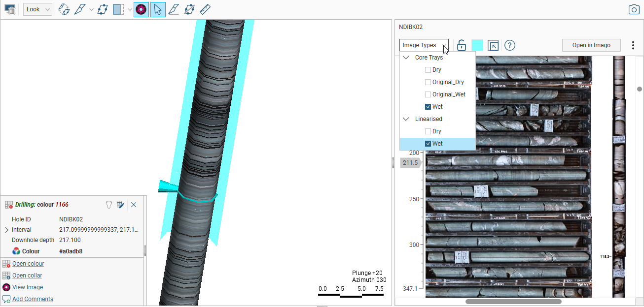

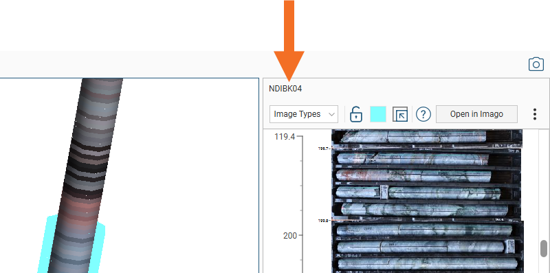

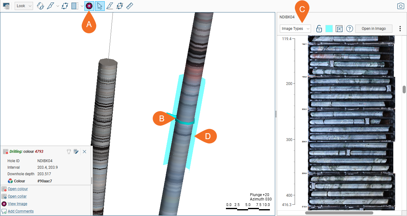

Click on the Imago button (
) in the toolbar (A), then on a well interval in the scene (B) to display Imago imagery for that interval in the docked panel alongside the scene (C). The scene highlight (D) shows the part of the well that corresponds to images in the panel.
The scene highlight is open toward the viewing angle in order to avoid impeding viewing the well data associated with the core imagery. The scene highlight colour and other properties can be customised, which is described in Changing the Scene Highlight Properties later in this topic.
Note that the well ID is displayed at the top of the panel:

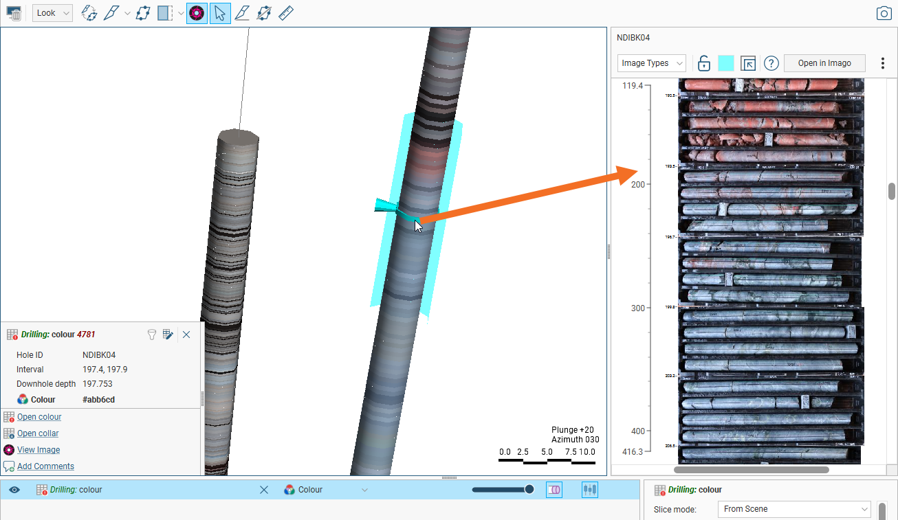

Depth information is displayed on the ruler in the panel. To view imagery at a particular depth, click on the ruler at that depth.
From the Image Types list, you can see all the imagery available for that well that matches the search criteria set in the Imago Settings window. For example, here both core tray images and linearised images are displayed for a well:

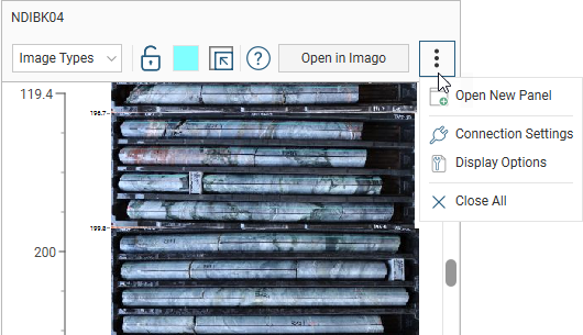

The panel has an overflow menu (
) that contains more Imago streaming settings:
If an image type you expect to see is not listed, you can check your Imago settings by clicking on the overflow menu and selecting Connection Settings. This opens the Imago Settings window.

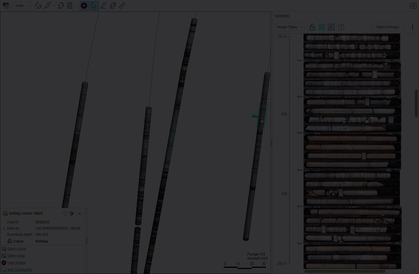

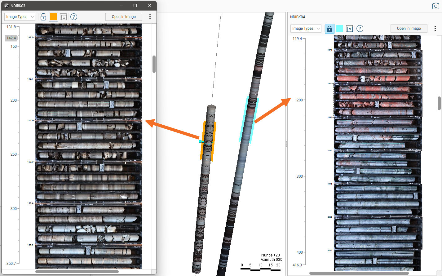

Click on the colour chip to change the colour used for the scene highlight:
Changing the colour of the scene highlight is useful when displaying imagery for multiple wells, which is the case here where the scene highlight is blue for the docked panel and orange for the undocked panel:

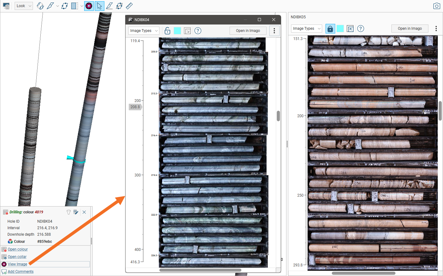

Working in Multiple Panels
The panel can be used docked (
) or undocked (
). You can also open multiple panels, although only one panel can be docked at a time.

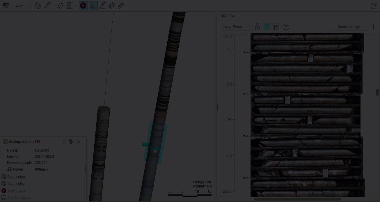

To open a second panel, lock the first panel. This prevents different imagery from being displayed in first panel when you click on other wells in the scene.
Next, click on an interval in the scene. The View Image link in the scene details panel opens a new Imago panel with imagery loaded for that well:

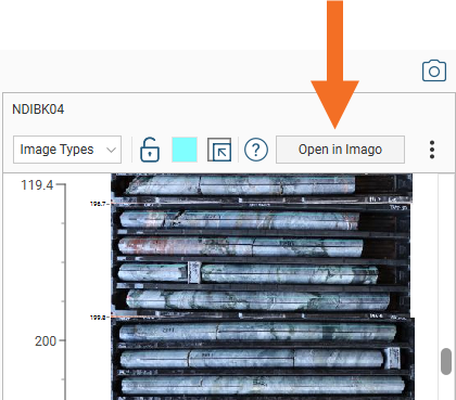

To open imagery in the Imago Portal, click the Open in Imago button at the top of the panel:
This opens the Imago Portal in your default web browser. You may need to sign in.

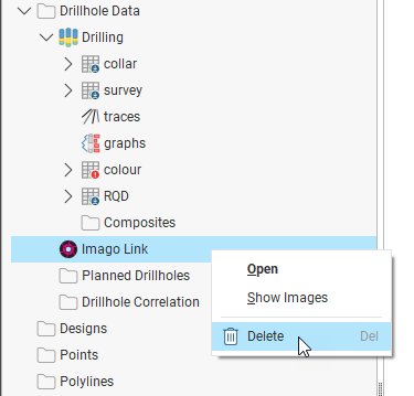

Removing the Imago Link
To remove the Imago link, right-click on it in the project tree and select Delete:
