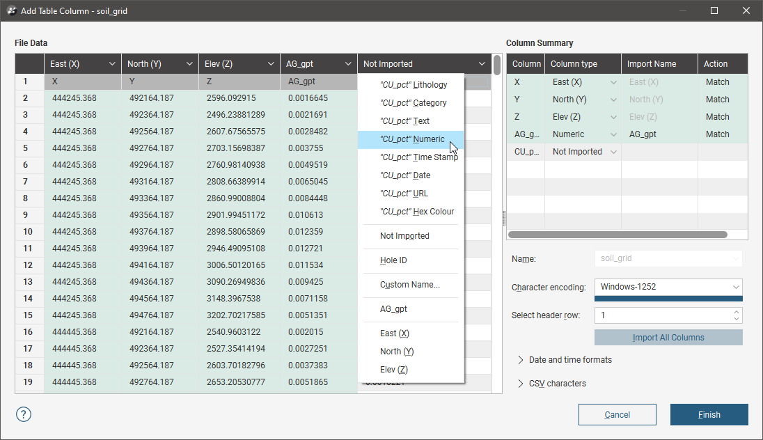

Importing a column is similar to importing tables themselves. Leapfrog Energy will display the data in the file in the Add Table Column window and you can select how you wish to import any additional columns. Here, we will import the CU_pct column as numeric data:
It is not necessary to re-import any columns that are already part of the project.
Click Finish to import the new column.
