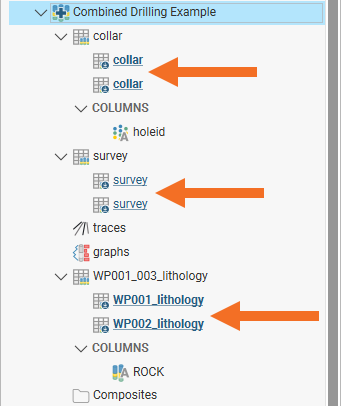

As with imported drilling datasets, a combined drilling dataset is made up of a collar file, a survey file and at least one other table. Information in each type of table is built up from the source datasets, which are linked to from the combined dataset. In this example, a combined dataset has been created from two lithology tables. The combined collar table and the combined survey table have been created from the corresponding tables in the source datasets.

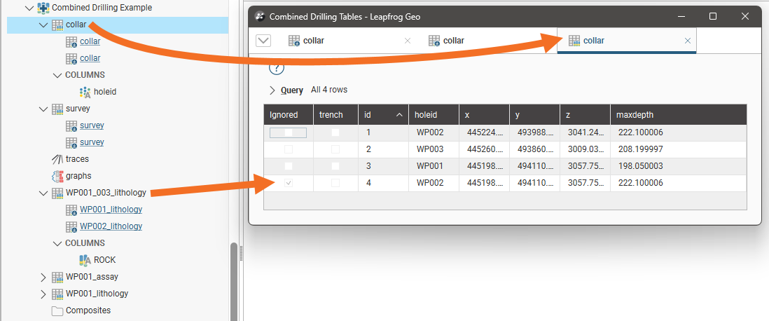

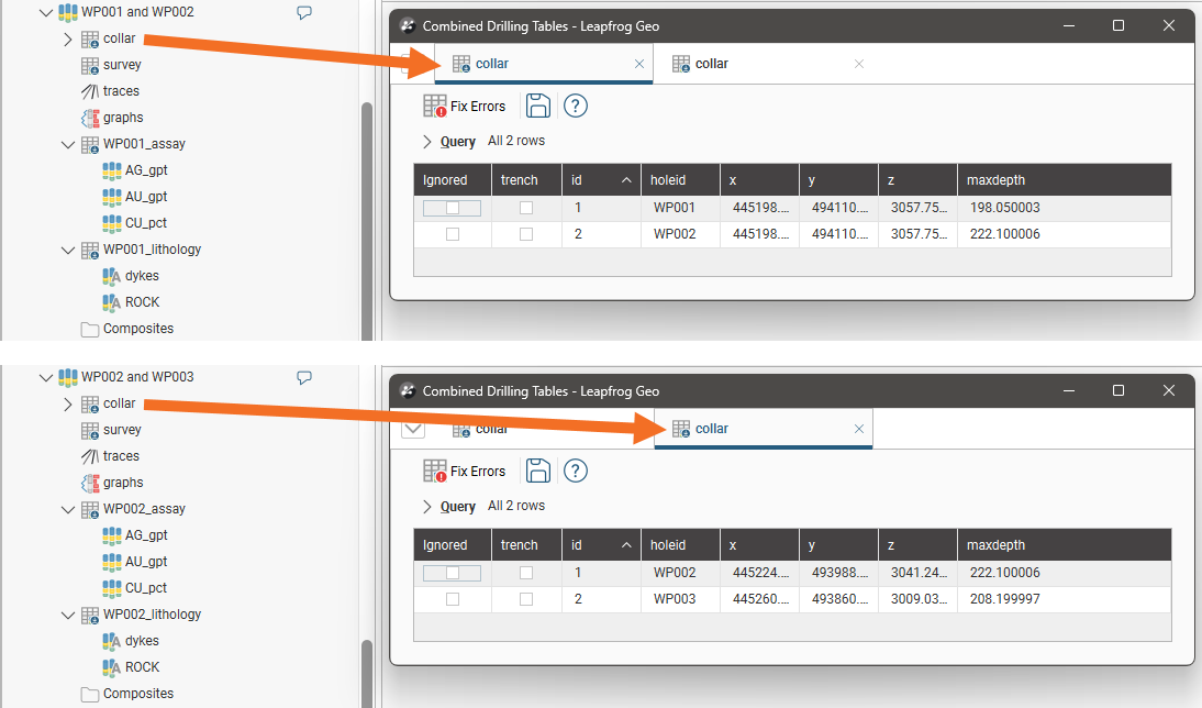

The collar information from each dataset is used to build the combined collar table, with duplicate data rows marked as ignored. Both WP002 rows are included in the combined collar table; note that the second WP002 row (id 3) is marked as ignored:

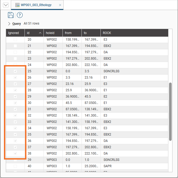

The same is true for the combined lithology table, where the duplicate rows for the WP002 well are marked as ignored:

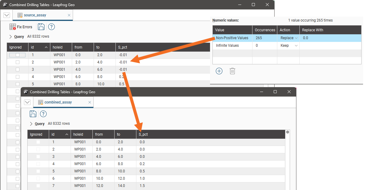

This example shows how special value handling rules in the source table are used in creating the combined table. The source table has negative values in the first three rows and the special values handling rules specify that non-positive values are replaced with 0.0 for the S_pct column. In the combined table, the Replace With value of 0.0 is used:
When the rule for the source table is changed so that non-positive values are omitted, the S_pct column is blank for the three rows in the combined table:

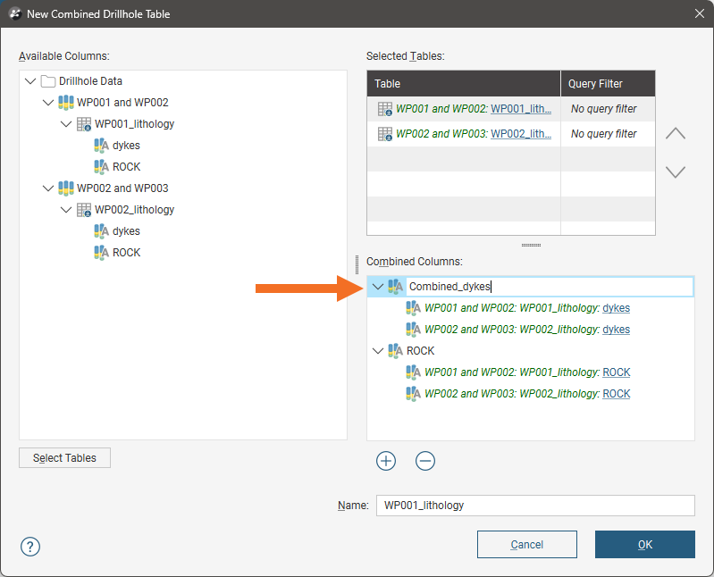

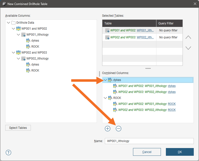

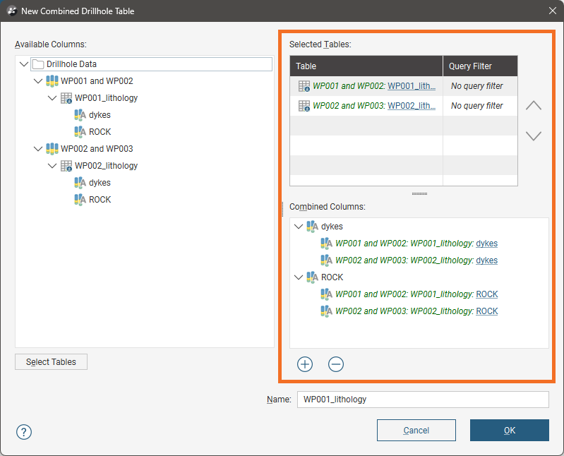

Click OK. In the New Combined Well Table window, the selected tables are displayed. The Combined Columns list shows the columns that will result:

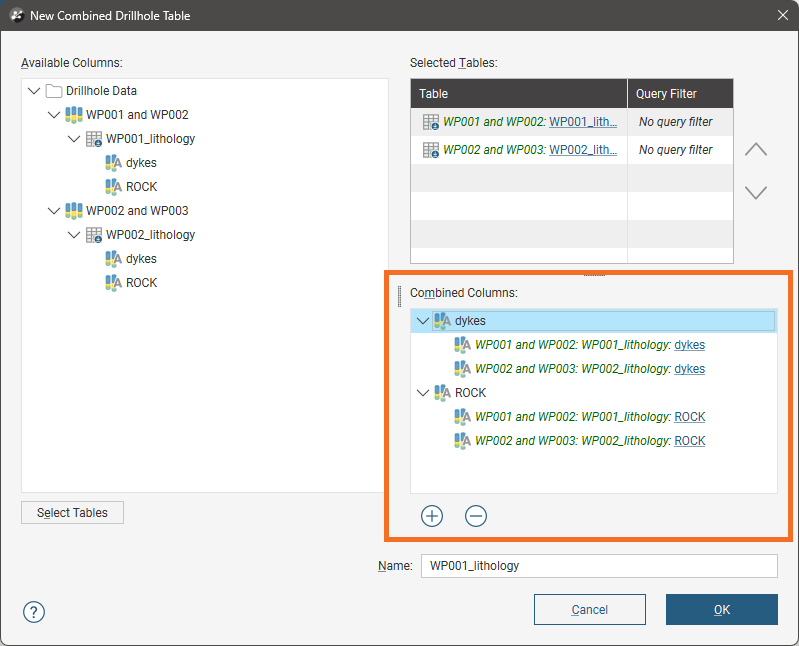

All columns in the selected tables are automatically added to the Combined Columns list. For example, here both the dykes and ROCK columns have been added to the Combined Columns list:
If, however, you do not wish one of these source columns to appear at all in the combined table, click on that column in the Combined Columns list, then click the Remove button (
). For example, here clicking the Remove button will result in no dykes column appearing in the combined table:
If you do not want to use one of the source table columns in the combined table, click on the column you wish to remove in the Combined Columns list, then click the Remove button. For example, here removing the WP001 and WP002 dykes column will result in only the WP002 and WP003 dykes column being used in the combined table:
You can also:
- Use the arrows in the Selected Tables list to change the priority of the tables. This is discussed further in Changing Table Priority.
- Add more tables to the Selected Tables list. To do this, click the Select Tables button, then choose from those in the project.
- Add more columns to the combined dataset. Drag a column from the Available columns list into the Combined Columns list or click the Add button (
) to open the Select Columns window. - Rename a combined column. Double-click on it and enter the new name:
Once you have added the data columns you wish to include, set a Name for the new interval table, then click OK. The new combined drilling dataset will be created and added to the project tree.

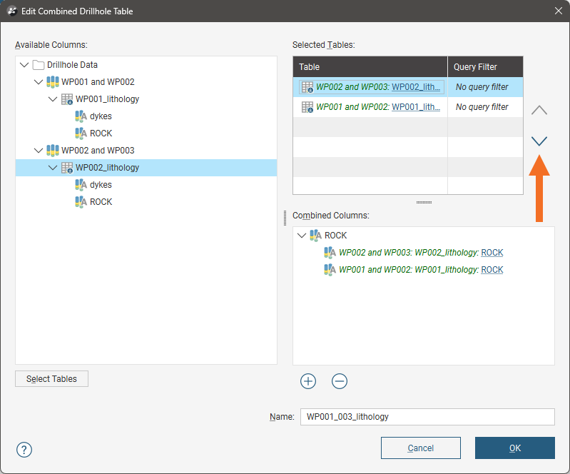

The priority of each table in the Combined Well Table window determines which information is used when there is duplicate information. For example, here the WP002 and WP003 table is higher in the list and so has higher priority than the WP001 and WP002 table:
Because the same holeid is used in each source table, one is marked as ignored in the combined dataset.
Use the arrows to change the priority of selected tables:
Click OK to close the window and make the changes.

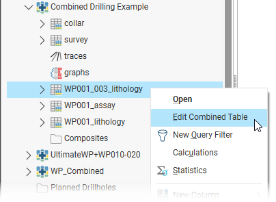

To edit a combined drilling dataset, right-click on one of the tables in the combined dataset and select Edit Combined Table:

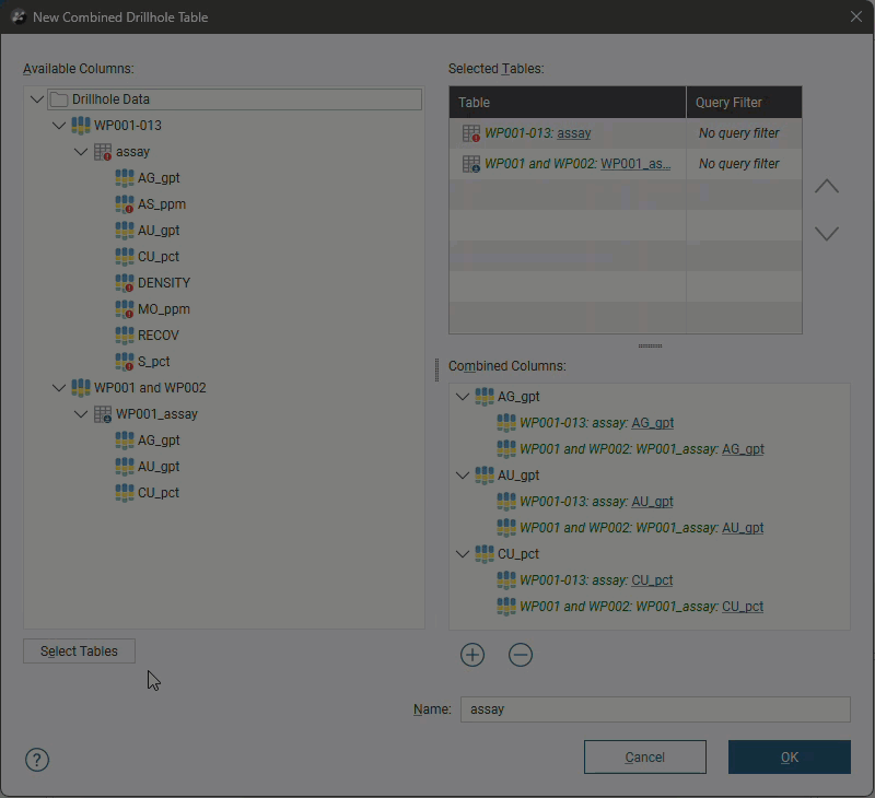

To add another table to the combined drilling dataset, right-click on it and select one of the New Combined Table options:
Here the assay tables from the two source drilling datasets have been used to create a new combined assay table with three columns in the combined drilling dataset:
