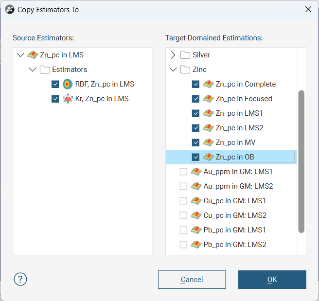

Copying Estimators
You can also copy one or more estimators to several other domained estimation objects at once. Select an estimator in the project tree, or select multiple estimators in the same domained estimation, right-click the selection and select Copy Estimators To from the menu. In the Copy Estimators To window, the selected estimators will appear on the left in the Source Estimators list. On the right is the Target Domained Estimations list, showing all the available domained estimations that the estimators can be copied to. Tick the box next to each domained estimation you want to receive copies of the selected estimators.
Copying of the source estimators is limited to parameters relating to the estimator itself. The following special behaviours relate to associated objects the source estimator uses:
  • New copies of an estimator will reference the original estimator's variogram object; no new variogram object will be created in the destination domained estimation.
  • If a source estimator's variable orientation object is a local object, the variable orientation object will be moved to the shared Variable Orientation folder under the Estimation folder in the project tree. Both the original estimator and the newly created estimators will reference the shared variable orientation object.
  • If a source estimator relies upon a declustering object, the new estimators will not have any declustering object associated with them; the Declustering selection for the copied estimators will be reverted to None. A warning message will be displayed to draw attention to this. The source estimation will be unaffected.

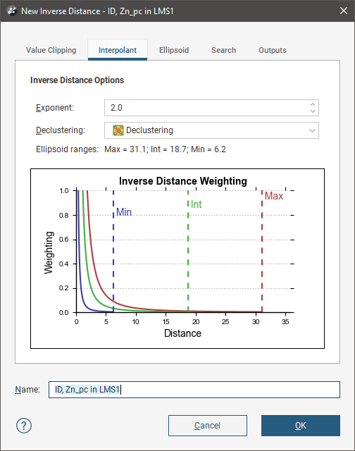

Leapfrog Energy extends the basic inverse distance function, and the inverse distance estimator supports declustering and anisotropic distance.
In the Interpolant tab:
  • Exponent adjusts the strength of the weighting as distance increases. A higher exponent will result in a weaker weight for the same distance.
  • Optionally select a Declustering object from the declustering objects defined for the domained estimation; these are saved in the Sample Geometry folder.
  • Ellipsoid Ranges identify the Max, Int and Min ranges set in the Ellipsoid tab.
  • A chart depicts the resultant weights that will be applied by distance.

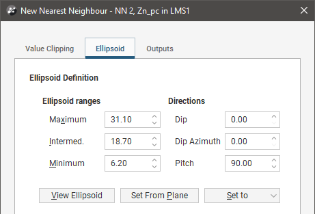

In the Ellipsoid tab:
  • The Ellipsoid Definition sets the anisotropic distance and direction, scaling distances in three orthogonal directions proportionally to the range for each of the directions of the ellipsoid axes. This effectively makes the points in the direction of greater anisotropy appear closer and increases their weighting. Adjust the Ellipsoid Ranges and Directions to describe the anisotropic trend.
  • Click View Ellipsoid to see an ellipsoid widget in the scene that helps to visualise the anisotropic trend.

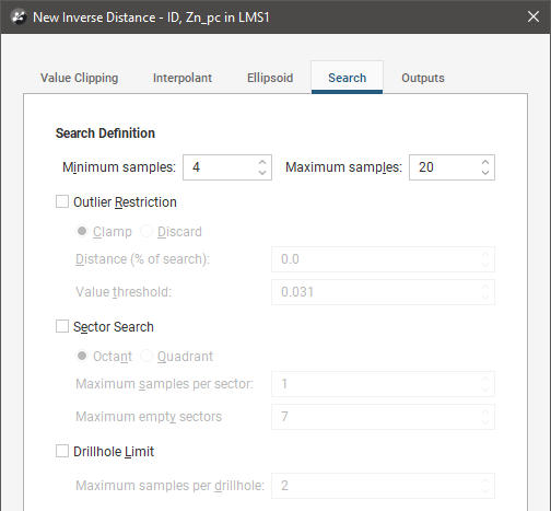

In the Search tab:
  • The Minimum Samples and Maximum Samples parameters determine the number of samples required or used within the search neighbourhood.
  • The remaining fields provide controls to reduce bias.
    • Outlier Restriction reduces bias by constraining the effect of high values at a distance. After ticking Outlier Restriction, you can choose to either Clamp (reduce the high value to the Value Threshold) or Discard high values that meet the criteria for outlier restrictions. It limits the samples that will be considered to those within a specified Distance percentage of the search ellipsoid size, and only those outside that distance if they are within the Value Threshold. If a sample point is beyond the Distance threshold and the point’s value exceeds the Value Threshold, it will be clamped or discarded according to the option selected.
    • Sector Search divides the search space into sectors. Choose from Octant providing eight sectors or Quadrant providing four sectors. The Maximum samples per sector threshold specifies the number of samples in a sector before more distant samples are ignored. The Maximum empty sectors threshold specifies how many sectors can have no samples before the estimator result will be set to the non-normal value without_value.
    • Well Limit constrains how many samples from the same well will be used in the search before limiting the search to the closest samples in the well and looking for samples from other wells.
When displaying the search space in the scene with octant or quadrant search sectors, the translucent planes in the widget change to divide the search ellipsoid into the search sectors. To view the search ellipsoid in the scene, drag the Search object for an estimator into the scene.

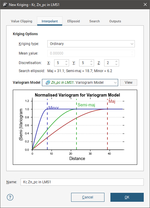

  • Both Ordinary and Simple Kriging are supported.
  • For Simple Kriging, specify a Mean value for the local mean to use in the Kriging function.
  • Discretisation sets the number of discretisation points in the X, Y and Z directions for block Kriging. Block Kriging provides a means of estimating the best value for a block instead of only at the centre of the block. Each block is broken down (discretised) into a number of sub-units without actually sub-blocking the blocks. A geologist will consider a variety of factors including spatial continuity when deciding on the discretisation to use. Set the X, Y and Z parameters to 1 for point Kriging. To use additional discretisations, copy the estimator and change the Discretisation parameters.
  • Search Ellipsoid identifies the Max, Int and Min ranges set in the Ellipsoid tab.
  • Select from the Variogram Model list of models defined in the Spatial Models folder.
  • The View button will show an ellipsoid widget in the scene to assist in visualising the variogram model ranges and direction.
  • A chart depicts colour-coded semi-variograms for the variogram model.

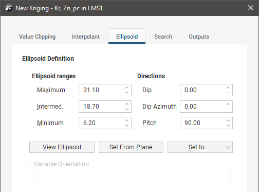

  • The Ellipsoid Definition sets the Ellipsoid Ranges and Direction.
  • Click the View Ellipsoid definition to show an ellipsoid widget in the scene to assist in visualising the search ellipsoid. Note that this is not the same as the variogram model ellipsoid, unless the Set to option is used to select the variogram model to copy the details.

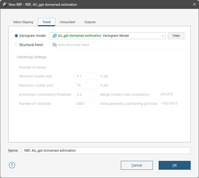

To create an RBF estimator, right-click on the Estimators folder and select New RBF Estimator. The New RBF window will open on the Trend tab:
Alternatively, in a feature unique to RBF estimators, a Structural trend can be used, if one is available in the project. See Using a Structural Trend in the RBF Interpolants topic.

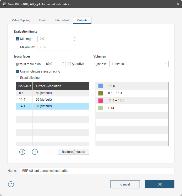

In the Outputs tab, the Minimum and Maximum Evaluation Limits constrain the values. Values outside the limits are set to either the minimum or maximum limit, as appropriate. To enable a limit, tick the checkbox and set a limit value.
  • The Default resolution will be used for all isosurfaces, unless you change the Surface Resolution setting for an individual isosurface. See Surface Resolution in Leapfrog Energy for more information on the Adaptive setting. The resolution can be changed once the estimator has been created, so setting a value in the New RBF window is not vital. A lower value will produce more detail, but calculations will take longer.
  • The Volumes enclose option determines whether the volumes enclose Higher Values, Lower Values or Intervals. Again, this option can be changed once the estimator has been created.
  • Click the Restore Defaults button to add a set of isosurfaces based on the estimator’s input data.
  • Use the Add () to add a new isosurface, then set its Iso Value.
  • Click on a surface and then on the Remove () button to delete any surface you do not wish to generate.
