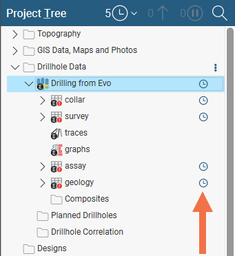

When an object imported from Evo is updated in Evo, a status indicator will appear in the Leapfrog Energy project tree alongside the object that has changed. For example, here a drilling dataset is out-of date:
See Object Status Indicators for more information on the different status indicators.

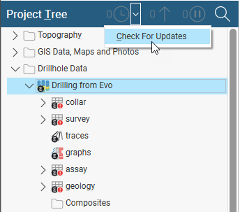

You can also check for updates by clicking the button at the top of the project tree and selecting Check For Updates:

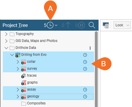

Once the check is complete, the number of objects that are available for update is indicated in the project tree title bar (A). Click on the button to select all of the out-of-date objects in the project tree (B):

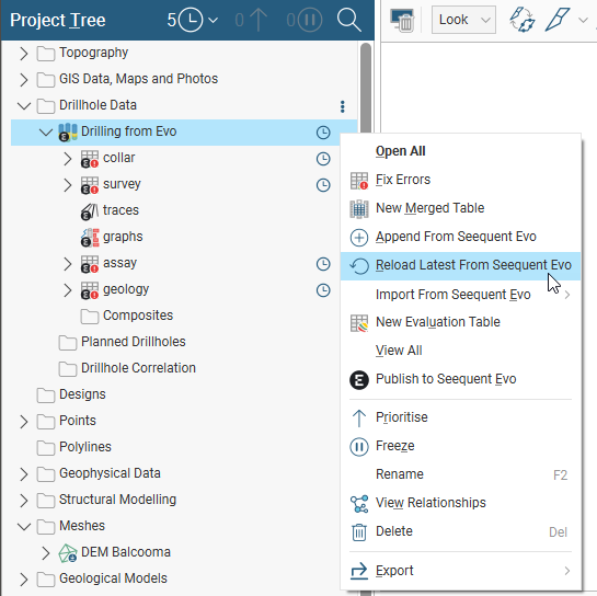

To refresh a single out-of-date object, right-click on it in the project tree and choose Reload Latest From Seequent Evo:

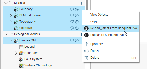

To refresh multiple objects at once, select them in the project tree. Then, right-click on them and choose the Reload Latest From Seequent Evo option:

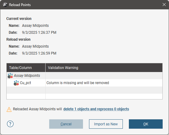

In this example, the selected version of a table of points in Evo is missing a data column that the current local object contains. The validation warning message indicates that if the reload process is completed, the data column will be removed from the local Leapfrog Energy project.
If you do not wish to lose that data, click the Import as New button to import the object as a new object. This will result in two different versions of the object in the project tree; you can then compare versions and decide which one to use.
There is also a Cancel button in case you prefer to not reload the data from Evo at this time.
