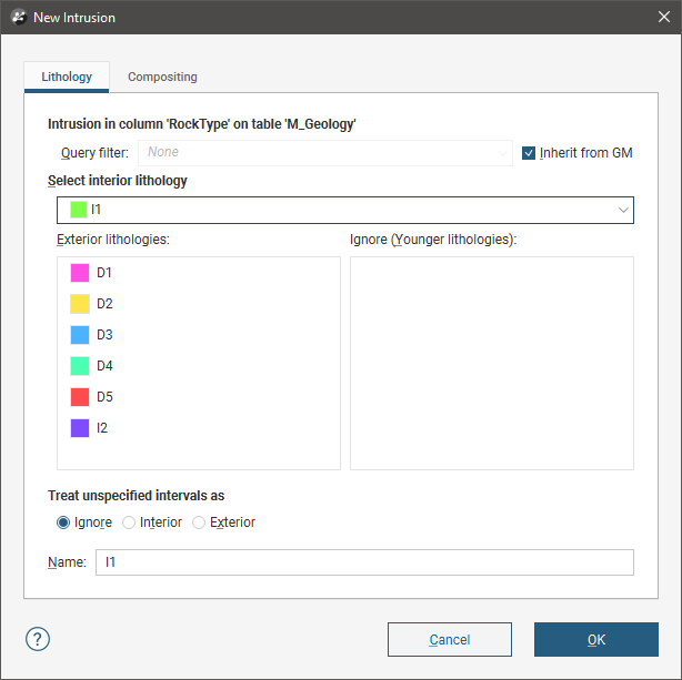

To create a new intrusion from lithology contacts, right-click on the Surface Chronology object and select either New Intrusion > From Base Lithology or New Intrusion > From Other Contacts. The only difference in the two methods is that when creating an intrusion from other contacts, you must first select the lithology column from those available in the project and specify the First lithology and the Second lithology.
Select the intrusive lithology as the interior lithology. Other lithologies will be displayed in the Exterior lithologies list. Drag any younger lithologies to the Ignore list.
Unspecified intervals are intervals that have no data. By default, unspecified intervals are ignored when creating an intrusion, but you can also treat them as the interior lithology or as exterior lithologies.

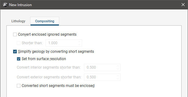

Sometimes intrusive boundaries are poorly defined, with fragments of country rock intermixed with the intrusive body. This can result in very small segments near the edges of the intrusion. Modelling the fine detail is not always necessary, and so compositing can be used to smooth these boundaries. Compositing parameters are set in the Compositing tab:
The settings in this tab, other than the Set from surface resolution option, are the same as described in Category Composites. That topic uses drillhole data and visualises the effect of compositing in generating category composites in different situations and with different compositing options. Refer to that topic to get insight into what actions are being taken when compositing data to produce a lithology contact surface.
When choosing to Simplify geology by filtering short segments, the Set from surface resolution option will scale what detail is filtered out in compositing according to the selected surface resolution for the geological model lithologies.

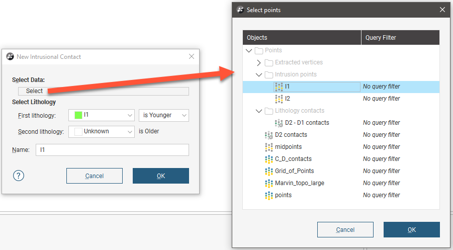

- Right-click on the Surface Chronology and select one of the data types from the New Intrusion menu.
- Select the data object that will be used to define the surface. This must already be in the project, unless you are using a polyline, in which case you are given the option to create a new polyline.

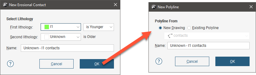

- Select the First lithology and Second lithology. These are the lithologies that will be assigned to each side of the contact surface. The lithologies you can choose from are those defined for the geological model in the Lithologies object (see Geological Model Lithologies).
- Set whether the First lithology is older or younger than the Second lithology. Leapfrog Energy will, by default, put the younger side of a contact surface up, but this can be changed later.
Here, a points data object is being used to create an intrusion:
For polylines, you first set the lithologies and the younging order, then click OK to move on to the next step:
You can draw the polyline in the scene directly by selecting the New Drawing option. You can also use any polyline in the project by selecting the Existing Polyline option. You can then select the required polyline from the list.

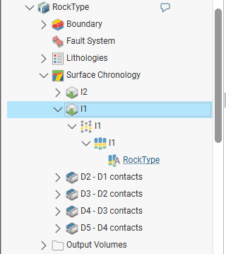

The name Leapfrog Energy automatically assigns to an intrusion is the name of the intrusive lithology. In the project tee, expand the intrusion to see how it was made:
Double-click on the intrusion surface (
) to edit it. Double-click on the points object (
) to edit the intrusion lithology, change compositing parameters and change point generation options.

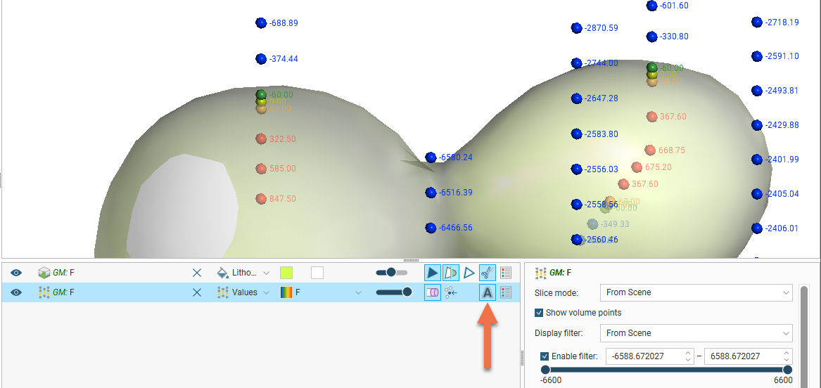

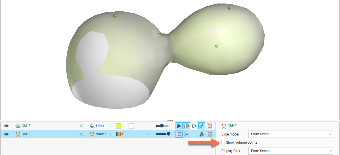

When you view the intrusion points in the scene, you can display only the contact points or all the points used in creating the intrusion. To display all points, click on the points object (
) in the shape list and tick the box for Show volume points. Here, only the contact points are displayed:
When the volume points are displayed, points with negative values are those outside the surface, while points with positive values are those inside. Show text (
) has been enabled in the shape list so that the values are displayed:

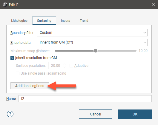

Clicking Additional options adds Value Clipping and Interpolant tabs to the window and also allows the use of a structural trend in the Trend tab:
These are described in Applying a Trend to an Intrusion, Clipping Values for Intrusions and Interpolation Settings below.

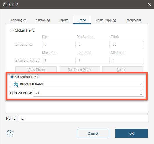

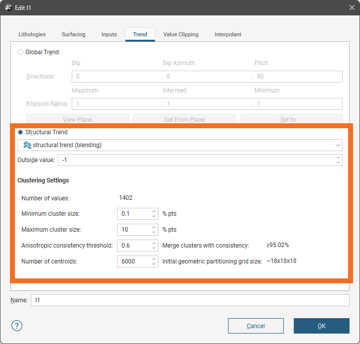

You can also use a structural trend for an intrusion. To do this, click the Additional options button in the Surfacing tab, then click on the Trend tab.
Click on Structural Trend, then select the required trend from the list. For more detailed information, see the Building a Structural Trend and Clustering Settings and Visualisation topics.

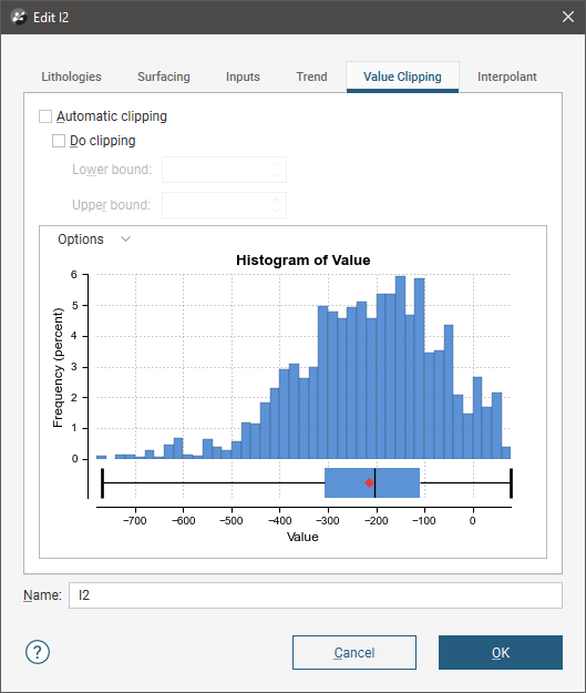

You can change settings for intrusions by double-clicking on the contact surface in the project tree. The Value Clipping tab is only available for intrusion contact surfaces.
In the Value Clipping tab, you can manipulate the data distribution by clipping the data:
Clipping caps values that are outside the range set by the Lower bound and Upper bound values. For example, if you change the Upper bound from 16.00 to 10.00, distance values above 10.00 will be regarded as 10.00.
The Automatic clipping setting has different effects based on whether a global trend or structural trend is set in the Trend tab:
- When a global trend is applied, Leapfrog Energy automatically clips the values. That is, the Automatic clipping setting is Do clipping and Leapfrog Energy sets the Lower bound and Upper bound from the data. To disable clipping, untick Automatic clipping, then untick Do clipping. To change the Lower bound and Upper bound, untick Automatic clipping, then change the values.
- When a structural trend is applied, Leapfrog Energy automatically does not clip the values. To clip values, untick Automatic clipping, then tick Do clipping. Again, Leapfrog Energy sets the Lower bound and Upper bound values from the data and you can change them, if required.
