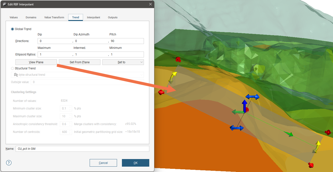

You can apply a global trend or a structural trend to a multi-domained RBF interpolant. To do this, add the interpolant to the scene, then double-click on the interpolant in the project tree. Click on the Trend tab in the Edit RBF Interpolant window.
See:
Using a Global Trend
The easiest way to change the trend applied to an interpolant is using a global trend set from the moving plane.
Click View Plane to add the moving plane to the scene, then click on the plane to view its controls. You may need to hide part of the interpolant to click on the moving plane:
You can also use the Set to list to choose different options Leapfrog Energy has generated based on the data used to build the interpolant. Isotropic is the default option used when the interpolant is created.
Click OK to regenerate the interpolant and view changes.

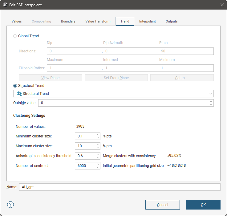

Using a Structural Trend
You can also set the trend for an RBF interpolant from a structural trend. First, you must create or import the required mesh and create a structural trend.
Once the structural trend has been created, add it to the interpolant by double-clicking on the interpolant in the project tree, then clicking on the Trend tab. Select the Structural Trend option, then select the required trend from the list:
Outside value represents a baseline value, the expected ambient value of the surrounding region. The Outside value is factored into the interpolation algorithm and lowers the interpolated value in the areas away from the known data points. The blending with outside value is very steep. To increase the projection area outside of the area with data the Outside value can be increased to a value just below the cut-off value.
Once you have selected a structural trend, you can adjust the clustering settings. For more detailed information For more detailed information, see the Building a Structural Trend and Clustering Settings and Visualisation topics.
Click OK. The trend will be added to the interpolant and will appear as part of the interpolant, as shown:
When you apply a structural trend, you cannot use the Linear interpolant. See Interpolant Functions for more information.
Multiple models can use the same structural trend as an input with different clustering settings, each model stores its own settings.
You will be able to change the Trend settings for the interpolant and individual sub-interpolants once the parent interpolant has been created.

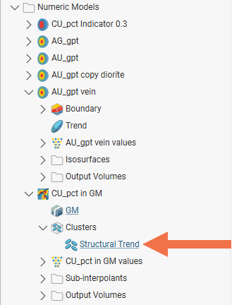

The Multi-Domained RBF Interpolant in the Project Tree
The new multi-domained RBF interpolant will be created and added to the Numeric Models folder. It contains objects that represent different parts of the interpolant:
- There is a link to the geological model from which domains are selected for the sub-interpolants.
- The Trend object describes the trend applied in the interpolant. See Changing the Trend for an RBF Interpolant for more information.
- The points data values object contains all the data used in generating the interpolant. See Changing and Adjusting the Values Used for more information.
- The Sub-interpolants folder contains the sub-interpolants, which can be edited to change the trend, clipping, transformation and interpolation settings. Each sub-interpolant has its own boundary, trend, isosurfaces and output volumes.
- The Output Volumes folder contains all the volumes generated in building the interpolant.
Other objects may appear in the project tree under the interpolant as you make changes to it.

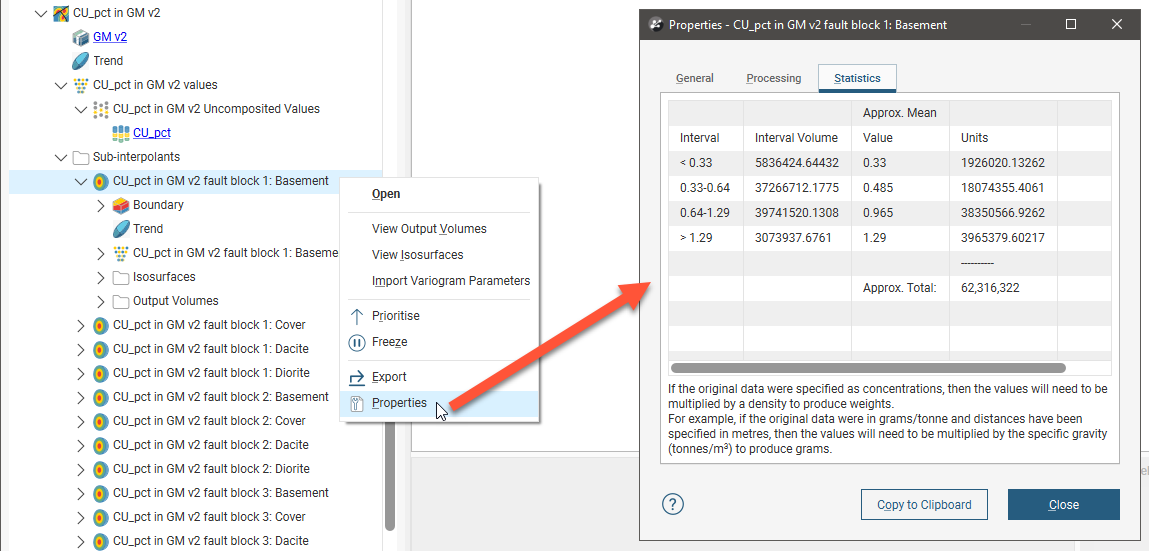

Sub-Interpolant Statistics
You can view the approximated mean for each output volume of a sub-interpolant by right-clicking on the sub-interpolant and selecting Properties. Click on the Statistics tab:
