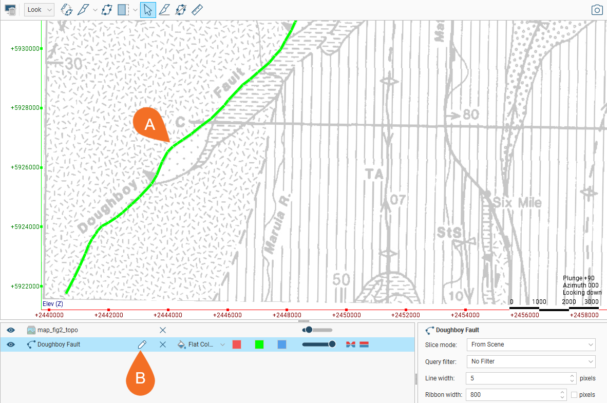

- Right-click on the polyline in the project tree and select Edit Polyline. The polyline will be displayed in the scene and the polyline editor will be opened.
- If the polyline is already displayed in the scene, click on its Edit polyline button (
) in the shape list. The polyline editor will be opened.

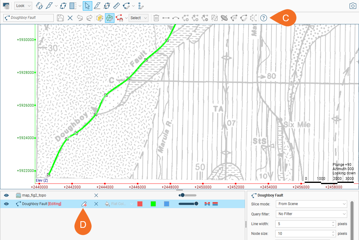

For example, here, we have a 2D polyline in the scene indicated by the solid green line (A). Click the button in the shape list (B) to start editing the polyline:
The polyline editor (C) is opened:
Clicking the edit button (D) again will close the polyline editor. If you have made changes to the polyline but have not yet saved them, you will be prompted to do so.

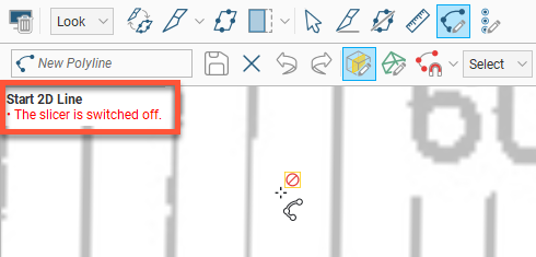

When you start drawing a polyline, the polyline editor will appear above the 3D scene. If you are drawing a GIS line or if the slicer was already in the scene, the drawing mode will be set to be on the slicer. Toggle between the two options using the toolbar buttons:
When drawing and otherwise working with the polyline, hints are displayed in the scene that show what actions are currently possible:
For example, if the mode is set to draw on the slicer (
), you will be warned if the slicer is not in the scene:

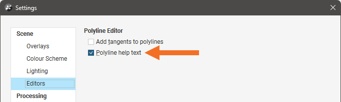

You can disable these hints once you are more familiar with how the polyline editor works. Open the Settings window by clicking on the Leapfrog Energy menu and selecting Settings. Click on Editors and disable the Polyline help text option:

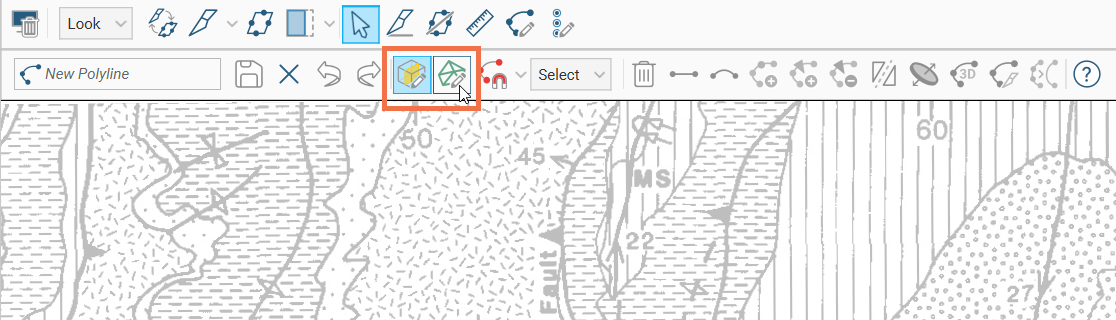

The tools in the second row are for controlling whether the polyline is drawn (on the slicer (
) or on surfaces (
)). The node snapping selector (
) allows you to specify the way a new node snaps to existing objects. The Select list lets you select different parts of the polyline.

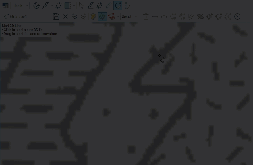

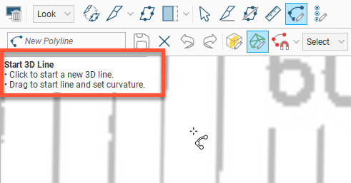

Drawing 3D Polylines
To start drawing a 3D polyline:
- Be sure drawing on surfaces (
) is enabled, then - Click the Draw lines(
) button.
You can then start clicking on objects in the scene to draw. Each time you click, a node will be added, with a straight polyline segment drawn between subsequent nodes. Right-click anywhere in the scene to discard the newly started segment and finish the line at the last node. As this is a 3D polyline, it will appear in the scene as a dashed line. Polylines are made up of these nodes and line segments.

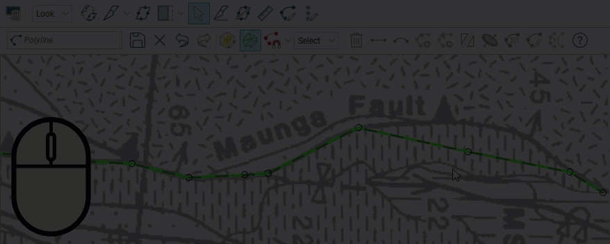

To approximate a curve using straight polyline segments, create nodes that are close together.

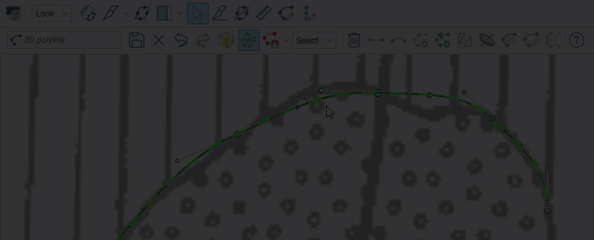

You can also create curved polylines using bezier curves to get at least the approximate shape of a curve. Later on you can adjust the position of nodes and the bezier handles to refine the shape.
To create a curved polyline using bezier curves:
- Click where the line segment should begin.
- Move to where the curved line segment should end, then click-and-drag. This will place the new node, and a curved line between the last two nodes will appear.
- Drag the cursor while holding the mouse button down until the curved line lies where you want it, then release the mouse button.
At this point, another curved line segment will appear as you move the cursor. You can now take one of these three actions:
- Right-click to discard the newly started segment and finish the line at the last node.
- Move the cursor to where the next node will go, noting that as you move the cursor, the emerging curve may not be exactly where it is needed. Click-and-drag to place the next node. As you drag, you will be able to bend and shape the previous curved line segment to position the line where it should lie.
- Move the cursor until the new curved line segment lies where you want it, then click to place a node and start drawing a new straight line segment.
Creating a curved line using this technique usually takes some practise to get the shape you want. You will likely need to adjust the positions of the nodes and bezier handles to improve the curve.

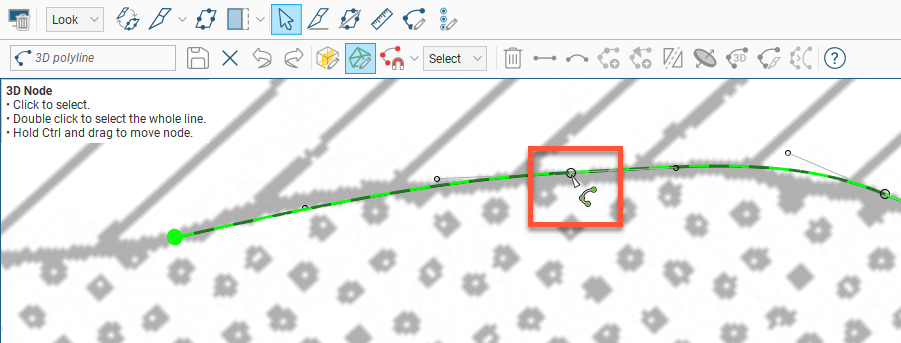

In the image below, the cursor is currently over a node.
Click to select a node and drag to move it in the scene parallel to the screen.

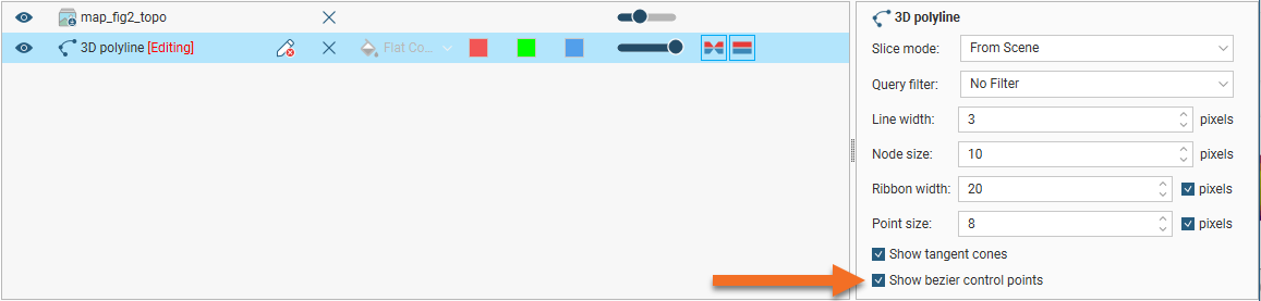

Repositioning the nodes may not be enough to get a curved polyline where you want it. You may also need to adjust the bezier control points to adjust how much the line segment curves.
If you can’t see the bezier control points, click on the polyline in the shape list and enable the Show bezier control points option:

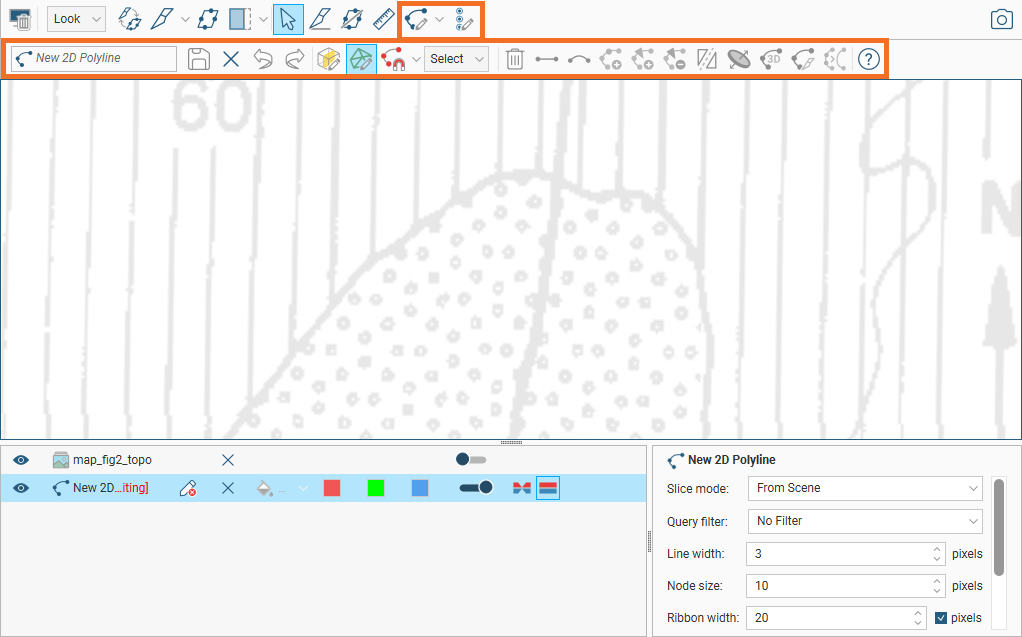

Drawing 2D Polylines

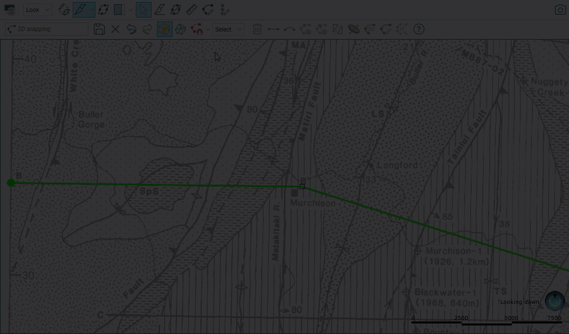

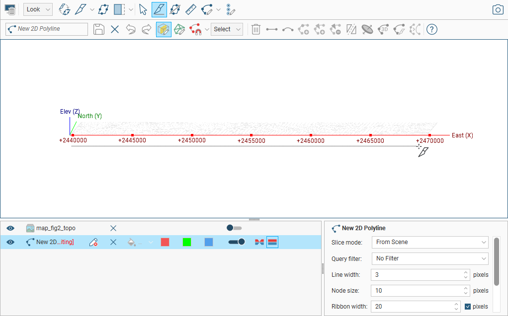

2D polylines are drawn on a plane set by the slicer and are shown as an unbroken line, whereas a 3D polyline is shown as a dashed line.
To begin, add an object to the scene. Here, a topography map is added. Next right-click on the Polylines folder and select New Polyline. The polyline editor will open:
To start drawing a 2D polyline be sure drawing on the slicer (
) is enabled, then use the slicer to create a slice. You may need to reorient the object in the scene as in the case here:
) button.
Then, drawing a 2D polyline is similar to drawing 3D polylines, except that drawing is restricted to the 2D plane set by the slicer.
To convert a 2D polyline into a 3D polyline, double-click on the line to select the whole line, then click the 3D polyline button (

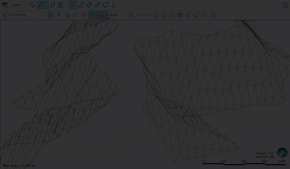

Node Snapping Options
With the node snapping selector (
), you can choose how a new node snaps to existing objects. You have the following options:
- Snap to polyline nodes (for 2D and 3D polylines)
- Snap to mesh edges (for 3D polylines only)
- Snap to mesh vertices (for 3D polylines only)
It is not possible to snap to a mesh edge or vertex when drawing 2D polylines as it is almost impossible to locate such a position on the slicer.
With a node snapping mode selected, the new node will snap to the object when you click to locate the node. To see the effect of snapping, zoom in close.
As you get close to an object the new node is able to snap to, it will pull the new node to the object like a magnet. When Snap to mesh edges or Snap to mesh vertices options are selected for 3D lines, if an object is not close enough, the cursor and the hint text will indicate that no object is under the mouse cursor. As you approach an edge or a vertex, the cursor will pull to that edge or vertex to make clicking on the snap-to object easy.

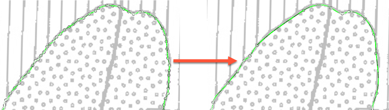

Use as many nodes as necessary to draw the polyline. You can later reduce the number of nodes using the Simplify polyline tool (
). Each time this tool is used, Leapfrog Energy attempts to halve the number of nodes on the select segments:

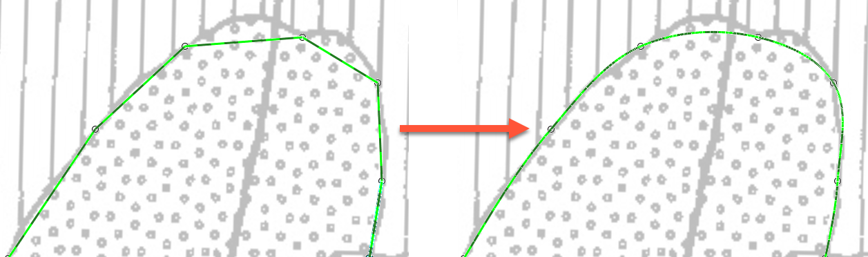

Although you can make the line curved while adding nodes, an easy way to draw a curved polyline is to simply click to add a series of points. Set the curvature of the whole line by selecting all segments and then clicking the Make selected segments curved button (
You can then make any adjustments to the curves required by dragging the segments or using the bezier control points.

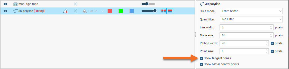

With the controls in the properties panel, you can change the size of different parts of the polyline to make working with the polyline easier.
For Ribbon width and Point size, the setting is, by default, in pixels, but both can be displayed in real-world size by unticking the pixels box, which may make editing the polyline easier in some circumstances.
You can also choose whether or not to show tangent cones and bezier control points.

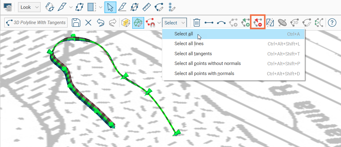

If you want to remove a tangent, select the tangent and click on the Remove all selected tangents button (
). To quickly remove all tangents, you can do any one of the following:
- Choose Select all tangents from the toolbar then click on the Delete selected items button (
) - Ctrl + Shift + Alt + T then hit the Delete key
- Choose Select all then click on the Remove all selected tangents button (
) - Ctrl + A then R

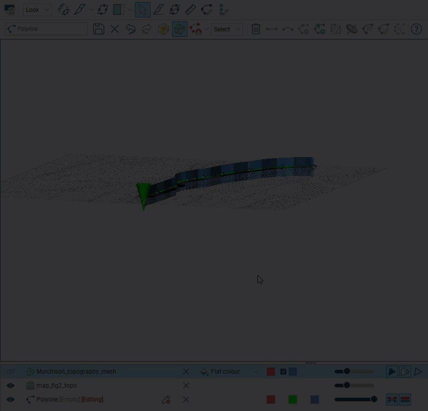

When a polyline has a tangent, it can be visualised in the scene as a ribbon. The Surface ribbon(
) and Normal ribbon(
) options help you to determine the orientation of the polyline in the scene. The surface ribbon reflects the orientation of the polyline and the normal ribbon is perpendicular to the surface ribbon.
For example, click on the Surface ribbon button (
) to determine which side of the polyline is positive (red) and which side is negative (blue):
If you are having trouble seeing the ribbons, you can change their size using the Ribbon width control in the properties panel.

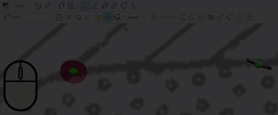

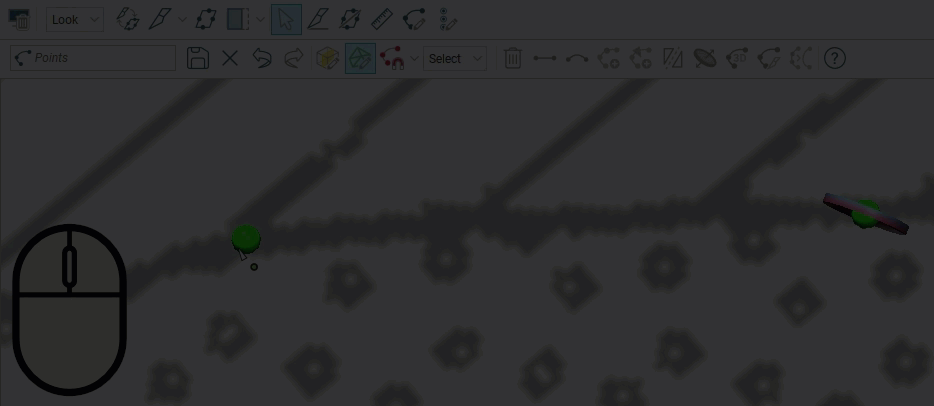

Drawing Points
Polylines can include points, which are drawn using the Draw points tool (
). Clicking adds a point, and clicking and dragging adds a point with a normal. Normals are shown in the scene as disks intersecting the points. The scene below shows one point with a normal and one without:
To move a point without a normal, switch to the Select tool (
). Click on the point and drag it. To add a normal to the point, click on it in the scene and click the Add disk button (
To edit the orientation of a point with a normal, click on it in the scene. There are two rotation modes, and a click on the disk will change between modes.
- In one rotation mode, yellow and blue arrows show how dragging the disk will change the dip and azimuth of the disk. The yellow arrows indicate the direction of rotation when you click-and-drag the disk. Change the position of the pointer on the disk to switch the rotation selection to the other pair of arrows.
- In the other rotation mode, an extended translucent disk extends out from the point at right-angles to the point’s disk. Around the edge of the disk are four blue arrows indicating the rotational direction. Click-and-drag the point’s disk to adjust the disk angle. Change the position of the pointer on the disk to change the angle of the rotation plane on the point’s disk.
You can also change the orientation of a disk by drawing over it. To do this, make sure the Draw points tool (
) is selected. Hold the cursor over the point you want to edit. The cursor will turn green to indicate that you can adjust the disk’s angle. Drag to adjust the angle and release the mouse button when finished.
You can also flip selected disks by clicking on the Flip tangents and disks button (
