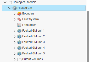

Each geological model is created with a Fault System object that is used to construct faults. Once the faults are active in the geological model, the geological model will be divided into separate fault blocks, which will appear in the project tree as part of the model. Here, the geological model has been divided into five fault blocks:
Each fault block has its own Surface Chronology, which can be modified without affecting other fault blocks in the geological model. There is no top-level Surface Chronology for the geological model once the Fault System has been activated. This means that lithology layers can be constructed for a faulted model in two ways:

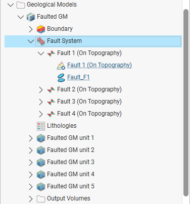

Faults (
) will appear in the project tree as part of the Fault System object (
) and can be expanded to show how they were created. Here, Fault 1 was created from a GIS line draped on the topography (
) and structural data (
Once faults have been created, you can modify them as described in Editing Faults.

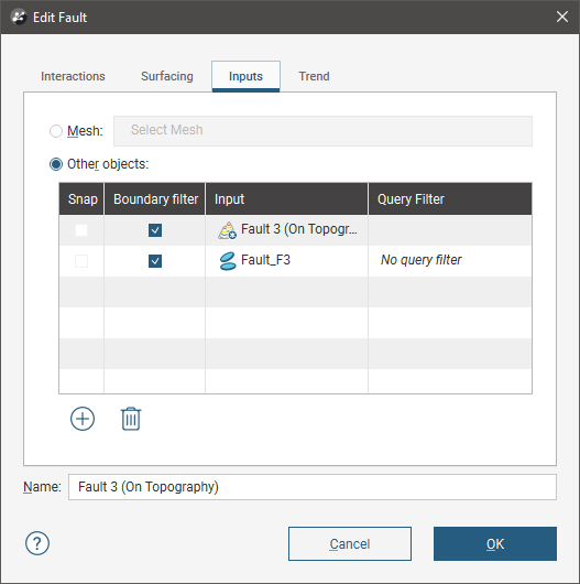

Changing Fault Inputs
For faults, the Inputs tab shows all the data objects used to create the fault and whether the Snap and Boundary filter options are enabled for each object used to define the fault. If an input has any query filters defined, you can select one in this window.
You can also replace the fault’s inputs with a single mesh or add more data to the fault.

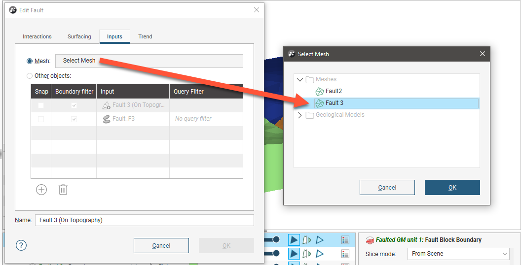

Replacing Fault Inputs With a Single Mesh
To replace the fault inputs with a single mesh, click on the Mesh option, then select from the meshes available in the project.
When you select a single mesh to define the fault, all other inputs listed in the Inputs tab will be removed from the fault. This can result in objects being deleted from the project. For example, if the fault has been edited using a polyline, the polyline will be deleted when the inputs are replaced with the mesh. If you wish to retain such inputs, be sure to share the object before changing the inputs. See Sharing Objects for more information.
The snap and boundary filtering controls in the Surfacing tab will be disabled as the settings from the geological model will be used. The settings in the Trend tab will also be disabled as it is not possible to set a trend for a fault defined from a mesh.
Adding Data to the Fault
To add more data to the fault, click on the Select Objects button, then select from the suitable objects available in the project.
Snap Settings for Individual Inputs
The Snap setting determines whether or not the fault surface honours a particular data object. Often, surfaces should honour drilling data and treat data objects such as polylines and GIS data as interpretations, as discussed in Honouring Surface Contacts. To change snap settings for a fault, click on the Surfacing tab and set Snap to data to Custom. You will then be able to change Snap settings in the Inputs tab.

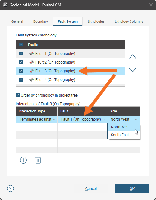

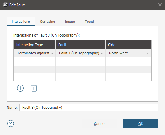

Fault Interactions
Once all the faults required have been created, you can start defining the interactions between the faults by double-clicking on the Fault System object. The Geological Model will be opened with the Fault System tab displayed:
The Order by chronology in project tree check box in the Fault System tab will change the order of the faults from alphabetical to chronological.
To add an interaction, click on a fault, then click the Add button. Select the Interaction Type and set how the faults interact:
Once you have defined each fault interaction, click OK to generate the fault system. Add the Fault System object to the scene to check that the faults interact correctly.
You can also edit fault interactions by double-clicking on individual faults. The Edit Fault window will open, which shows only the interactions for the selected fault:
Faults are not active in the geological model until the box is ticked for each fault in the Fault System window, as described in Activating the Fault System. This means you can check the fault system without regenerating the geological model.

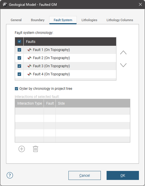

Activating the fault system divides the geological model into fault blocks, which can result in considerable processing time for complex models. It is important, therefore, to define fault interactions before enabling the fault system, otherwise a large number of fault blocks could be generated that significantly increase processing time. See Fault Interactions above.
To activate the fault system in the geological model, double-click on the Fault System object once again and tick the box for each fault. The model will be divided into separate fault blocks that can be worked with in a similar manner to the geological model as a whole.

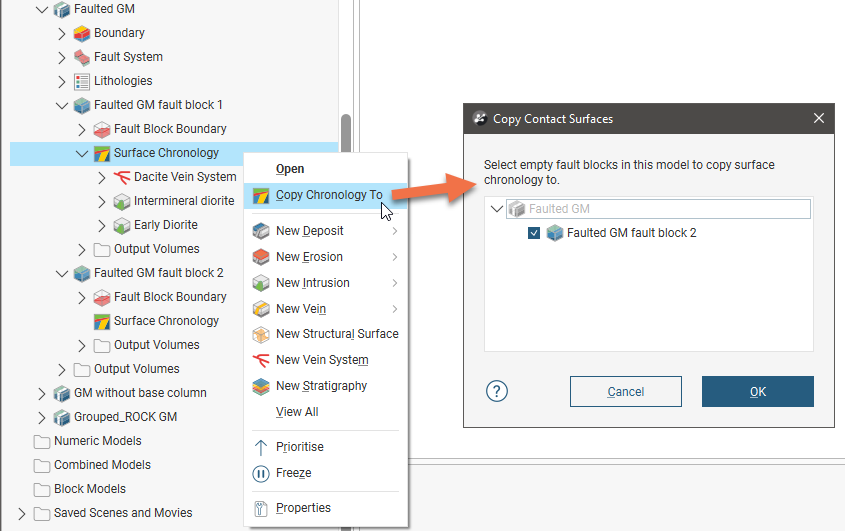

Copying the Surface Chronology to an Empty Fault Block
If you have defined the surface chronology for one fault block, you can copy it to other empty fault blocks. To do this, right-click on the Surface Chronology for which you have defined surfaces and select Copy Chronology To.
In the window that appears, select the fault blocks you want to copy contact surfaces to and click OK. The surfaces will be copied and you can modify them without affecting the surfaces in the other fault blocks.
Note that a fault block’s surface chronology must be empty before you copy surfaces from another fault block to it.

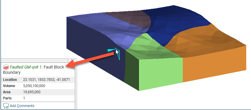

Faulted Model Display Options
Drag the model into the scene or right-click on it and select View Object; these options add the model to the shape list as a single object and you can change the visibility of each lithology by clicking the Edit Colours button. You can also add the model to the scene as a series of output volumes by right-clicking on the model and selecting View Output Volumes.
Another display option lets you view the individual fault blocks without displaying the lithology layers. Right-click on the model and select View Fault Block Boundaries.
To work with a specific fault block, click on it in the scene. The window that appears displays the name of the selected fault block:
You can also view the output volumes for each individual fault block by right-clicking on the fault block in the project tree and selecting View Output Volumes.
