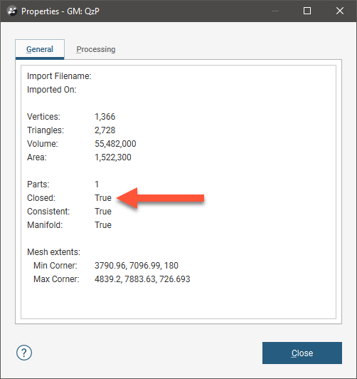

Meshes imported into Leapfrog Energy may exhibit geometries that cannot be used computationally by Leapfrog Energy. See Visualising Issues With Imported Meshes for information on how to identify issues with imported meshes.

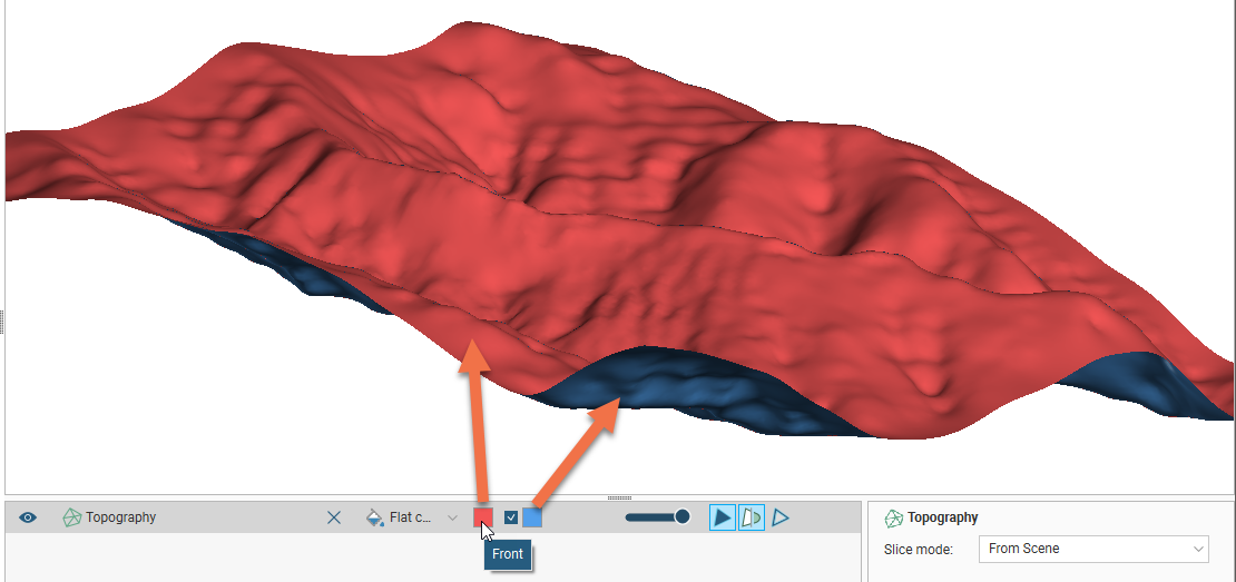

Leapfrog Energy assigns different colours to each side of a surface, according to the polarity of the surface.
See the Polarity in Leapfrog Energy for more information about the polarity of surfaces.

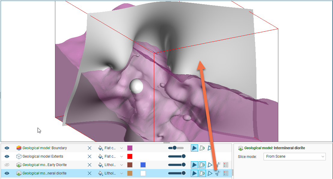

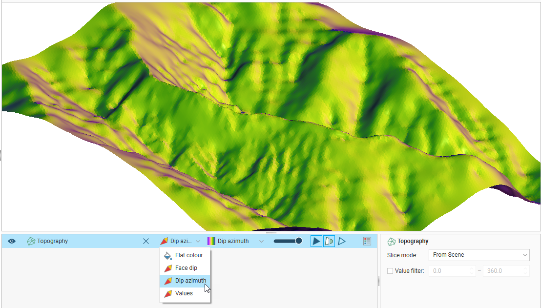

Many meshes in Leapfrog Energy can also be displayed using other properties, such as the Dip azimuth of the surface, which can be useful in highlighting areas of the surface that change direction rapidly:

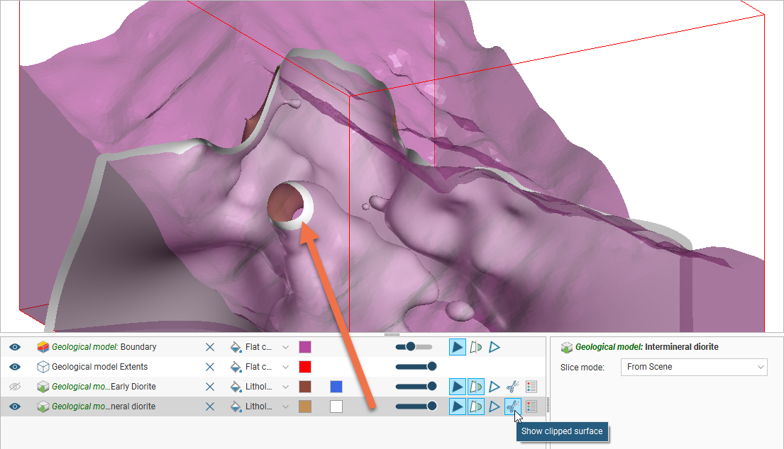

Disable the Clipped surface button () to view the surface unclipped:

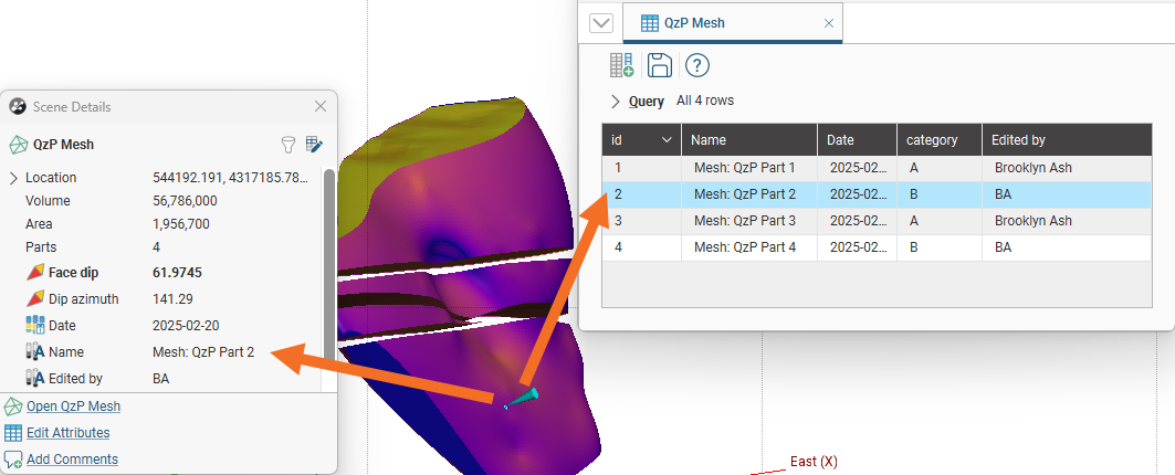

Leapfrog Energy supports the import of attributed meshes in GOCAD (*.ts) and Leapfrog Energy Attribute Binary Mesh (*.msh, *.ara) file formats. You can display such meshes using an attribute by selecting the attribute column from the view list.

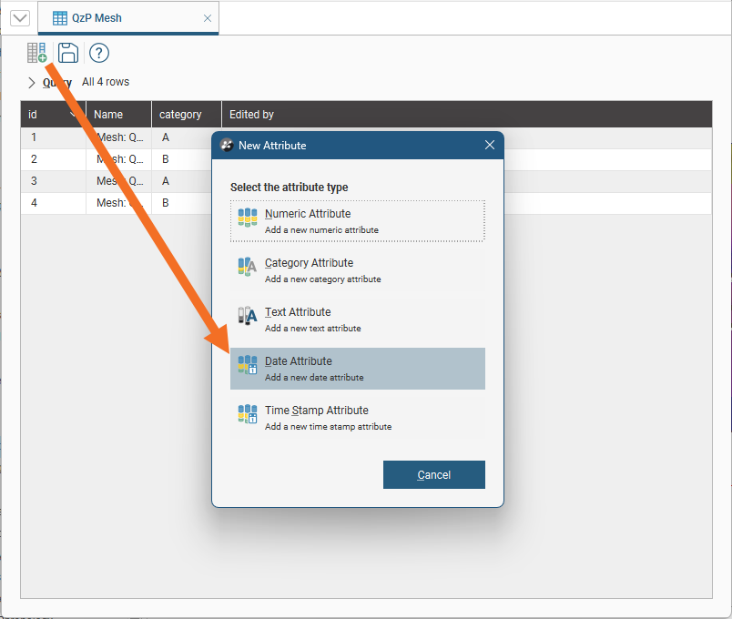

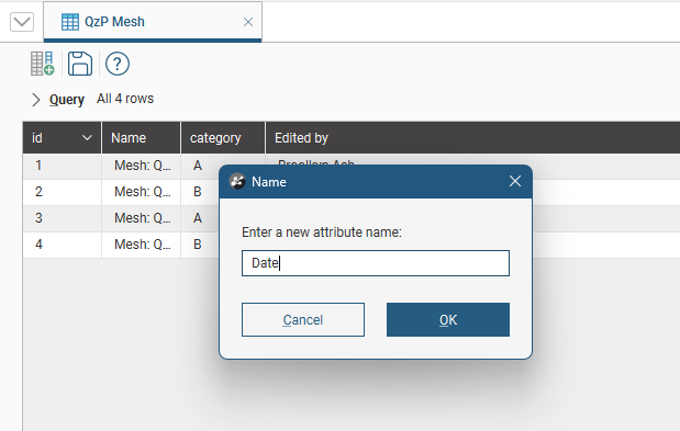

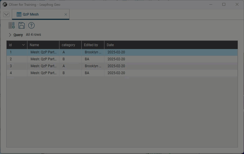

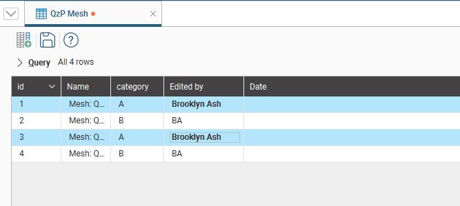

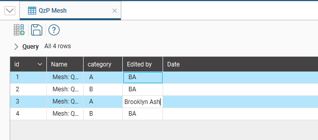

You can assign attributes to a mesh, which adds a new column to the mesh object. To do this, right-click on the mesh in the project tree and select Attribute Table. In the window that appears, click the Add a new attribute column button (). In the window that appears, select the attribute type:
This column order will be used when the attribute table is exported along with the geological model when using the LFM format.

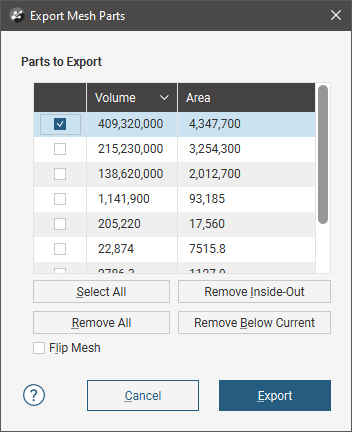

Exporting a Single Mesh
Next, select the format required and where to save the exported meshes. Available formats for bulk export are:
  • Leapfrog Model Files (*.lfm)
  • Leapfrog Attribute Binary Mesh Format (*.msh)
  • GOCAD Files (*.ts)
  • Surpac Files (*.dtm, *.str)
  • Gemcom Files (*.tri)
  • Datamine Files (*_pt.asc, *_tr.asc)
  • Micromine Files (*_MMpt.dat, *_MMtr.dat)
  • DXF Polyface Files (11/12 [AC1009]) (*.dxf)
  • Alias Wavefront Object Files (*.obj)

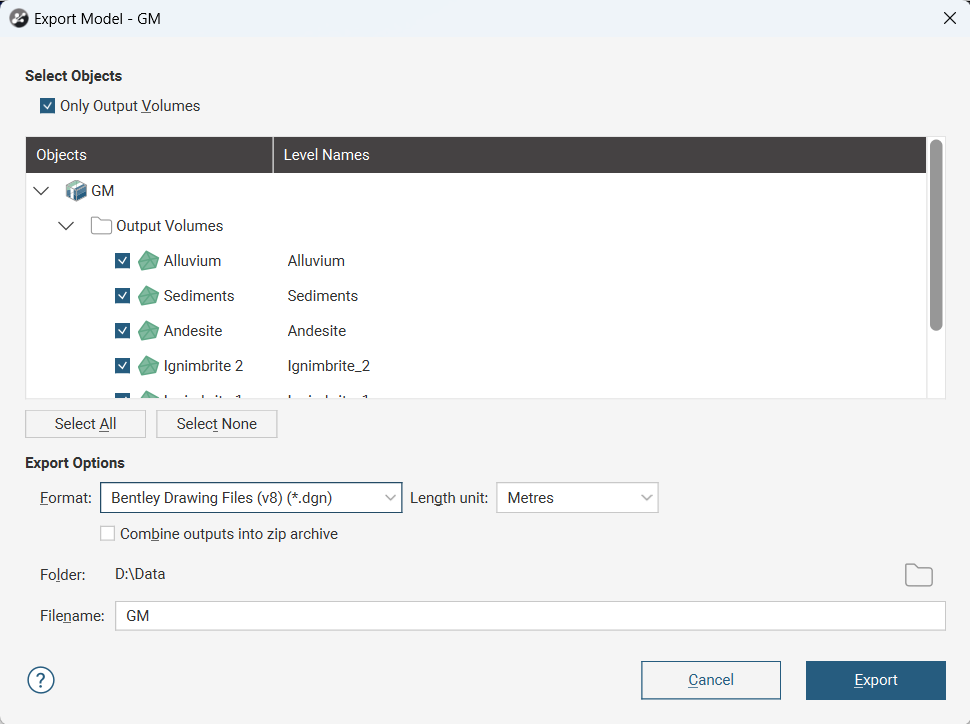

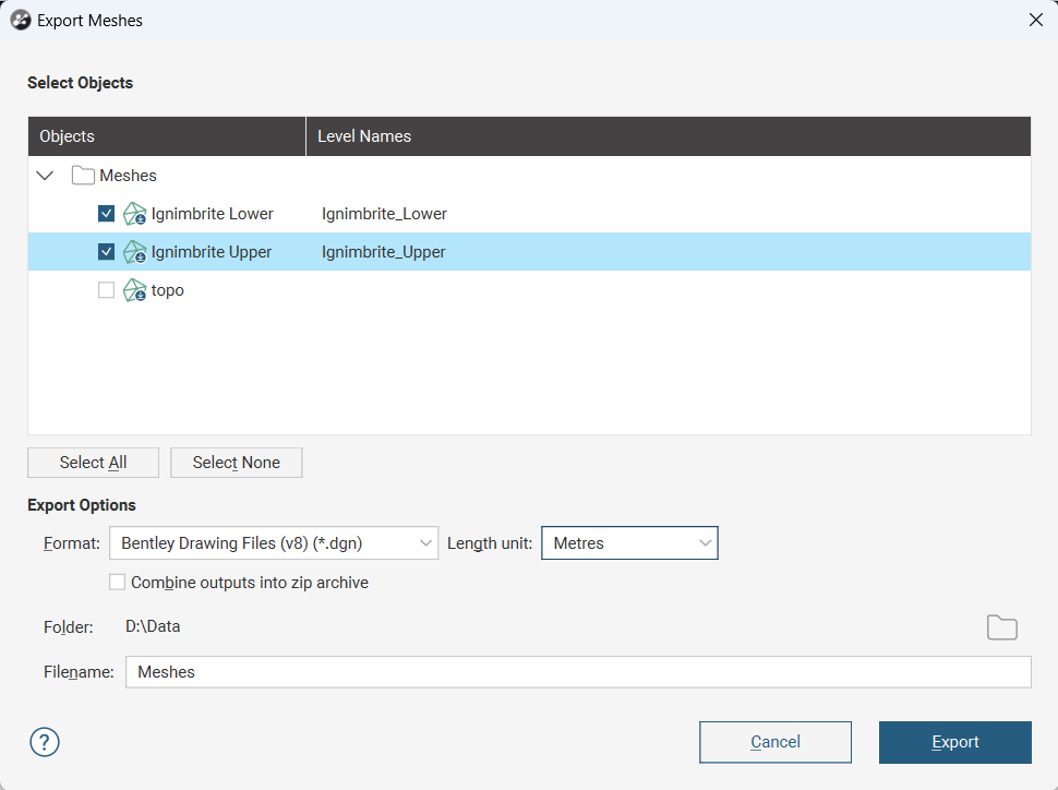

When exporting in Bentley Drawing Files (v8) (*.dgn) format, a Length unit needs to be specified.
For any of the export options other than Leapfrog Model Files format, you can select Combine outputs into zip archive to save the meshes as a zip file.
