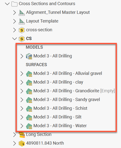

Objects evaluated onto a section will appear in the project tree under the section object, categorised into MODELS and SURFACES.

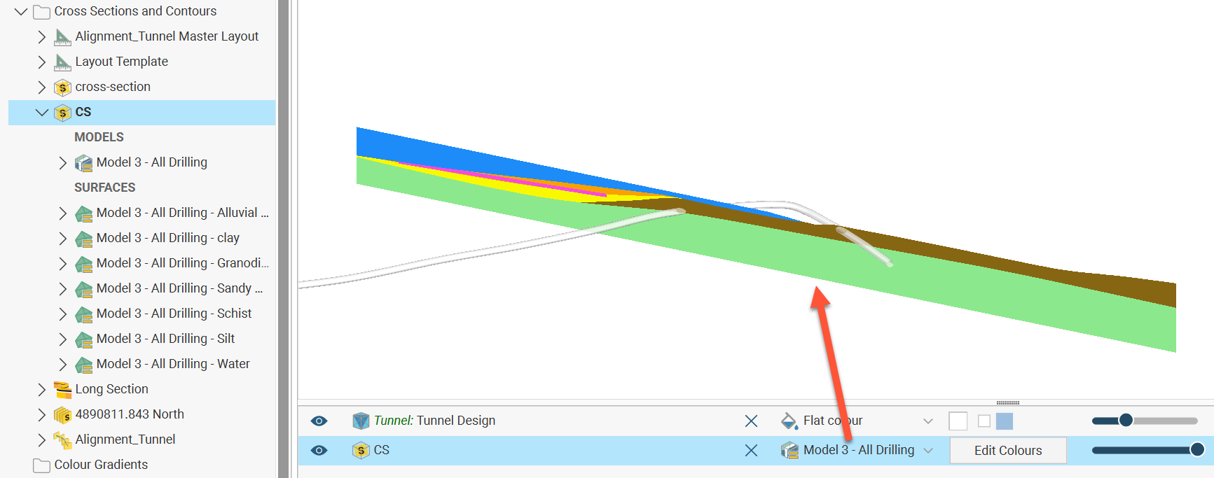

When a section layout or layout template is created and objects are added to it, they are automatically added as evaluations onto the sections the layout is applied to. However, if it is desirable to define a section without a section layout and specify what is evaluated onto the section, you can create the section, then right-click a top-level section in the project tree and select Evaluations. In the Select Objects To Evaluate window, move objects from the Available Objects list to the Selected Objects list. You can then add the section to the scene to view the evaluations on the section in the scene.

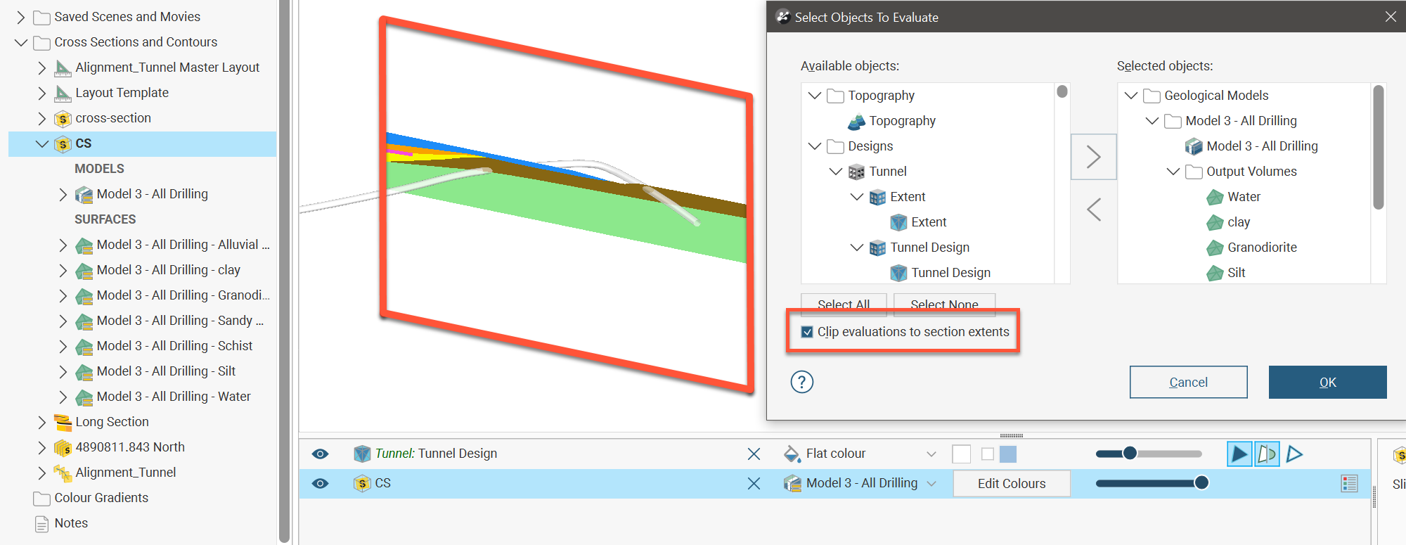

Limiting Evaluations to Section Extents

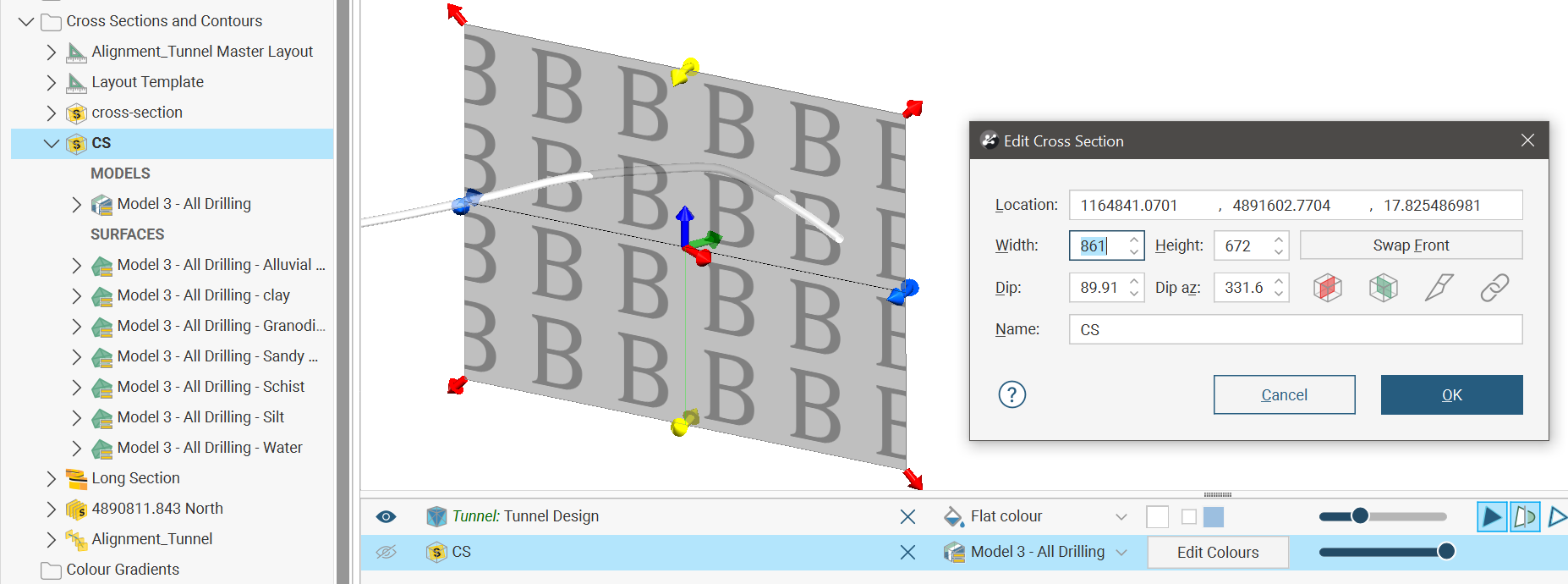

When evaluating objects on sections, you can limit the evaluation to the section extents. To do this, enable the Clip evaluations to section extents option when selecting what objects you are evaluating. This will ensure that the section appears in the scene at the same dimensions as specified when the section was defined.

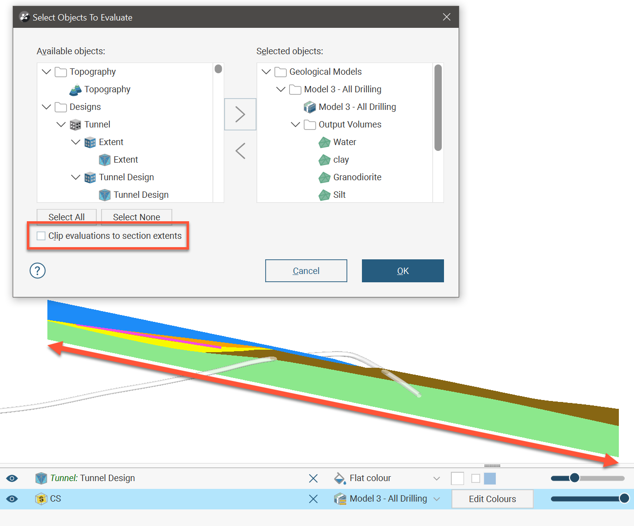

When Clip evaluations to section extents is unticked, the evaluation will continue along the plane of the section to the extent of the evaluated object.

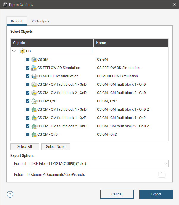

To export a section in one of these formats, right-click on the section in the project tree and select Export. In the window that appears, select the evaluations you wish to export with the section:
If you wish to change the name used for exporting one of the evaluations, double-click on its name, then enter the new name.
