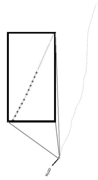

The SEG-Y file My2D.sgy contains 6000 traces. You may limit the portion of the survey to be exported by setting the start trace to "100" and the ending trace to "500", leaving 401 traces. You may also elect to subsample the survey by keeping only every 4th trace, keeping traces 100, 104, 108, ..., leaving 101 traces. The figure at right shows the original (full) trace locations in grey, and the subsampled and windowed trace locations in black. The inset shows a close-up of the individual trace locations.
