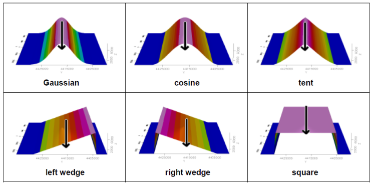

For roll-off method, you may choose from one of six tool shapes, shown below, or select a "constant" value to fill the area. You may use a polygon file to clip the effective area of the Path Edit function.

From the dropdown Edit tool list, select from one of the seven options that determine the shape to be used.
Enter the Tool height in grid units.
Enter the Tool width in ground units, as specified in the Data view of the map. All tools except "square-wave" and "constant" taper to zero at this width.
