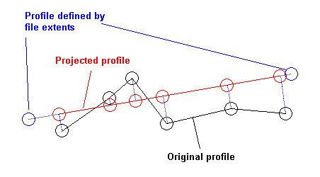

Minimum and Maximum (X,Y) data extents are used to define the line onto which the X,Y coordinates are projected to generate the model X-coordinates.
The calculated model X-coordinates and the calculated min/max Z-coordinates of the profile define the "Full" view.
CVTGMS saves all of the coordinate transform information in the .ECS file, so that the projected (X,Y,Z) coordinates may be recovered when a
This process will "straighten" profiles that "bend" and that the original Y-offset from the profile cannot be recovered.
