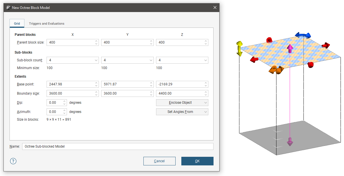

Creating an Octree Sub-Blocked Model
To create a new octree sub-blocked model, right-click on the Block Models folder and select New Octree Block Model. The New Octree Block Model window will appear, together with a set of controls that will help you set the size, location and orientation of the model in the scene:
The block model is defined from its Base point, and the reference centroid is the Base point plus one half the Block size. Block models extents always include complete blocks, even when sub-blocking, and when changes are made to the Block size parameter, the model’s extents will be enlarged to fit the Block size.
Model Extents and Rotation
It is a good idea to set the octree block model’s extents from another object in the project, selecting the required object from the Enclose Object list.
The Dip and Azimuth set the rotation of the model. If you know the values you wish to use, enter them in New Octree Block Model window. You can also:
  • Use the controls in the scene to set the orientation. The yellow handle adjusts the Dip and the blue handle adjusts the Azimuth.
  • Use either the slicer or the moving plane to set the orientation. To do this, add the slicer or the moving plane to the scene and adjust the orientation. Then select the object to use from the Set Angles From list.
If you have set the extents from another object and then rotated the model, you will need to reset the extents by selecting the object again from the Enclose Object list.
The Grid Pattern
The cross-hatched pattern shows how the parent blocks will be divided into sub-blocks. These properties can be changed by adjusting the Parent blocks and Sub-blocks settings. The Sub-block count is the maximum number of divisions a parent block can be divided into in a particular direction when it intersects a trigger. Note the block can only be divided into numbers of divisions that are a power of two to a maximum of 64, as the sub-blocking strategy is to repeatedly divide units in half. Variable height sub-blocks are not supported in octree block models.
Here the block size is 100 and the sub-block count is 4 x 4 x 32, so blocks will range in size from 100x100x100 down to 25x25x3.125. Note the variety of sub-block sizes as the sub-blocking is triggered on the geological model surfaces, two of which are shown (in red and blue):

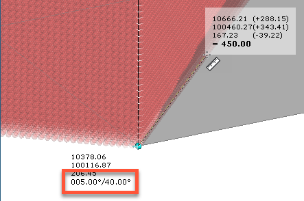

Next, click on the point with the lowest X, Y and Z position. You will see an info box with the point’s coordinates.

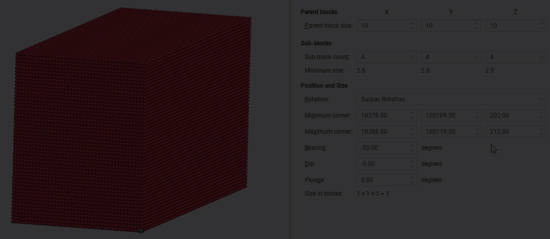

Next, right-click on Block Models in the project tree and select Import Octree Block Model. Select the *.CSV file again, then position the Import Octree Block Model window and move and scale the scene view so you can see at least the minimum corner point in the scene:
Copy the selected point coordinates into the Minimum corner, then add a bit to the coordinates and enter those values in the Maximum corner fields. We will adjust these numbers later, so precision is not important at this stage.
Use the ruler to draw along the edge of the points. Note the orientation in degrees. While these will not give you the numbers to enter in for the next step, it should provide some helpful hints.
Select Surpac Rotation from the Rotation options, then change the Bearing, Dip and Plunge fields so the block model preview box aligns with the points. The values should make sense with respect to the measurements found using the ruler; for instance here the Bearing of -50° is equivalent to a bearing of 310°, and the Dip of -5° is related to the 5° measurement in the second image, above.
Next, change the Maximum corner values to the size of one parent block larger than the Minimum corner values. The block model preview box should appear as a box near the minimum point in the scene, but it will be offset from that minimum point. Adjust the Minimum corner and Maximum corner points down until the box is nicely enclosing the minimum point. As there is a small amount of leeway allowed for in the import, you do not need to be super precise, but try to align the centroids of the cube and the point sphere as best you can.
You might have to go back and forth a bit to fit the box around the sphere, refining the position a little more each time.
Change the Maximum corner values until the block model preview box just surrounds all the points. Because the block model is defined only in terms of parent block sizes, the Maximum corner will jump in steps as the number of parent blocks increases or decreases.
Finally, zoom in and check the block model preview box is just enclosing all the points, indicating that the origin is well positioned and the dimensions and orientation are correct. When you are satisfied, click the Import button. The octree block model will be imported and will be added to the Block Models folder in the project tree.
