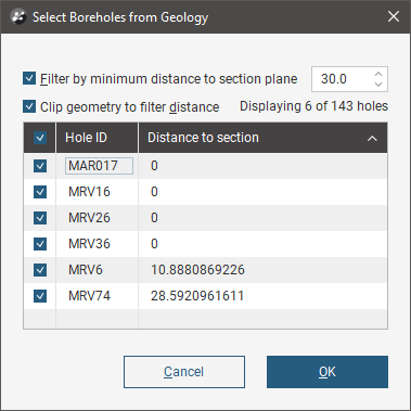

The Drillholes folder contains all drillholes and planned drillholes that have been added to the section layout. To add drillholes to the section, right-click on the Drillholes object and select either Add Drillholes or Add Planned Drillholes.
When adding a drillhole projection, you will be prompted for the interval tables to display; more than one can be selected. Each table will be added as a separate item below the Drillholes folder.
When you click OK the drillhole is added to the layout tree. It will be flagged with No Selection.
Select the new drillhole and double-click it to open a window to select boreholes. Use the filtering options to determine the limits for the projection of the drillholes onto the section based on the minimum distance from any point on the drillhole trace to the section plane, and select from the filtered list of drillholes which should be projected.

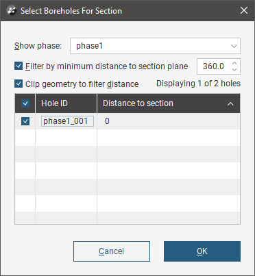

When adding planned drillholes, you can select from the available planned drillhole drilling phases, or select all phases. Then use the filtering options to determine the limits for the projection of the drillholes onto the section based on the minimum distance from any point on the drillhole trace to the section plane, and select from the filtered list of drillholes which should be projected.
For both the drillhole and planned drillhole projections, the drillhole selection window offers the option to Clip geometry to filter distance. With this selected, only the parts of boreholes that are within the specified minimum distance will be projected onto the section.
With Clip geometry to filter distance unchecked, if part of a drillhole is within the minimum distance specified, the whole drillhole will be projected onto the section.

- The drillholes copied to the layout will depend on the type of section the layout is being copied from and whether or not a filter is set for the layout:
- If no distance filter was set for the original layout, all drillholes selected for the original layout will be copied.
- If a distance filter was applied to the original section, the filter will be applied and drillholes selected that are within that distance of the section to which the layout is being copied.
- When the original layout is from a long section, drillhole evaluations will not be copied with the section layout.
