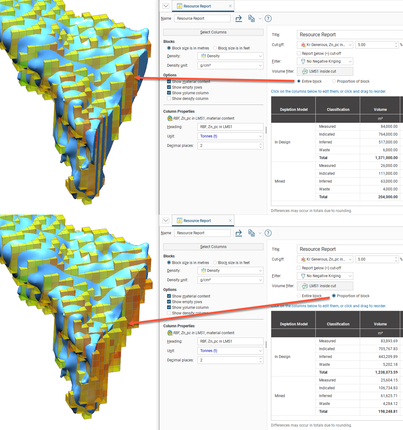

If you select one of the options in the Volume filter dropdown, only blocks within the selected volume will be reported on in the report. If Entire block is selected, an entire block will be included in the report as long as the block centroid is within the volume being used as a filter. If Proportion of block is selected, only the proportion of a block that is within the selected volume will contribute to the report.
It is also possible to select None as a Volume filter so the reporting will not be restricted.

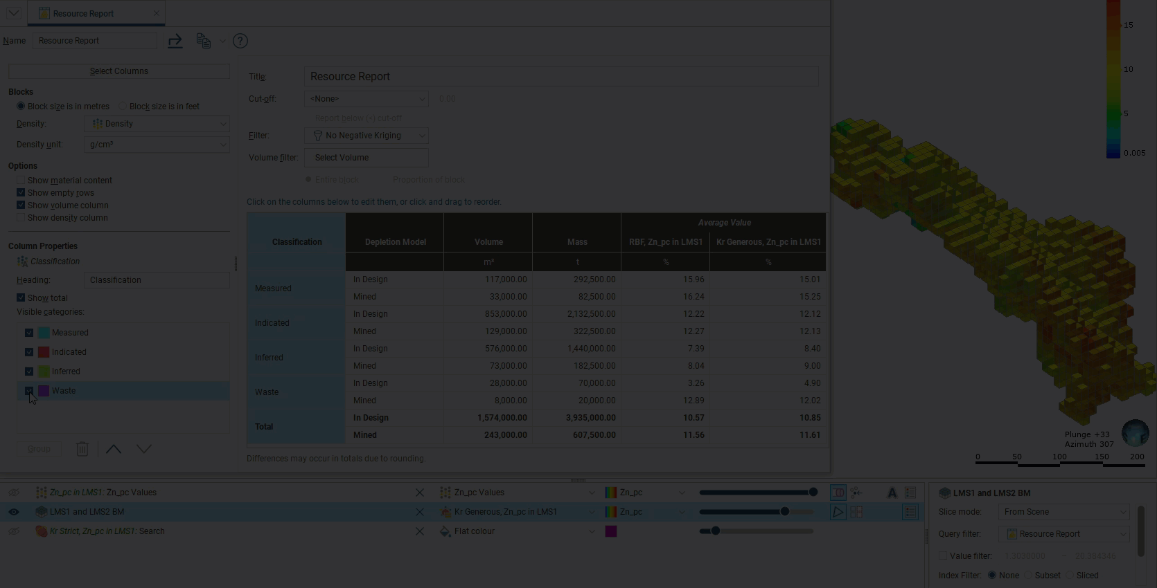

When you have a report open, you can use the category selections and other filters in the report to filter blocks in the scene.
Detach the dockable report tab and position the window so you can see both the report and the scene. With a block model selected in the shape list, the shape properties panel has a Query filter selector. The name of the report should appear in this dropdown list. When the report is selected, the blocks shown in the scene will only be the blocks the report is reporting based on the Visible categories selected, the Cut-off specified, that satisfies the Filter used by the report (if any), and is within any selected Volume filter.
