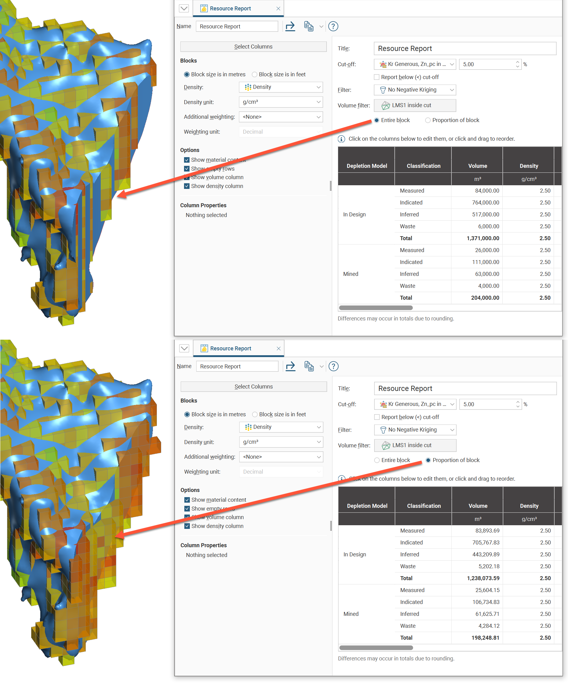

If you select one of the options in the Volume filter dropdown, only blocks within the selected volume will be reported on in the report.
- If Entire block is selected, an entire block will be included in the report as long as the block centroid is within the volume being used as a filter.
- If Proportion of block is selected, only the proportion of a block that is within the selected volume will contribute to the report.
It is also possible to select None as a Volume filter so the reporting will not be restricted.

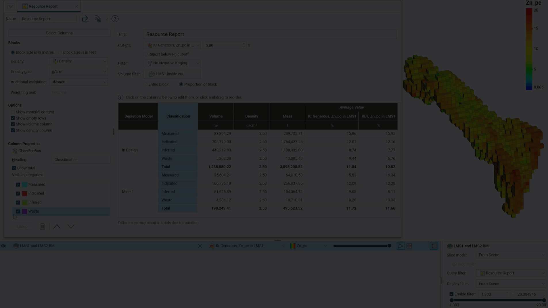

Click on a column to customise how the information is displayed. You can change the column title by editing the Heading field.
Enabling Show total will add a category row called Total with a summation for the categories. Any row that is a summation of categories will appear in bold in the table. It is possible to get a sub-total of some of the categories by grouping them, and these will also be shown in bold. To group categories, select multiple items in the Visible categories list by holding down the Ctrl key as you click the mouse. Click the Group button to add the new category.
Note that some of the Visible categories can be unticked to hide them; these hidden categories can still be included in a grouped category:
Select a category and click the up or down buttons to reorder them in the list. Delete a grouped category by selecting it and clicking the Delete button (
If there are multiple category columns, these can be reordered to select one as the primary categorisation, with the others shown as sub-categories. Click anywhere in a category column and drag it to a new location. While you hold down the mouse button, a vertical bar will appear where the column will be inserted:

In Leapfrog Geo 2023.1 there may be a small difference in the values in a report using proportion of block volume filtering compared to the values in reports from earlier versions. Leapfrog Geo 2023.1 introduced some improvements to how proportions are calculated and combined. Because computers do not store real numbers but convert them to binary, this can result in slight imprecisions when combining volume proportions that should add up to a whole 1. With the improvements introduced in Leapfrog Geo 2023.1 that ameliorate this effect, there can be a slight change at about the fifth or sixth significant figure in reports making use of the proportion of block volume filter.
Proportions of Proportions Not Advised
When Additional weighting is set to something other than <None> while Volume filter is set to Proportion of block, Leapfrog Geo shows a warning: Applying both a Proportion and a Weighting to the same block may affect the resulting calculations. This standard caution is displayed to make sure the combination being selected makes sense.
Often, it is not advisable to use a stored proportion Additional weighting along with a Volume filter. This is because the report would be calculating a proportion of a proportion. To make this calculation assumes these proportions can be simultaneously applied, which may not be the case, resulting in incorrect results. If the Additional weighting selected is not a volumetric proportion, there should be no conflict with a Proportion of block.
This matrix shows the results of the combinations of the volume filter’s Entire block and Proportion of block options against Additional weighting being selected as none or the volume of interest. The line crossing through the boxes shows part of a closed mesh volume. Blocks shaded grey have their block centroids within the mesh volume. Note that even though the same volume of interest is used in all cases, when both Proportion of block and Additional weighting are applied at the same time, the values in the blocks are undervalued because the proportion has been applied twice.
| Entire block (where centroid is inside mesh volume) | Proportion of block inside volume filter determined by mesh | |
| Additional weighting = <None> |
| Additional weighting of proportion inside mesh |
Note that the combinations:
- Additional weighting = <None> plus Proportion of block volume filter
- Additional weighting = proportion of block inside volume plus Entire block volume filter
do not result in precisely matching data. Take note of the dark green boxes that depict blocks with the block centroids outside the volume of interest. The Entire block volume filter selects only blocks that have the block centroid within the volume, so these dark green blocks get 0 values. When Proportion of block is used, even though the block centroid is outside the volume, the amount of the block within the volume is assigned as a value. Each approach is valid, and which you choose depends on the result you want to achieve.
The effect of proportions-of-proportions undervaluing estimates is further illustrated using this simplified example. The geological model comprises three layers, with the middle layer being a rich ore-bearing layer topped with an overburden of waste rock. An isosurface shell has been created using the limited drilling data identifying a region of rich ore, and a simple block model has been created between the drillholes.
A resource report using the mesh shell as a volume filter calculates 78.7t of material in the blocks.
Another mesh called “removed” models the removed overburden that was all waste rock with no ore. It has been used to create a stored proportion column for the block model, indicating the percentage of each block outside the “removed” region. If this proportion is used as an additional weighting for the resource report along with a volume filter, two independent volume-weighted proportions are being applied, resulting in an inaccurate result. We would intuitively expect that because the removed rock is all waste overburden, that the reported material content should not be substantially different, but because each block has been scaled by the value calculated in the proportion column, the material content is now reported as 71.1t.
