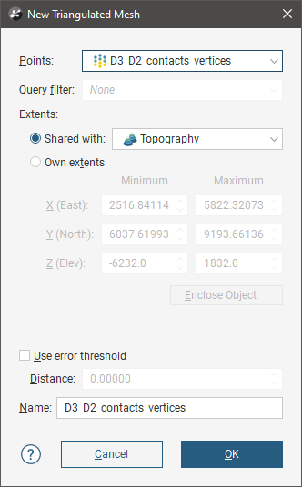

The steps for creating a mesh from data in the project are similar, regardless of the data used to create the mesh. To create a triangulated mesh from data in the project, right-click on the Meshes folder and select from the New Triangulated Mesh options.
Here, a new triangulated mesh is being created from points:
Select the required object from the list.
When defining the mesh’s extents, you can set the extents to be independent of other objects in the project (Own extents) or you can use the extents of another object (Shared with). When you select the Shared with option, the mesh will be updated when the extents object it shares is updated.
The Use error threshold setting is useful when you are working with very densely spaced data. The error threshold works by excluding points that don’t have an offset in a normal direction relative to the average gradient of the points in that area. For example, if the threshold is set to 10 and the difference between one point and its neighbour is less than 10, this point will be excluded and the triangle will be fitted to the next point that is above the threshold.
When Use error threshold is disabled, the mesh will follow all the data, which could require considerable processing time if you have a large data set.
There will always be a trade off between the accuracy of the data and the processing time for the surface.

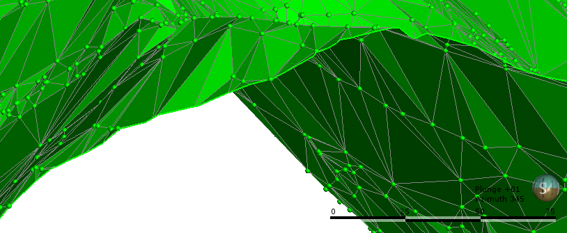

Here, a mesh created from points has the Use error threshold disabled. The mesh follows all the points:

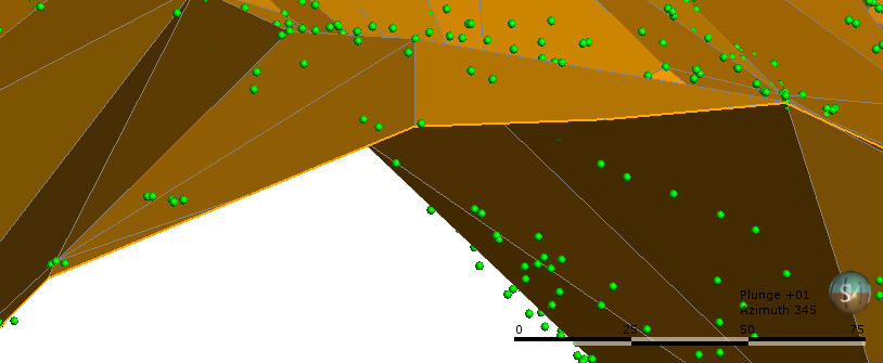

Here, a mesh has been created with the Distance set to 20. The mesh ignores points that fall outside the threshold:

Enter a name for the new mesh and click OK.
