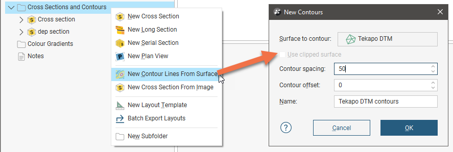

To create contour lines from a surface, right-click on the Sections, Plans and Contours folder and select New Contour Lines From Surface. In the New Contours window, select the surface to contour from the list. In this example, a mesh has been selected:
Adjust the Contour Spacing, if required.
If you want to offset the contours by a vector, enter a Contour offset value.
Click OK to generate the contours. The new contours will appear in the project tree under the Sections, Plans and Contours folder.

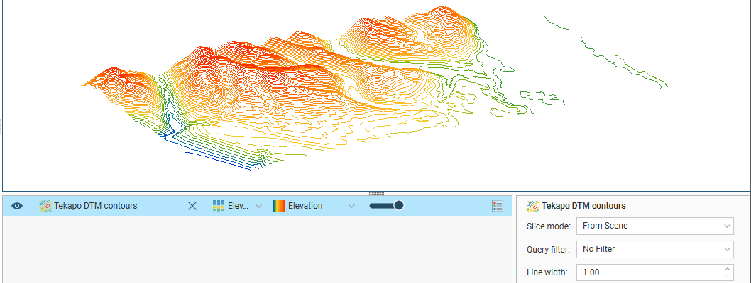

Here the contours based on the Tekapo DTM are displayed in the scene:
You can edit the contours by double-clicking on them.

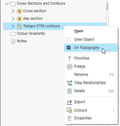

Contours can be displayed in the scene draped on the topography. First, however, you need to drape the contours on the topography. To do this, right-click on the contours in the project tree and tick the On Topography box:

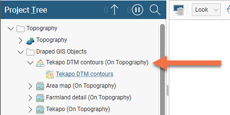

The draped version of the image will be added to the Draped GIS Objects folder under the Topography folder:

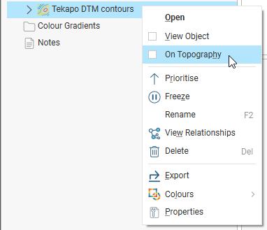

To remove contour lines from the topography, right-click on either the contours of the draped copy in the Draped GIS Objects folder and untick the On Topography box. For multiple objects, select Remove From Topography.
