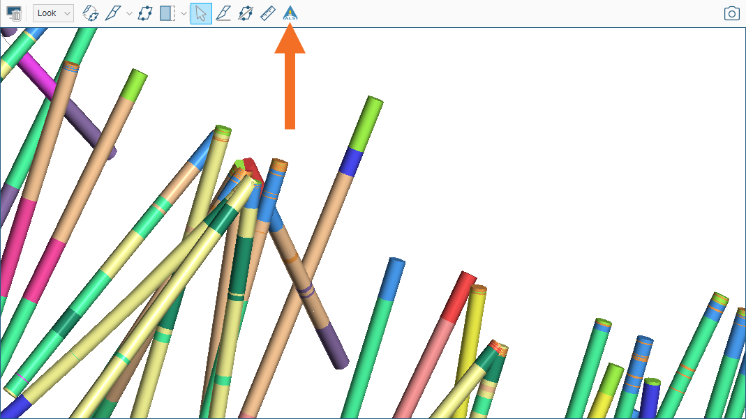

Click OK to save the information. If login is successful, the ALS Core Photo Link button (
) will appear in the toolbar:

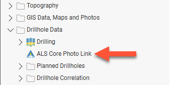

A link will also appear in the project tree as part of the Drillhole Data folder:

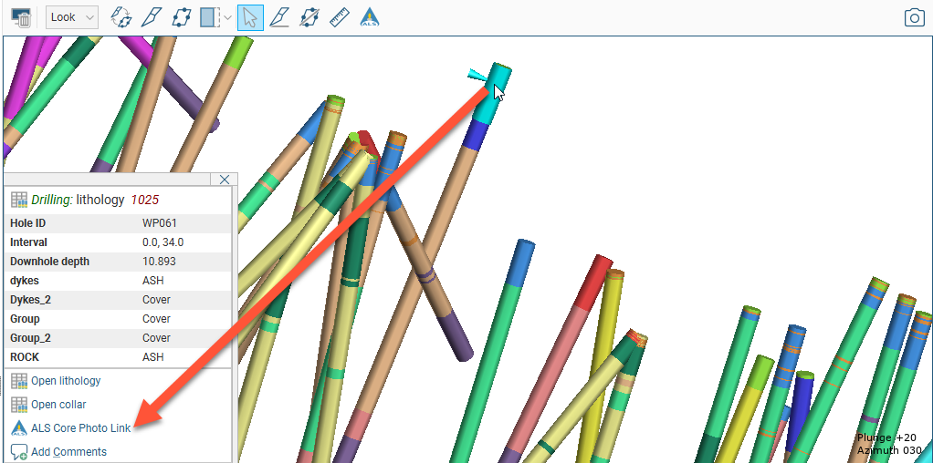

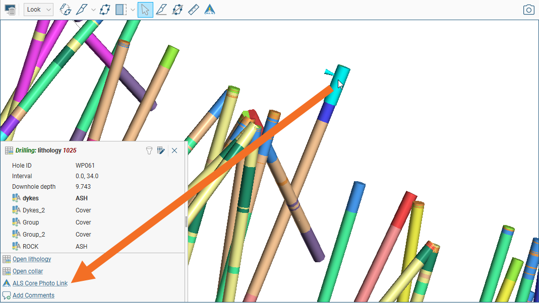

To view core photos, click on a drillhole in the scene, then click on the ALS Core Photo Link button in the window that appears:

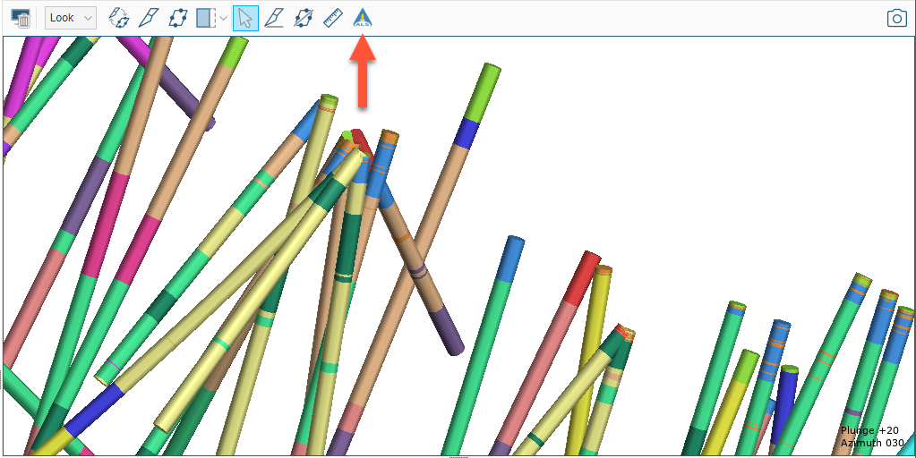

The ALS Core Photo Link button (
) in the toolbar allows you to view core photos in your browser in rapid succession. To do this, first make sure you are already logged into the database. Then click on the ALS Core Photo Link button (
) to enable the rapid viewing mode. Each time you click on an interval in the scene, the core photo link will open in your browser.

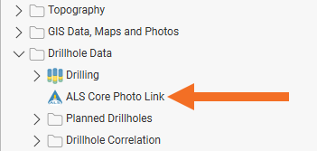

Removing the ALS Link
To remove the ALS link, right-click on it in the project tree and select Delete.
