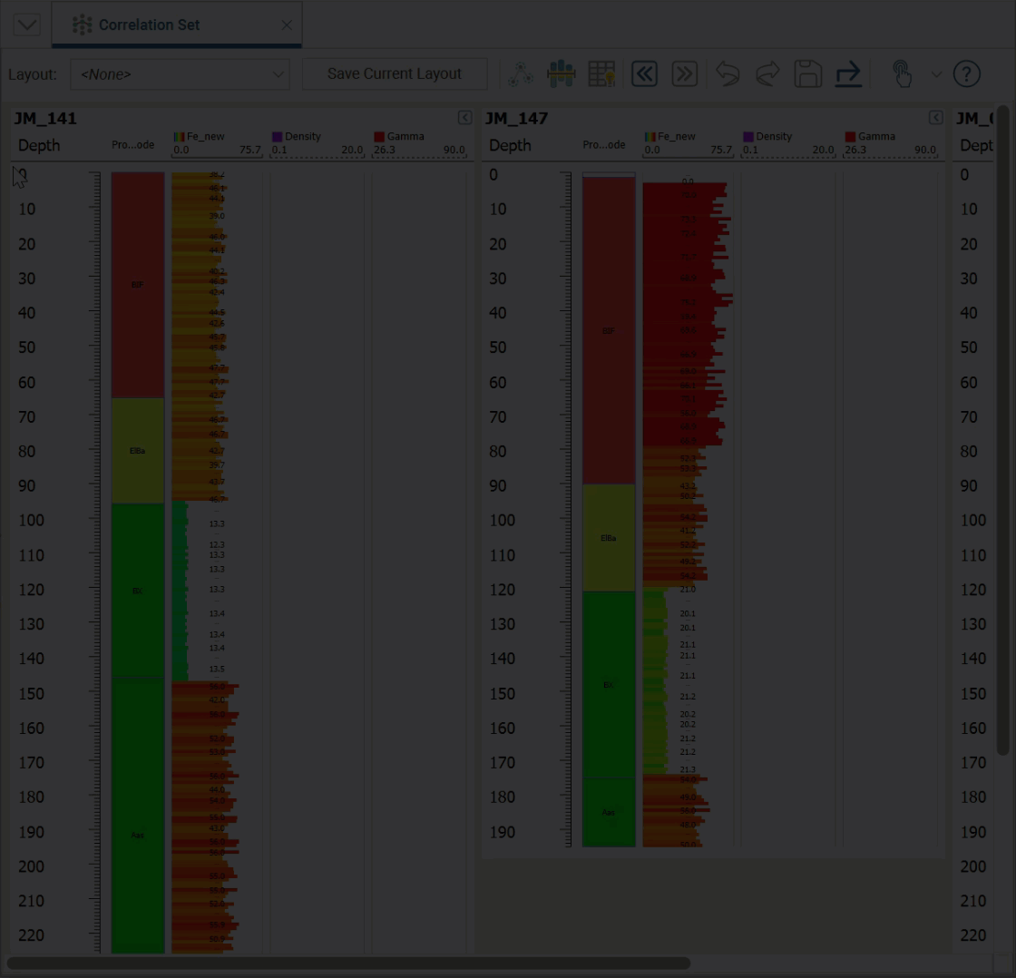

). The selected collars will be added to the correlation set window:
The Correlation Set Window
Each drillhole is represented by a vertical panel that can display several columns of information. You can change the sequence the drillholes appear in by clicking-and-dragging the collar to a new position. A vertical line will appear where the drillhole will be repositioned.

Add data columns you want displayed for each drillhole by dragging-and-dropping data columns from the project tree somewhere onto a drillhole panel. Depending on whether the data is category or numeric, interval or points data, the default appearance of the data column will be set appropriately. This visual formatting can be adjusted to suit your preference or internal standards.
The sequence of data columns can be changed by clicking-and-dragging the column. A vertical line will appear where the column will be repositioned.
