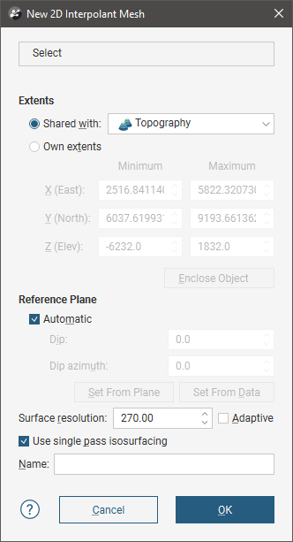

To create a 2D interpolant, right-click on the Meshes folder and select New 2D Interpolant Mesh. In the window that appears, select from the points objects available in the project.
The mesh’s extents can be independent of other objects in the project or you can use the extents of another object. Surface resolution can be adaptive or non-adaptive. You can set a reference plane to set the direction of the best fit through the data; this is useful when working with data that is not primarily horizontal.
