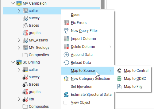

To remap to a different data source, right-click on a table and select one of the Map to Source options:
Whatever option you choose, the process is to select the new source, then check that the source content matches that already stored in the Leapfrog Geo project. You cannot add or remove data columns from the import; you are simply mapping the columns from the new source to the data already in the project.

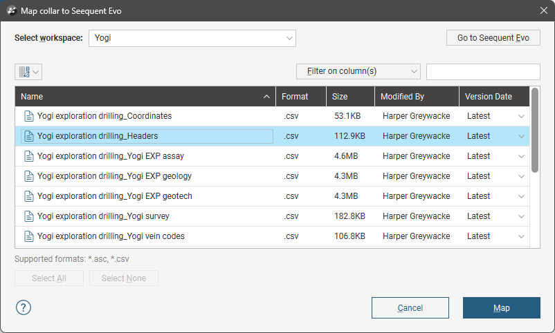

Mapping to Seequent Evo
The Map to Seequent Evo option is only available if you have Seequent Evo.
For Map to Seequent Evo, you can choose from the files stored in a Seequent Evo workspaces. Select which workspace you wish to use, then choose from the files available.
Click Map to display the file and check that the columns in the file match those already in the project. Next, click Finish to complete the remapping of the data source. You can then reload the table using one of the Reload From Seequent Evo options.
See Importing Data from Seequent Evo for more information on importing and working with data from Seequent Evo.

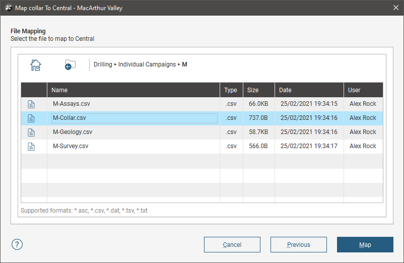

Mapping to Central
The Map to Central option is only available when you are working in a Central-connected project.
For Map to Central, you can choose from the files that have been stored in a Central project. Select from the Central projects available, then select from the files available for that project. Here, a project’s collar file is being remapped and the M-Collar.csv file has been selected:
Click Map to display the file and check that the columns in the file match those already in the project, then Finish to complete the remapping of the data source. You can then reload the table using one of the Reload From Central options.
See Importing Data From Central for more information on importing and working with data from Central.

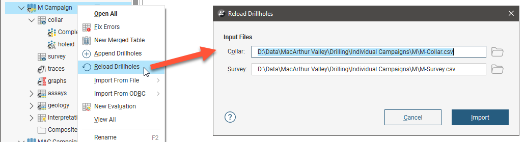

When a drilling dataset has a mixture of file sources, the Reload and Append options for the dataset as a whole will match the mapping of the collar table. For example, if the collar table is mapped to a local file, reloading the drilling dataset will only reload tables that are mapped to local files. For example, here the collar and survey files are mapped to local files, whereas the assays and geology tables are mapped to Central files:
The Central-mapped files will need to be reloaded on a one-by-one basis.

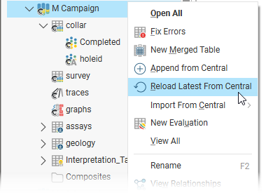

Here the Reload and Append options available for the drilling dataset are those of the collar file, and the drilling dataset is marked with the Central symbol:
In this example, reloading from Central will update the tables with the latest version available on Central, and the local-mapped files will need to be reloaded on a one-by-one basis.
