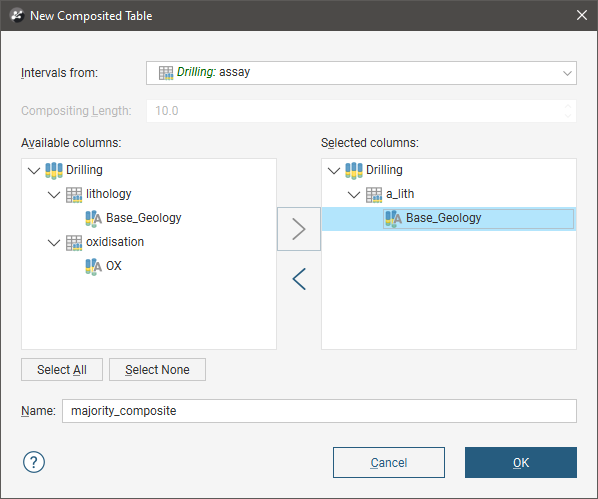

Drilling data is composited from the Composites folder, which is in the project tree as part of each drilling dataset. To create a majority composite, right-click on the Composites folder and select New Majority Composite. The New Composited Table window will appear. Select the interval table that will be used to specify the intervals for the new majority composite or specify a fixed Compositing Length. Next, select the columns that will be composited.

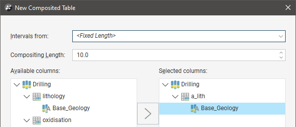

You can also used fixed-length intervals by selecting the Fixed Length option from the Intervals from list, then setting the Compositing Length:

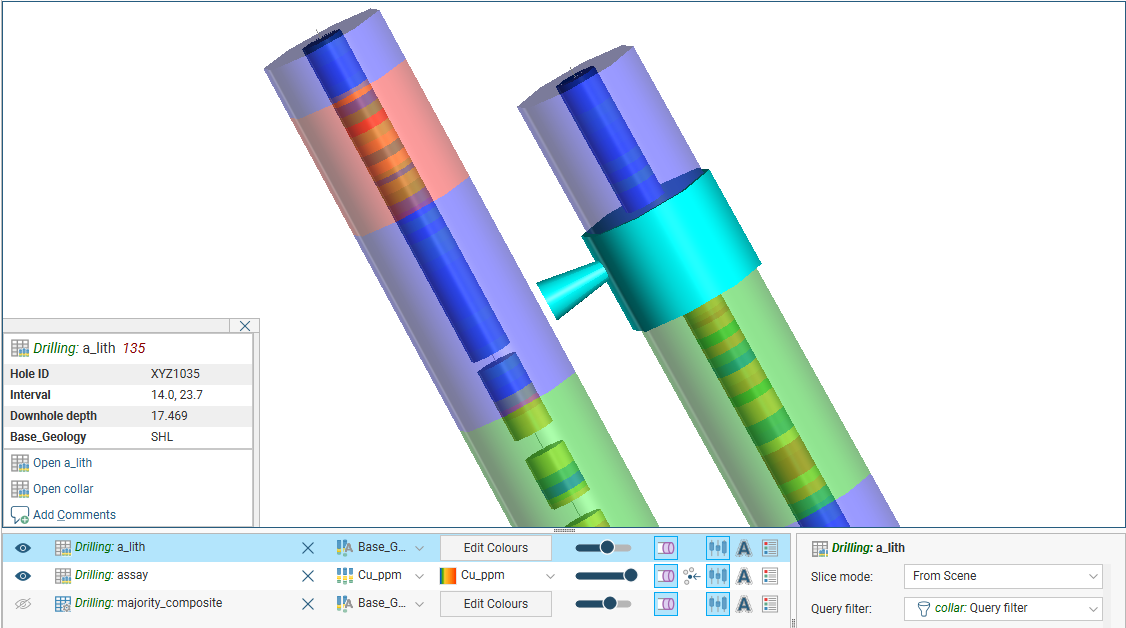

Here assay intervals are shown inside the much longer lithology intervals. The selected interval goes from 14.0 to 23.7 metres:

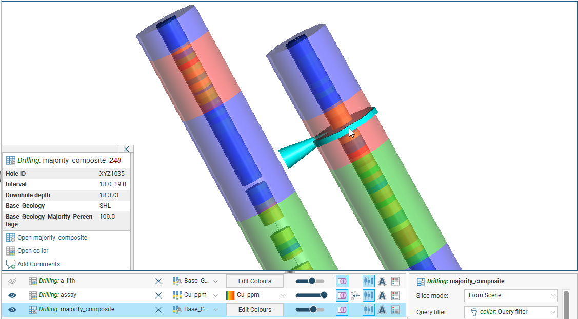

Here a majority composite has been created based on the lithology table using the assay table intervals. The category column displayed in the scene appears similar to the category column used to create it, but selecting an interval in the scene shows that the lithology has been composited into smaller intervals that match the assay intervals:

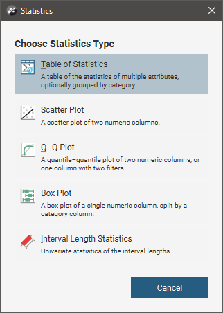

Right-click on the numeric columns and select Statistics to view information about the composited values.
