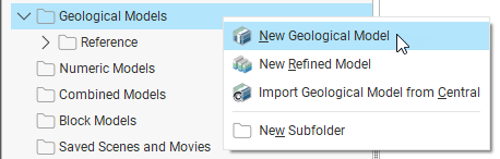

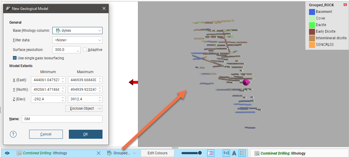

To create a new geological model, right-click on the Geological Models folder and select New Geological Model:
In the rest of this topic, we will use as an example creating a geological model from the Grouped_ROCK column in a combined drilling dataset. Here that column has been added to the scene and viewed from above in order to help in setting the model’s extents:
Once you have set the base lithology, the surfacing options and the model’s extents, enter a name for the model and click OK to create the new model. The new geological model will be created and added to the Geological Models folder.

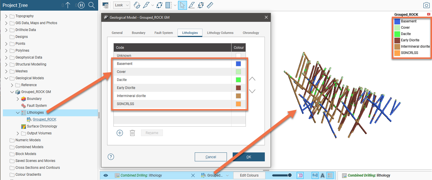

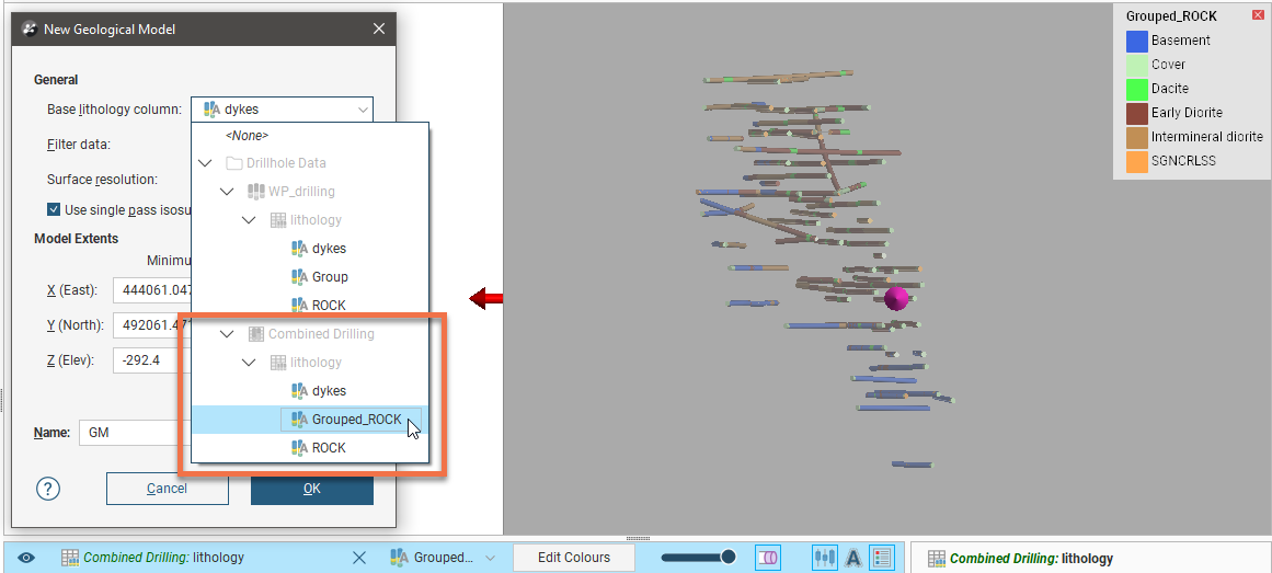

Selecting the Base Lithology
First select the drilling data column that will be used as the basis of a model from the Base lithology column list. If you do not wish to use lithology data as the basis for the model, select <None>. This may be the case if, for example, you want to build a model from points data or from an imported map. If you select <None>, you will need to manually define the lithologies that will be modelled.
Leapfrog Geo automatically selects the first lithology column available in the project, so make sure you select the column you wish to use. Here, the model will be based on the Grouped_ROCK column in the Combined Drilling dataset:
Once the model has been created, you can change the Base lithology column, but it is not a straightforward process, especially once you have started building the model’s surfaces. See Changing a Geological Model’s Base Lithology Column for more information.
You can also filter the drilling data used to build the geological model using any query filters that have been defined for the selected drilling dataset. To do so, select the required query filter from the Filter data list. Once the model has been created, you can remove the filter or select a different one.
The lithology codes from the Base lithology column are used as the geological model’s lithology codes, which you will be able to see once the model has been created. For example, here we can see in the Geological Model window the lithologies used in a newly-created geological model:
The lithology column used as the base lithology column is displayed in the scene, along with its legend. Note that the model’s Lithologies tab shows the same lithologies as the base lithology column, along with the lithology “Unknown”.

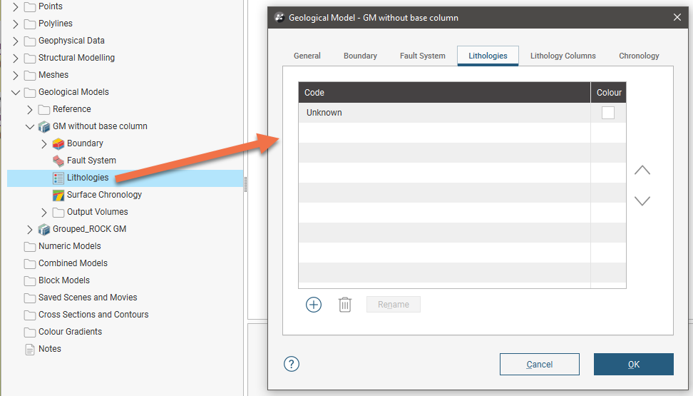

The lithology code Unknown is automatically defined for all geological models. Unknown is used to label lithologies that cannot be assigned to known lithologies, i.e. those derived from lithology data or manually added to the list. When a geological model is first created and no contact surfaces have been defined, the output volume’s lithology cannot be determined and so the Unknown lithology code is used for the output volume. That is the case here, with a new geological model in which no contact surfaces have been defined:
When you create a geological model without assigning a Base lithology column, the only code in the Lithologies list will be Unknown:

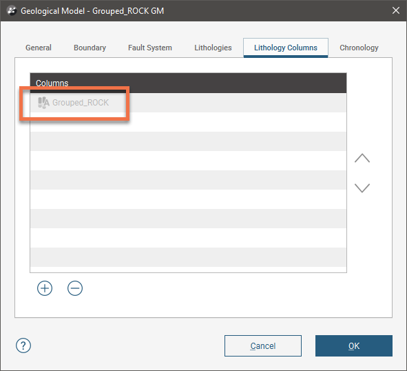

The Geological Model window also has a Lithology Columns tab. This is used to add more lithology codes to the Lithologies list. When a model is created using a Base lithology column, that column will be listed in the Lithology Columns tab, as shown here:
See the Geological Model Lithologies topic to learn more about how the lithology codes in the Lithologies tab are derived, how to use the Lithology Columns tab to add more codes to the list and how the use a background lithology as an alternative to “Unknown”.

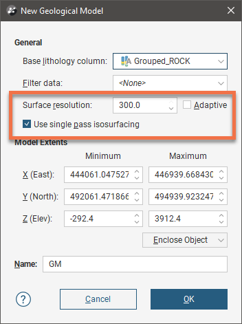

Surface Resolution for a Geological Model
When you create a geological model, the Surface resolution value and Adaptive and Use single pass isosurfacing options set in the New Geological Model window are used for the model as a whole:
The Surface resolution value Leapfrog Geo automatically uses as the default is based on the data available in the project. For more information about these settings, see Surface Resolution in Leapfrog Geo.
When surfaces and boundaries are created as part of the model-building process, their resolution is inherited from the geological model:
- For contact surface other than intrusion contact surfaces and all boundary surfaces, the resolution is the same as the geological model.
- For intrusion contact surfaces, the resolution is half that set for the geological model.
The exception to the above rule is when a mesh is used to generate a contact surface. See Surface Resolution When Using Meshes below for more information.

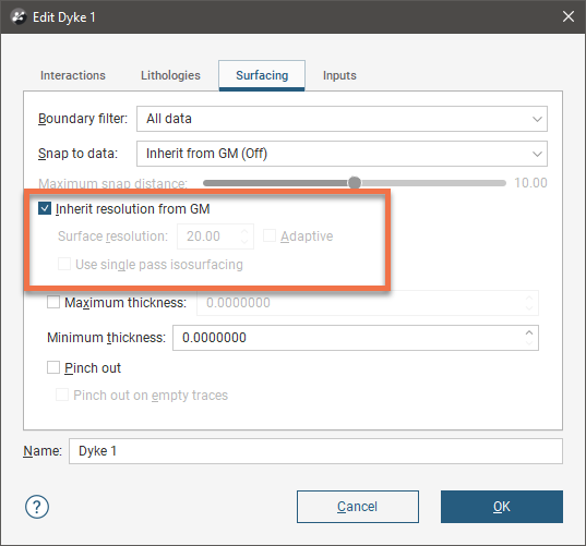

In many cases, you can also set these surfacing options on a surface-by-surface basis, which is useful if you want to build a detailed model of some lithologies without increasing processing time for other volumes. To do this, double-click on the surface in the project tree, then click on the Surfacing tab. Here a vein contact surface has been created with the default setting of inheriting the geological model’s resolution settings:
To use different settings, disable the Inherit resolution from GM option, then change the required settings.
The resolution of intrusion contact surfaces is also affected by the point generation parameters. See Intrusion Point Generation Parameters for more information.

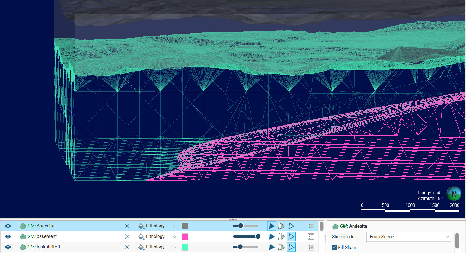

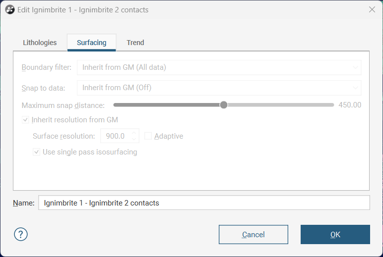

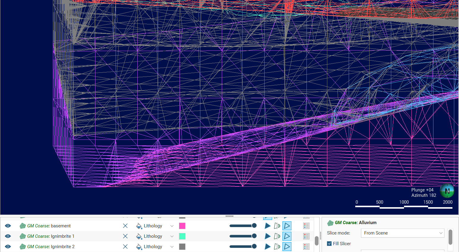

When a mesh is used to define part of a geological model, the resolution of the mesh is preserved rather than being overridden by the geological model's Surface Resolution setting.
For instance, here is a geological model constructed only from drilling data, using Surface Resolution = 900. Note the relatively consistent sizes of the triangles making up the volume meshes:
If a mesh is used to define a contact surface in the geological model, the mesh resolution will define the detail in that surface of the volume where the generated volumes contact that surface, as shown in the following example:
It is not possible to modify the resolution of this surface using a different value to force the surface resolution to match the rest of the geological model. As a result, the Surfacing tab has no editable settings when the contact surface is opened from the Surface Chronology and the displayed settings do not apply to the surface.

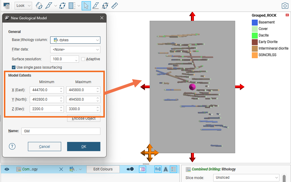

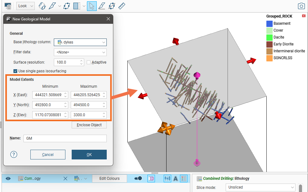

Setting the Geological Model’s Extents
A geological model is initially created with a basic rectangular set of extents aligned with the south/north and east/west axes.
When you are creating a new geological model, controls are shown in the scene that will help you in setting the model’s extents:
You can define the model’s extents in three ways:
- Use the controls in the scene. The orange handle adjusts the location of the corner of the extents box, the red handles adjust the width and depth and the pink handles adjust the height.
- Enter the coordinates in the New Geological Model window.

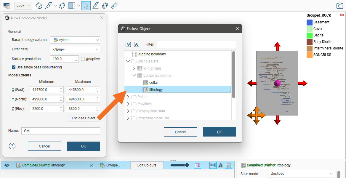

- Select Enclose Object and choose from the list of objects in the project.
If the model is based on drilling data, select the lithology segments from the Enclose Object list, as shown here:
The in-scene controls will be updated to show the extents of the selected object:
See Object Extents in the Boundaries in Leapfrog Geo Projects topic for more information.

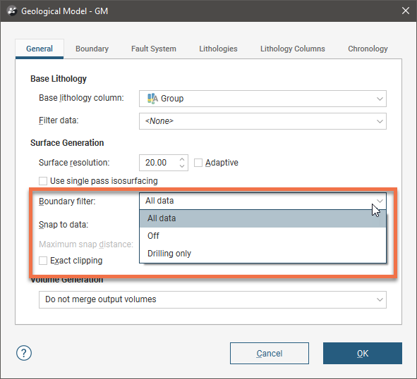

Changing Default Boundary Filtering
When data objects are added to a surface in the geological model, there are two ways to handle the data that lies outside the surface’s boundary:
By default, geological models are created with boundary filtering on for all data used to build the model. This default value can be changed once the model has been created and later, as you build model surfaces, you can also set boundary filtering on a surface-by-surface basis.
To change the default boundary filtering option for a geological model as a whole, double-click on the model in the project tree. The default Boundary filter setting is in the General tab:
Options are:
- Off. Data is not filtered.

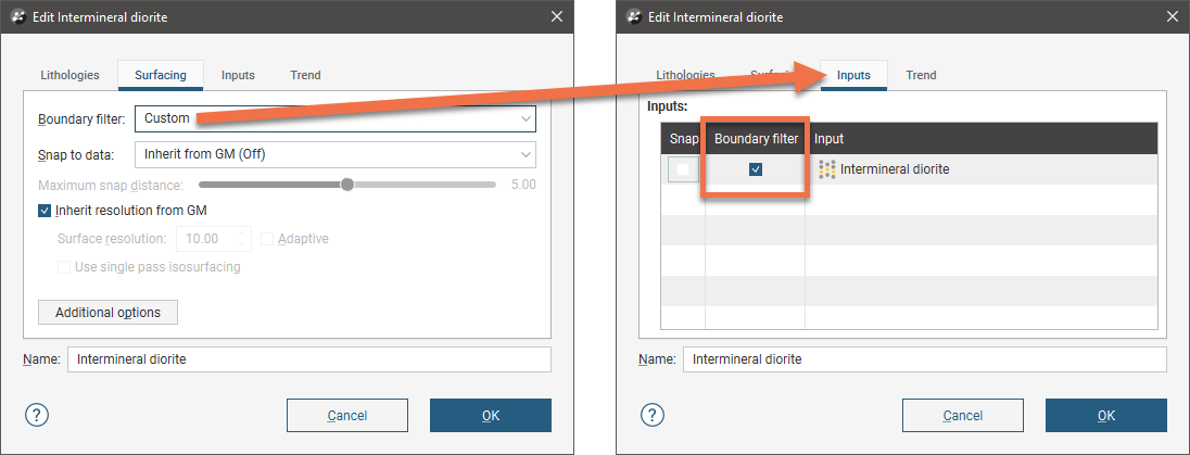

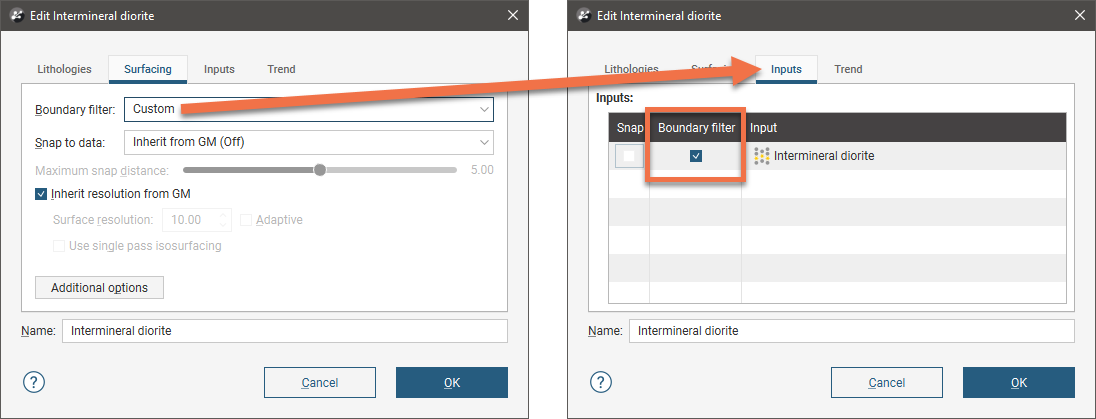

To change boundary filtering for individual surfaces, double-click on the surface in the project tree, then click on the Surfacing tab. Options For Boundary filtering are:
When you choose Custom for individual surfaces, you can select which data to filter from the surface’s Inputs tab.

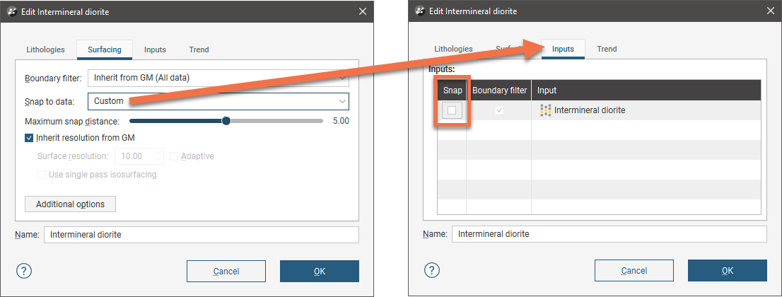

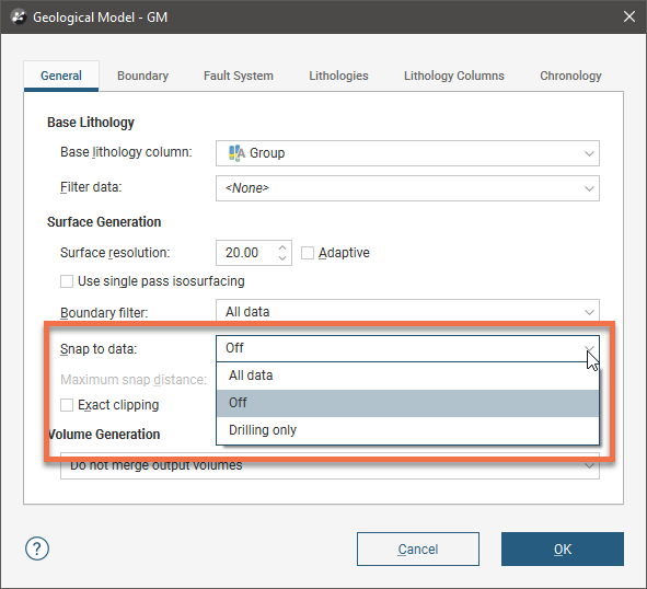

Changing Default Snapping Behaviour
Often, surfaces should honour drilling data and treat data objects such as polylines and GIS data as interpretations, as discussed in Honouring Surface Contacts in the Modifying Surfaces topic.
By default, geological models are created with snapping off for all data used to build the model. This default value can be changed once the model has been created and later, as you build model surfaces, you can also set snapping behaviour on a surface-by-surface basis.
To change the default snapping behaviour for a geological model as a whole, double-click on the model in the project tree. The default Snap to data setting is in the General tab:
Options are:
To change snapping behaviour for individual surfaces, double-click on the surface in the project tree, then click on the Surfacing tab. Options for Snap to data are:

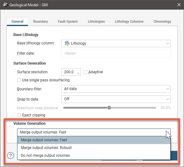

Changing Output Volume Generation
The Volume Generation setting determines whether or not output volumes of the same lithology are merged when the volumes are exported.
If this is set to Merge output volumes: Fast or Merge output volumes: Robust, internal walls and surface seams will be removed from volumes of the same lithology. The difference between Fast and Robust is the algorithm used:
- Fast removes back-to-back triangles before generating output volumes. Fast uses a fast algorithm to identify identical coplanar triangles in each mesh so these can be excluded from the intersection computation, avoiding the large number of triangle interactions that slows CSG down. Fast does not have to maintain surface tracking information and avoids associated overheads and limitations, and instead uses available processing capacity to work around problems. For instance, when a mesh hits a CSG error it can retry the CSG after doing mesh simplification at the error location in the input mesh to remove thin triangles that caused the problem. This improves its ability to cope with mesh interactions that have tricky triangle geometry.
- Robust uses the volume cutter, which tracks where the triangles originated and is, therefore, a slow option for building output volumes. This can be useful when using CSG to join volumes with coplanar surfaces, but there may be additional issues that result.
Fast should be the preferred option, though either is suitable when you are using output volumes as extents for other models.
If there are issues with surfaces exported to other packages and the volumes have been generated using the Do not merge output volumes setting, try the Fast setting as the preferred option. If there are still issues, try the Robust setting.
